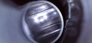

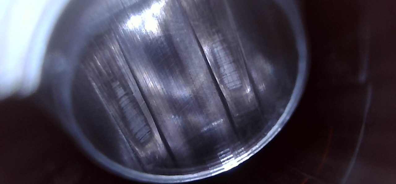

I just got a new barrel from PVA....after 40 rounds I borescoped it.
I noticed machine marks on the lands after the throat. Any thoughts?

Accuracy has been about 1inch+ at 100 with 140american gunner, 3/4 with 140eldmatch. Nothing to write home about. I don't know how much it's me or the barrel so I'm about to try working up some loads and try again tomorrow ... I expected better but too early to tell
Only weird thing about that throat is why the entire leade doesn’t look that way.
Edit: Also looks like you spun something in the throat? Abrasive?
Nope...just used a standard nylon brush and brass jags with patches per break in instructions.... Even a brass brush or jb bore paste wouldn't cut into steel like that.
Jb absolutely would create a finish in the steel. No matter though. I think your barrel is fine.

So what’s your expert opinion on the OP’s pics?

That barrel looks top-tier compared to some of the factory shit I've seen... And that factory shit would still shoot lights-out.
Also, I wouldn't judge the rifle's accuracy capabilities with factory ammo... JMHO.

Yes, those machining marks and the very minor tool chatter in the barrel are normal. You've already managed sub-moa at 100 with factory match, so the accuracy is already there. Go shoot it.
