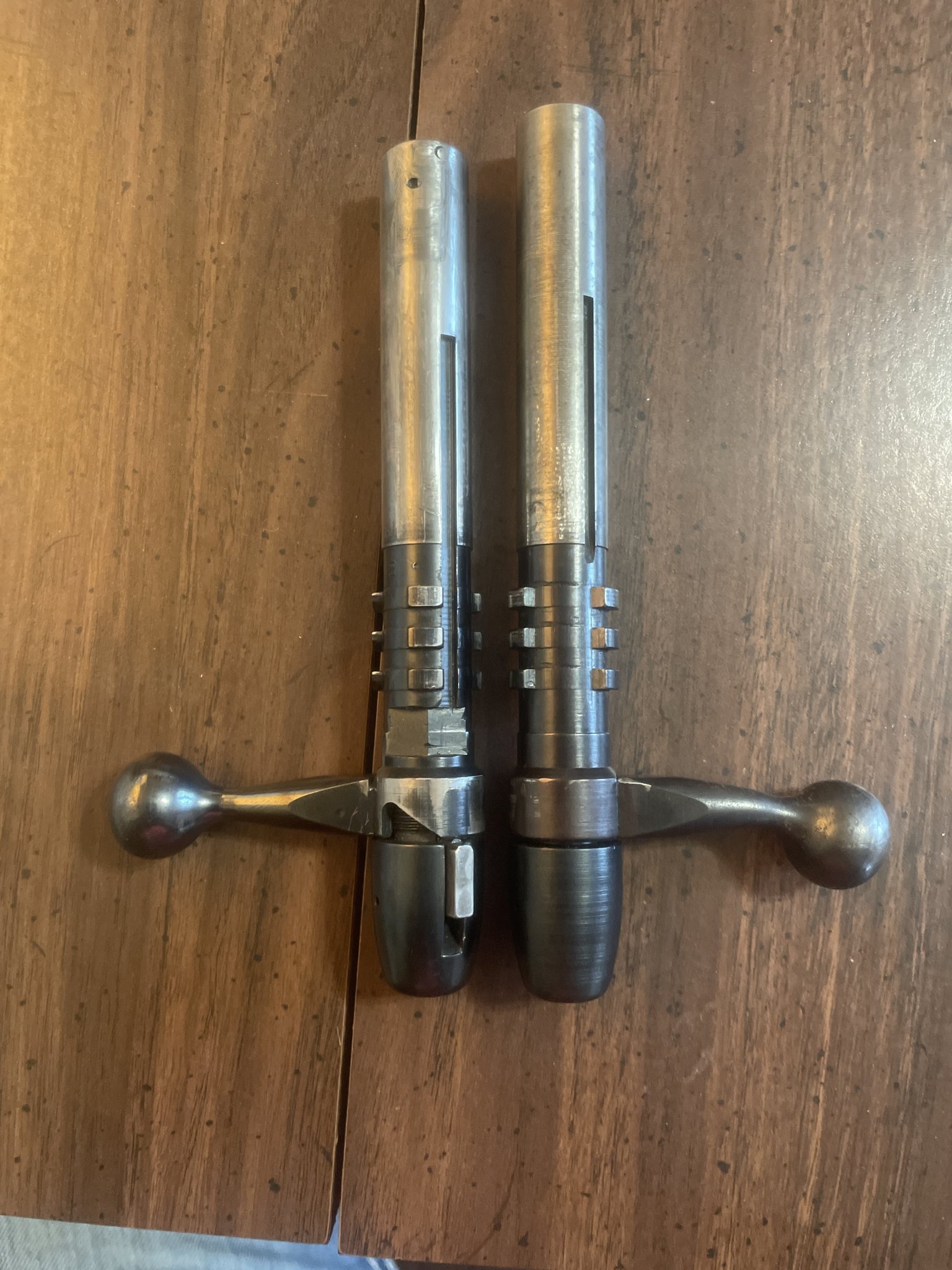

There is a .308 parts kit with a bolt on gunbroker. Bolt should be the same. Give me a minute I’ll go check.
I lied
I have one....... its attached to a new in the box 788 in 22-250 and not for sell. I own every single model ever made. Best production rifle ever. I love those things. Good luck.......

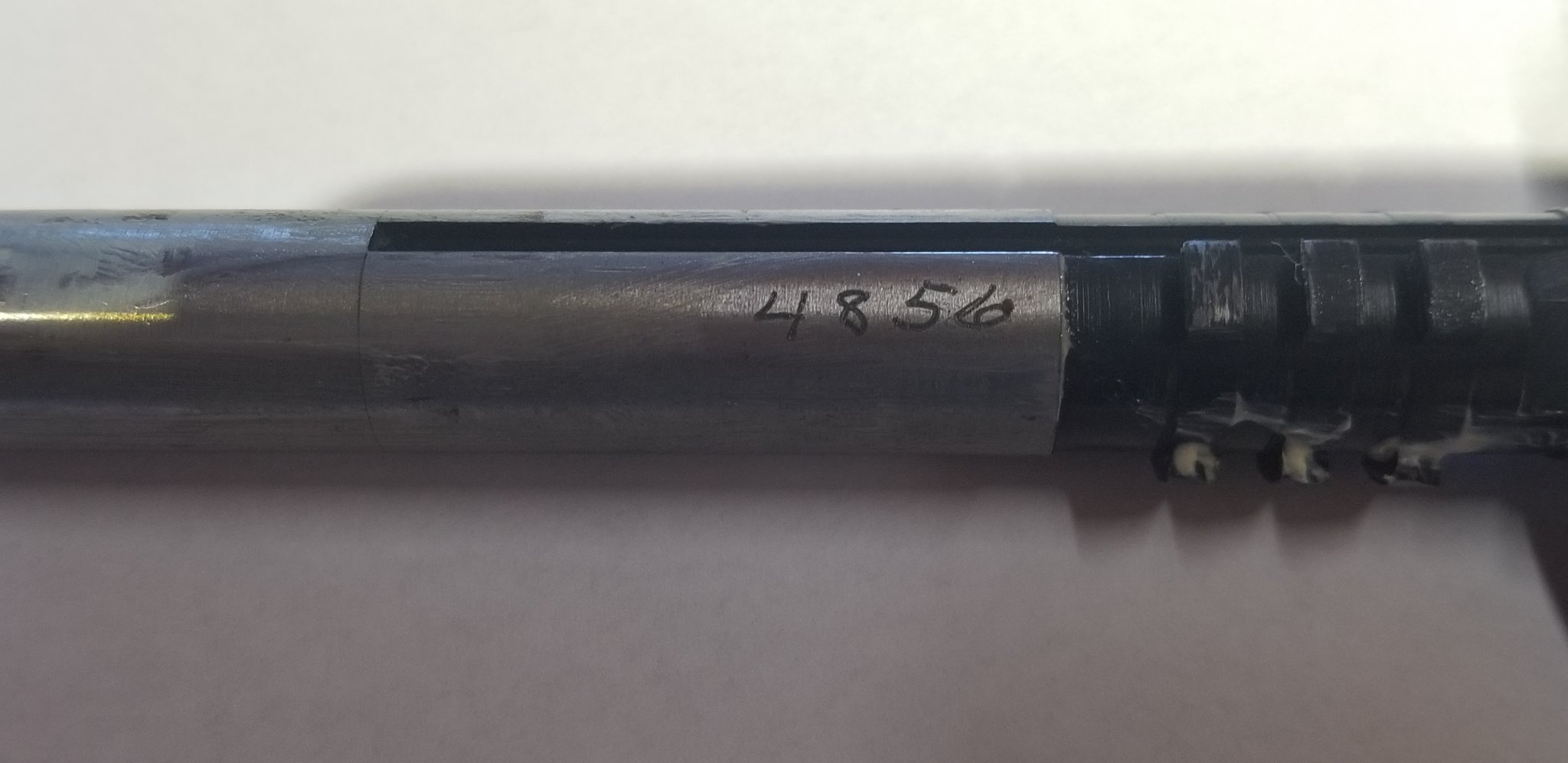

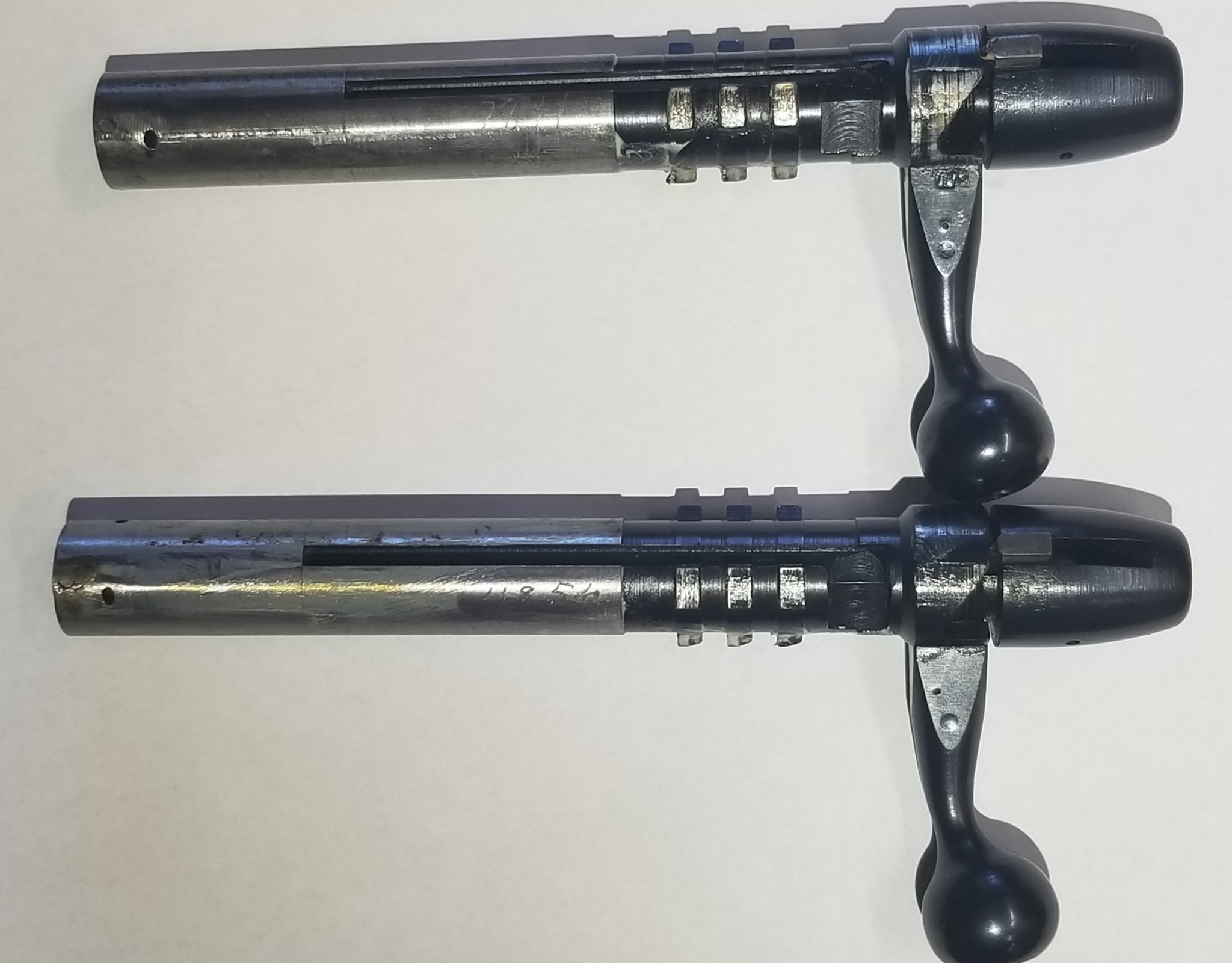

The 22-250 and 308 take different bolts.
The pic here shows the 308 as slightly longer.
There is also a pic of the last 4 of the serial number hand engraved on the bolt.
When buying a 788, I look at the round part of the bolt, at the base, and the locking lugs for wear. I also look for the serial numbers to match. And the underside of the bolt knob to see if someone has been beating on it.
