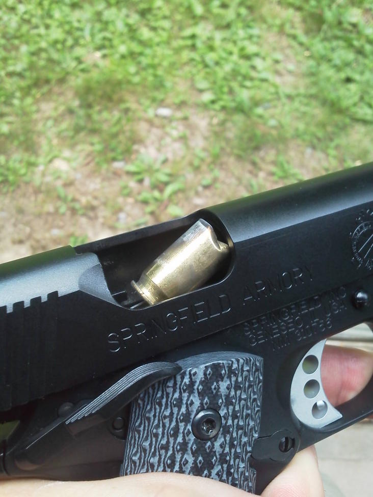

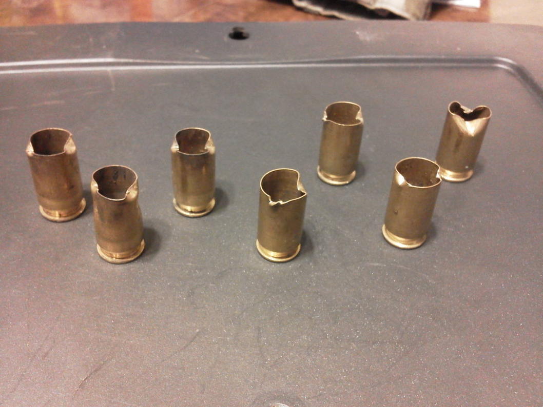

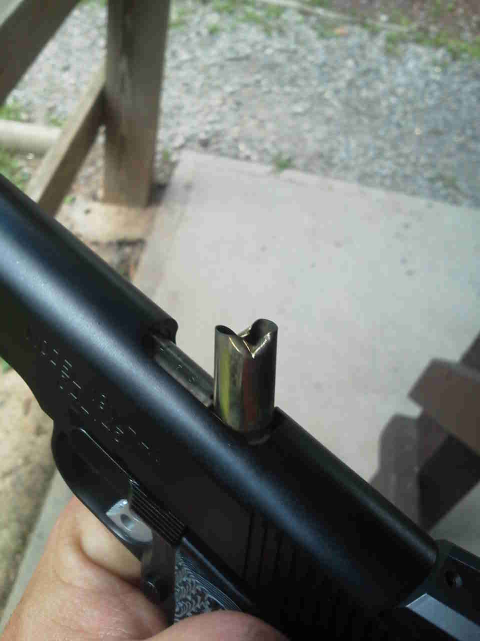

i bought this about a week ago. i put 200 rounds thru it after i cleaned it up before the range trip. ammo was remington UMC, sellier and bellot, blazer brass.
this only happened on the last round, with all the mags, with all of the ammo.
i had the 2 mags that came with the gun, and my 2 remington R1 mags. i tried the ammo and mags in my R1 with out failure. if the round didn't get hung up like in the pics, then it would just kinda flop out of the chamber. the spent case definitely did not go flying like the other rounds.
any thoughts?
the 1st pic is obvious
the 2nd pic you can see where the mag was actually marring the rim. the spent case was actually getting stuck in the mag along with being smashed in the slide.
the 3rd and 4th are obvious as well.

Dented brass is about timing and ejection. Basically the slide and/or barrel is catching the brass as it ejects. Sometimes a different spring weight can change the slide speed but most likely you need to change the ejection angle so the brass makes it out without hitting the back of the slide. Extractor tension can help but, most likely, the face of the ejector needs to be tuned to get the right angle when the brass rotates out. I'd look for copper marks on the inside of the ejection port to see where it's impacting. If it's hitting the bottom of the port then you need the brass to take a more upward angle. If the brass is hitting the barrel hood then it needs to come down. I'd verify proper extractor tension first though to make sure the hook isn't loosing the brass wen it extracts.

It's only occurring with the last round of each mag. Have you experienced this with all mags you own?
I'd say you need to increase the extractor tension. When a magazine has a round on top, the extracted case is running on top of that fresh cartridge. When the magazine is empty, the extracted case is falling down into the feed lips. The mouth of the case is rotating up enough to catch the forward edge of the ejection port.

^ ^ ^ ShtrRdy nailed it - extractor tension, and why on last round - no support. ^ ^ ^
This failure is not a magazine problem, hence all mags function in other gun(s).
This is one of several reliability tests (load 1 round in magazine, chamber, fire) for 1911s.
A excessively loose extractor is not good either. Loose is OK but if it clocks / rotates Springfield will fit a replacement firing pin stop. I agree with the above post that it sounds like an extractor tension adjustment. My TRP also has a loose fitting extractor but no rotation.
i was originally thinking the mags were seating too high, the mag was actually grabbing the spent case on it's way out because of what shtrrdy said. no round for support to keep the spent case above the mag. just goes to show how much i know about hand guns!
