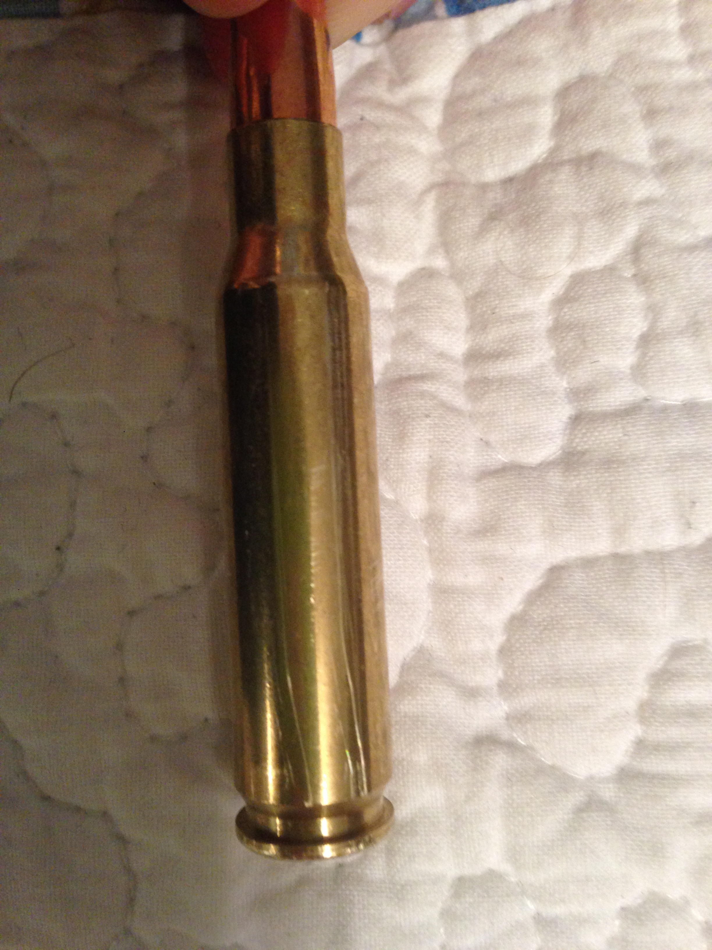

So I have a brand new never fired rem700 AAC-SD .308 s/a 20". I sent the bolt out to have pcr install one of their knobs and it looks amazing. So tonight I decided I wanted to load the mag and just cycle the rifle to see how everything felt, mind you not firing the rifle. Only chambering and ejecting a few rounds to make sure everything was working smoothly...it's not. The gun is new. Not a single shot has been put down it since It was purchased. Here are the issues. Rounds go perfectly into the box mag. Now when you try to chamber a round quickly it feels almost as if the round is getting hung up on something But if u do it slowly. They chamber fine. Ok all is good. Now they eject good and all. Not super strong. But what you would expect from a stock remington. Now checking out the round after ejection. I notice two gouges the length if the case. Same spot on all rounds. Now I'm not some well versed rifleman but this doesn't seem right. Anyone have any ideas on what's going on?

The gouges are likely from the bolt passing over next round in the magazine,scratching the case as the bolt goes by. Resistance caused by the "gunk" will exacerbate this.

here one case
I used a fine 900 grit stone and addressed the ramp that is machined in the action. As the casing is fed up into the chamber it slides across and along these sharp edges left from the machining process. I would estimate I polished a .010" radius to this edge and it solved the same problem you just posted. Take little steps since you can always remove more if needed. Hope this helps.

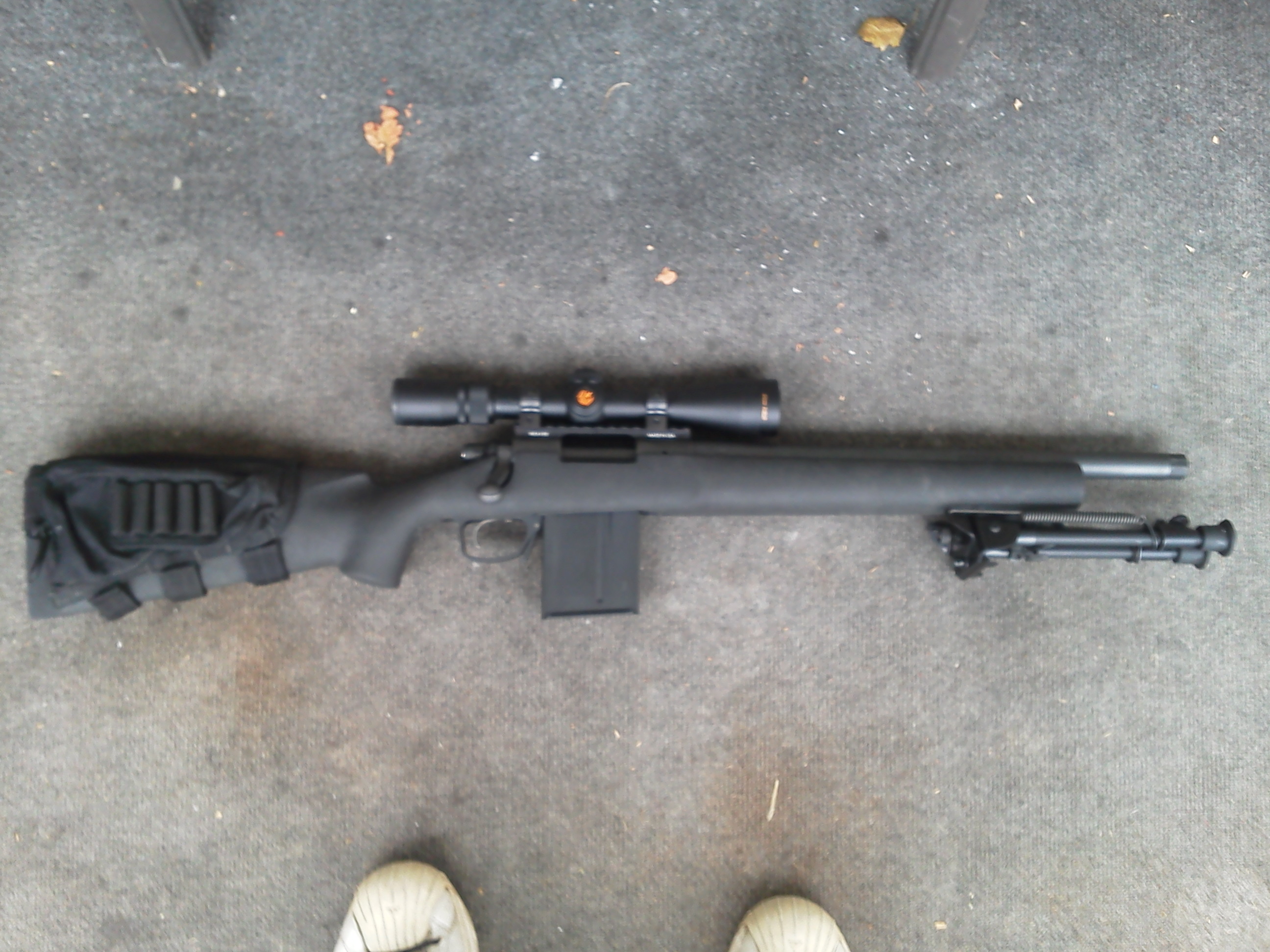

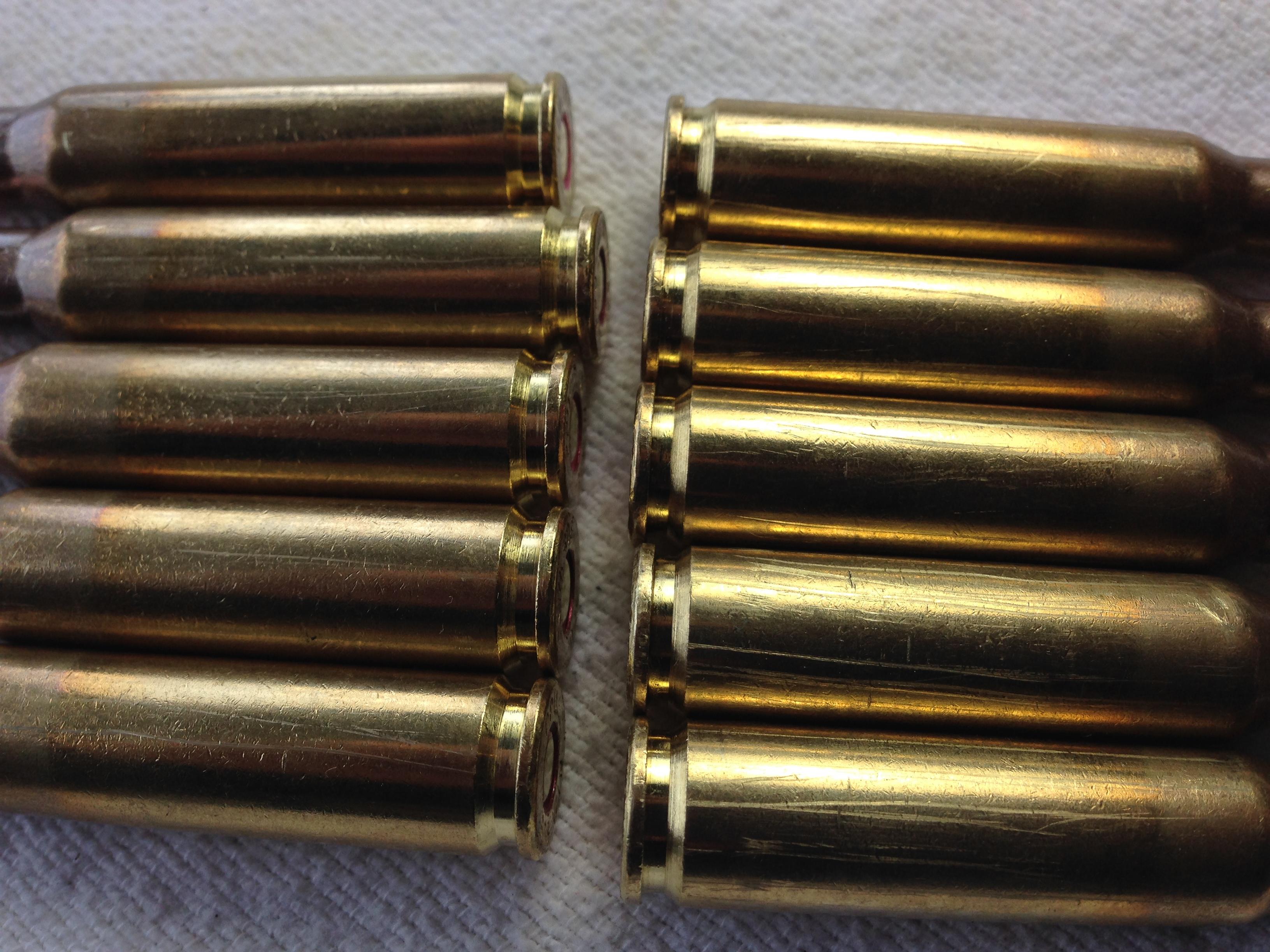

I decided to re-check mine after I cleaned the sharp edges the first time. I was still getting some marks as you can see in the picture of the cases to the right. These were just run after the first light polish and was much better than to initial scratches with 381 rounds down the tube. I pulled the action off and took a little more off the edges of the feed ramp. Ran 5 rounds through (loaded in the internal magazine) and the cases to the left are the result. I also noticed the action is much smoother when chambering the rounds.
You're almost there. Removing the sharp edges and machining burr's will definitely make the "feed" feel better.
Unless you're buying a high end factory rifle or a Custom, almost all "out of the box" rifles need a little "Fluff and Buff".
It's amazing how much you can change the personality of a rifle with the application of some 1500-2000 grit wet/dry sandpaper on sharp edges and some "Flitz" on surfaces that are supposed to be smooth.
Most rifles will eventually wear down these edges, hence the term "Break-In". I prefer to just take some extra time "smoothing and polishing".
thanks for the follow up, that definitely helps with my situation, the rounds on the right in your picture are how mine look right now, ill definitely have to take a look at all my surfaces
