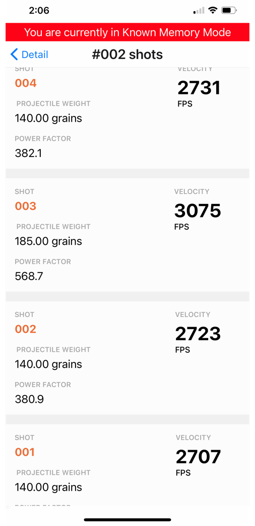

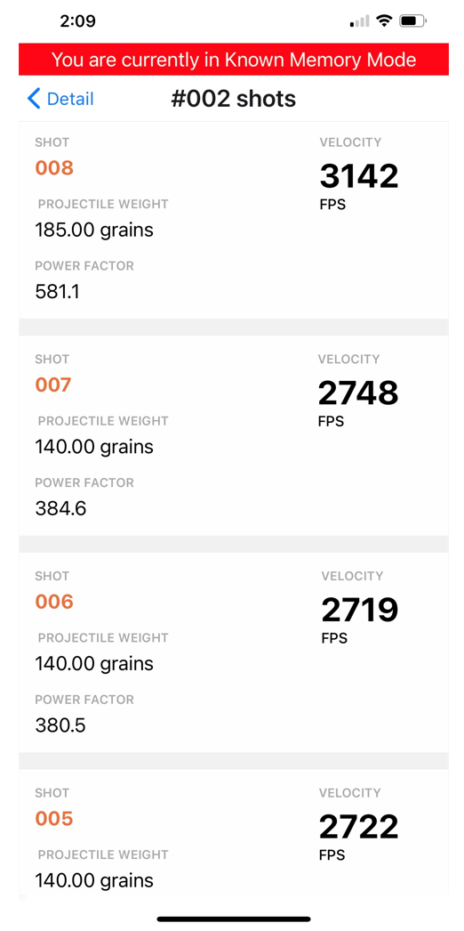

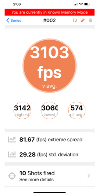

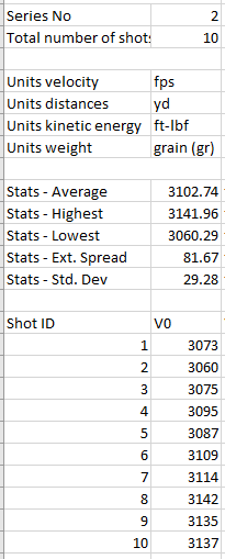

    Still seeing this bug where after you've deleted prior series', "ghosts" of the old shot detail linger in the App and embed randomly in new shot series. The weird part is that it's correct on the SD Card, but wrong on the app. Here's an example ... (below)
    Provided for informational purposes only ... not to whine ... but so that you're aware you might see this. I've informed Labradar Tech Support that this software bug persists and occurs randomly ... for me about 25% of the time. The only way I've found to completely clear this problem when it happens, is to delete and reload the iPhone App. Clearing the SD Card DOES NOT solve this problem. Refreshing the download to the App DOES NOT solve this problem. The issue is how the App incorrectly stores and deletes (or doesn't delete) old data, not how the Labradar stores data. All data on the SD Card is righteous, so that's what you should use until this is fixed by Labradar.
    Hope this helps. Knowledge is Power.
    Data on the SD Card for a 300-WM ladder test I did this morning ... that is correct (all velocities between 3050 and 3150):
    Data from app showing a variety of speeds in the 2700's (from a prior 6.5-CM session that was deleted) ... interspersed with correct 300-WM speeds (totals are correct but detail is obviously "mixed"):
