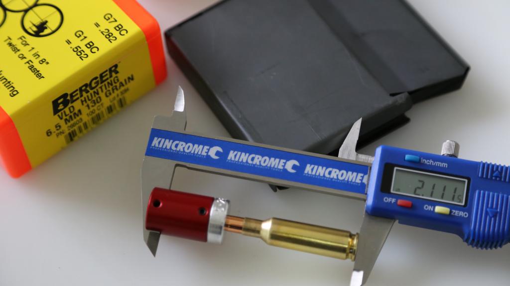

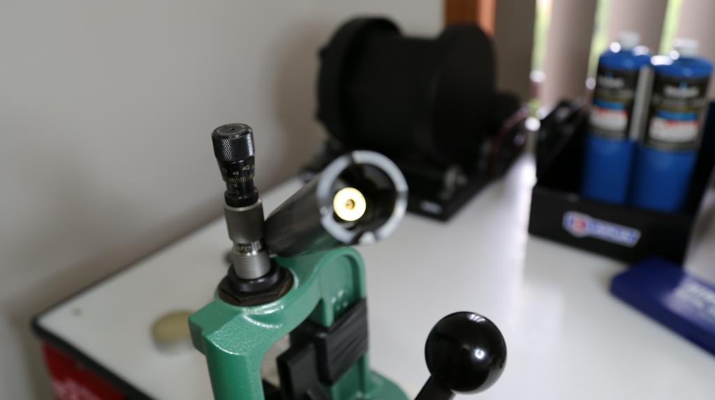

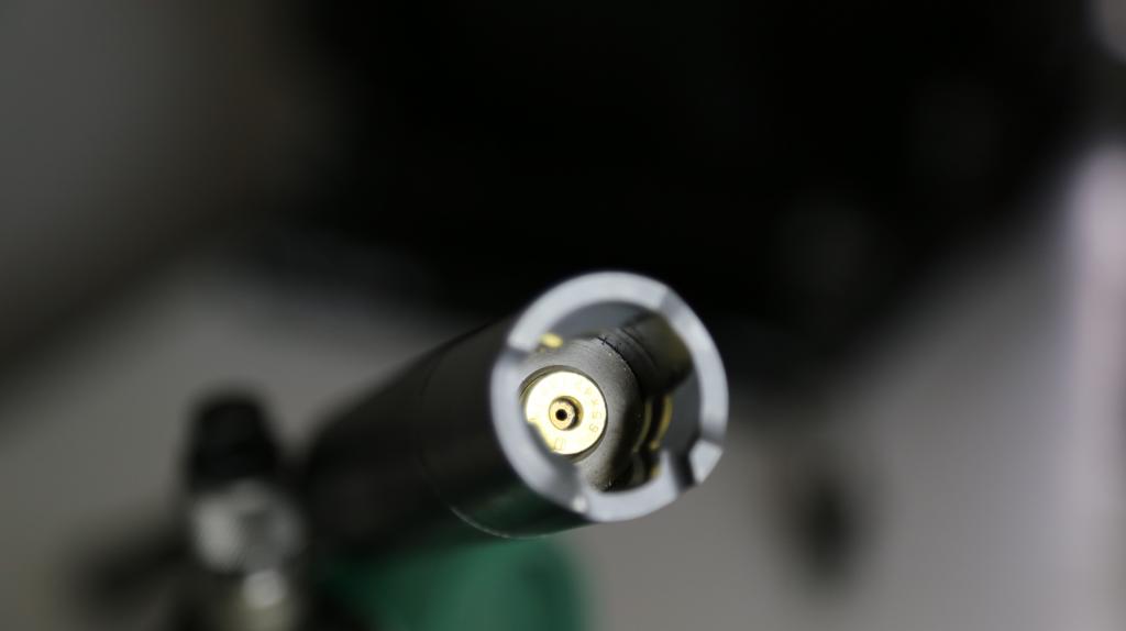

Once a case is sized and chambered without a seated projectile there is no issue, bolt closes up nice and easy, they way it should be. Once a projectile has been seated i cannot chamber it at all. I have tried bumping the seating die down to the point where the ogive is almost in the neck of the case...same thing, wont chamber. I have adjusted my fl size and bumped that down further...same thing.

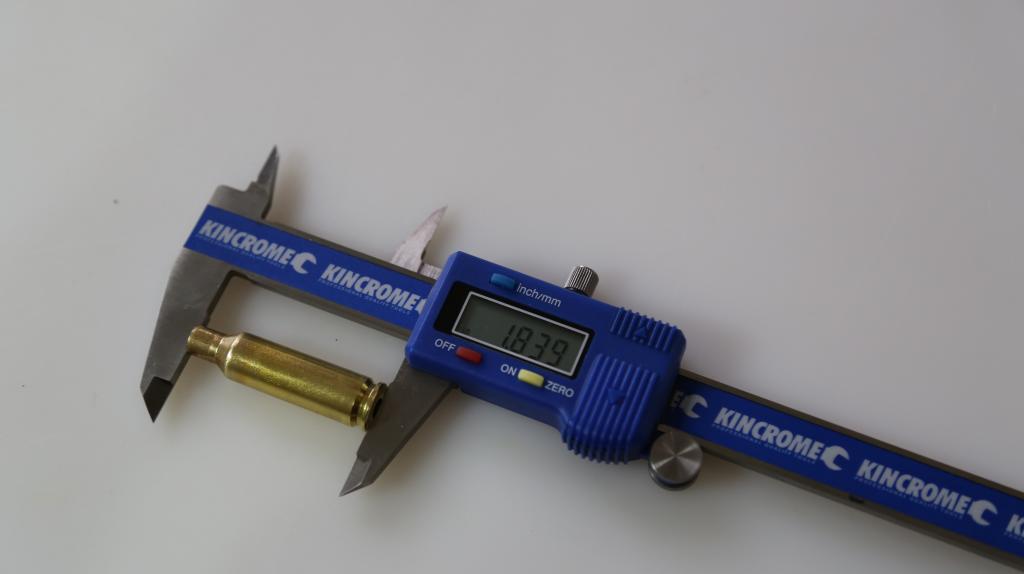

MINIMUM CASE LENGTH
AFTER FL SIZING SHE SITS IN THERE JUST FINE

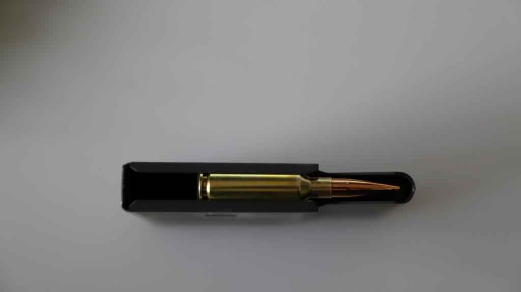

AFTER SEATING SHE SITS PROUD....hard to tell by the photos but its approximately 0.163" higher than the non-seated case

Some of the 6.5x47 FL sizing dies are not deep enough to fully resize the case near the head (lower part of case) causing chambering issues. Because of this issue, about every 3-4 firings, I use a spare 308 FL die but remove the top cap completely along with the depriming rod and expander button. It's long enough to reform the lower part of the case, but won't touch the shoulders of 6.5x47 case. Give one case a try, and see if it resolves your chambering issue.
