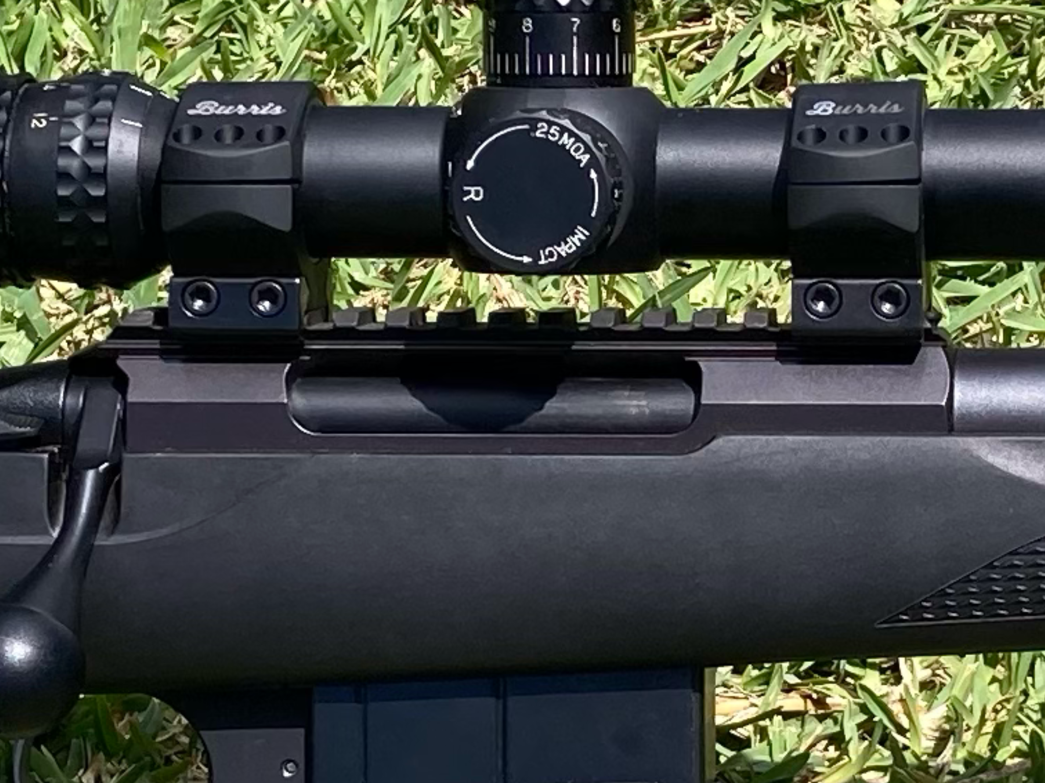

It makes no sense, Why do Tikka TAC A1 rifles come with 0 moa scope bases.
My TAC A1 in 6.5 Creedmoor can reach out to a mile plus. But not with the stock 0 MOA base. My scope has 32 mils of adjustment, (less than some, more than most) or really about 14,4 mils of usable adjustments gravity being what it is and all. That takes my rifle out to about 1200 yards. If I use all of my holdover maybe 1700 yards. Past that it's pure guessing..... So why doesn't Tikka put a 30 MOA rail on this gun from the factory?. Its not like they didn't charge me enough money.
Most decent scopes 30mm+ tube withoutcrazy high magnification range, around 40MOA-50MOA between rail and mount gives you decent image at zero distance and dial to subsonic range on pretty much anything inside long action.

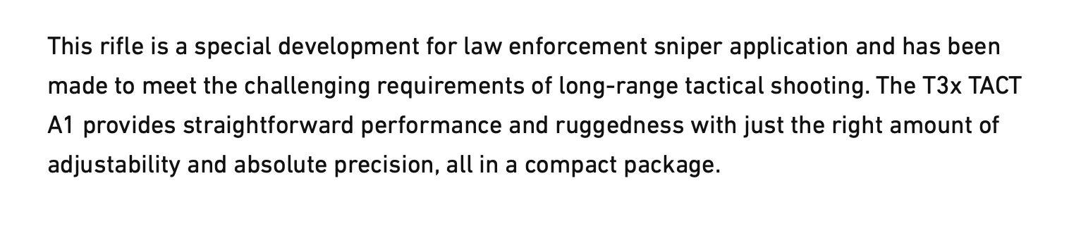

Because it's a rifle built for LE and none of the cartridges it is offered in are designed to shoot much more than 1200 except by people who want to push the cartridges past their design limits.

LE only ? Wrong.
Swing and a miss as usual.......on the bright side, you're getting extremely good at being wrong.
Obviously anyone can buy it and use it. But the purpose behind the development is the purpose it's built for and why it has those features.

Surely centering the scope elevation inside the supersonic range is still desirable? 20MOA base will be closest to centre of elevation for most ring/mount combinations on such a rifle. The only reaI reason I can think you would intentionally not run at least 20MOA on a modern action is using a stock without adjustable cheek riser.
There are only a dozen outfits making 20 MOA rails for a T3x. Buy one and put it on...easy, right?
Not as many options for an a1 to match the height of the forend. It's taller.
OP you can get scope mounts with the cant in. American rifle company mbrace are nice. Haven't gotten one myself yet though.
Or get one of these.
https://egwguns.com/hd-tikka-t3x-tac-a1-picatinny-rail-20-moa currently out of stock though
https://egwguns.com/hd-tikka-t3x-tac-a1-picatinny-rail-30-moa in stock
