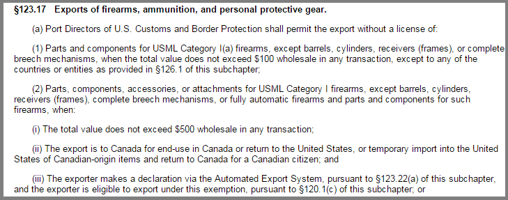

1st: The above mention in regards to chassis/stocks NOT needing an export permit is completely wrong. Category 1, subsection H dictates and controls parts such as stocks, etc and is an export license controlled item.
Scope mounts are also controlled by same subsection. Honestly this subsection is viewed as a "catch all" for small and misc parts.
2nd: In regards to reloading equipment it is completely dependent on what the exact product(s) are.
3rd. There are also some "small part" exemptions. Details about the exemption found in 22 CFR 123.17(A)
