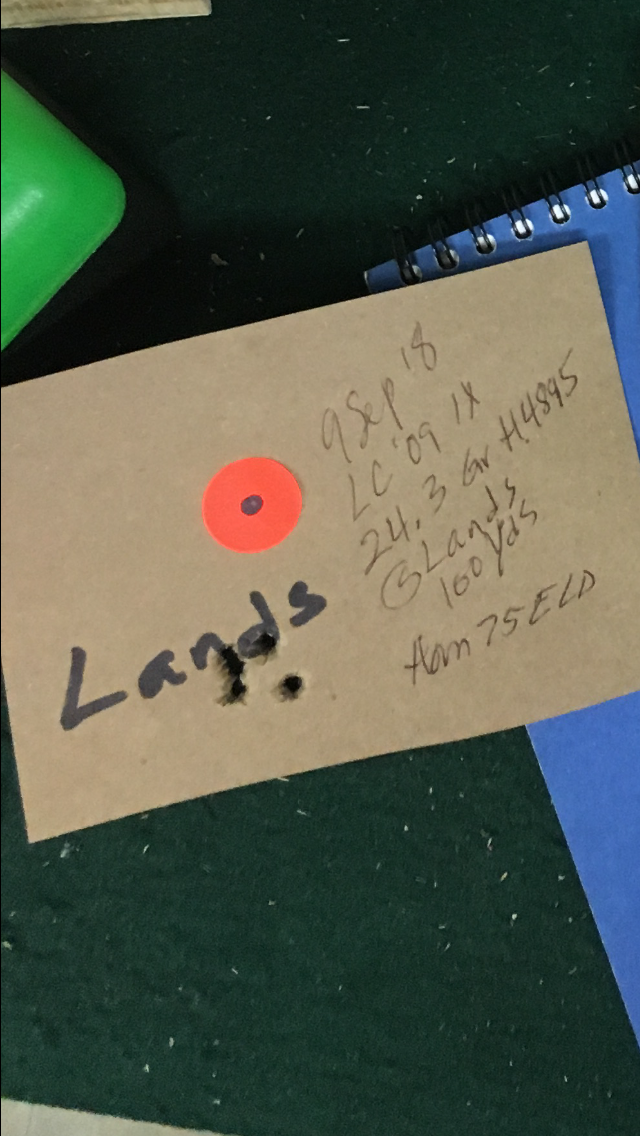

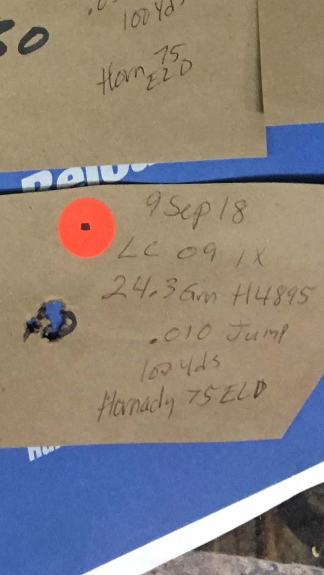

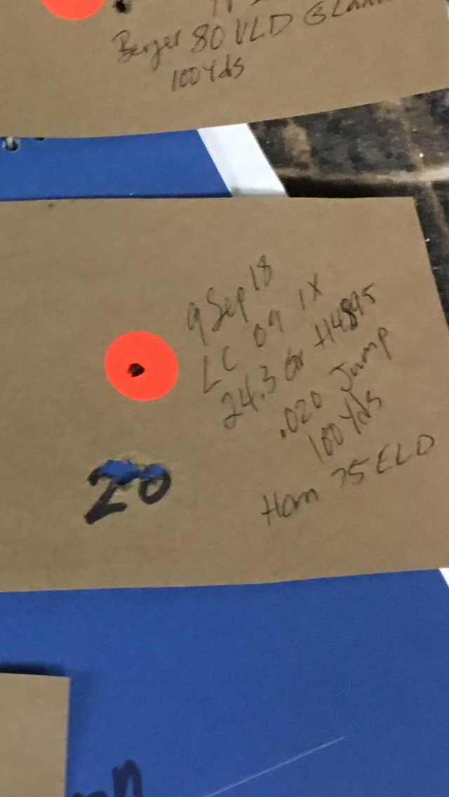

C8BA2922-6A15-4664-BEA6-C8FC1DE992BC.png0A08E75B-C132-406B-A9FB-1EEA6A392669.png834F5F95-F4C5-4F99-B6E5-B245A2FA1D64.png8F007E3E-C62C-4CF9-B037-A95E36B961BE.pngIt’s ok to jump. I went to .050 on this test. .04-.05 didn’t make it in the folder, but looked like.06 would have matched .030.
