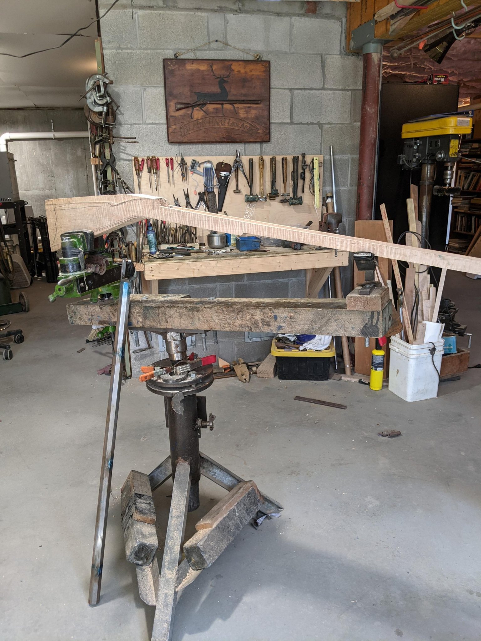

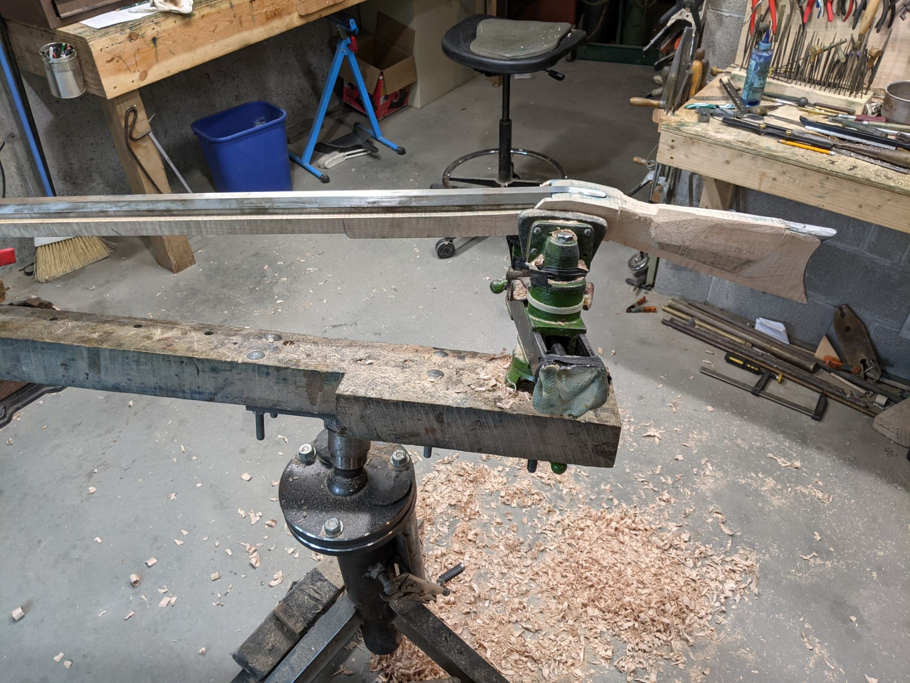

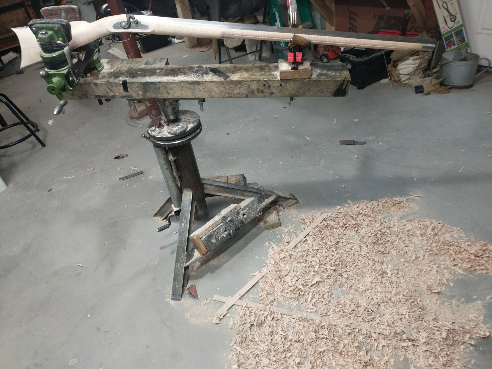

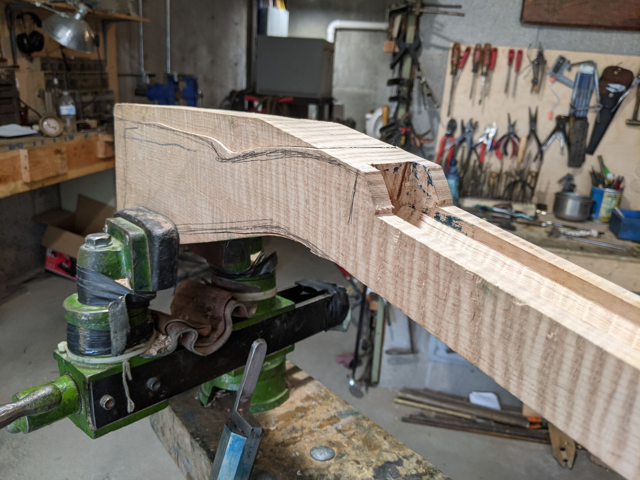

    Was going to put this in Vintage, but since Sean started this fine thread… I’ll post here.
    Project that had been ‘in the works’ for about three years has started as of last week…
    Took a while to accumulate the necessaries and get in a good barrel.
    There have been a number of debates about Hinsons projectile and, no, his mold has not been found that I am awaren of. The book describes it as a minie and not as a Whitworth pattern hexagonal bolt. And having had his rifle made locally, I suspect it very unlikely that they used a Whitworth barrel. The Marine Col who wrote the book is a “gun guy” and did extensive research including examining the actual rifle. So the book is, so far, about as definitive a record as I have come across so far.
    Been Hinson’s stomping ground, which is right around Fort Campbell. But not his grotto. Now the “Land between the Rivers” is the “Land between the Lakes”. So much of the real topography is lost to the TVA. Might try and get to his cave on a trip there this fall. Make an interesting get-together if anyone is in the area.
    There is a monument, btw. I’ll dig out the picture we took there.
    In the mean time… These kinds of build pictures will have to suffice until a range report comes in.
    Cheers, Sirhr

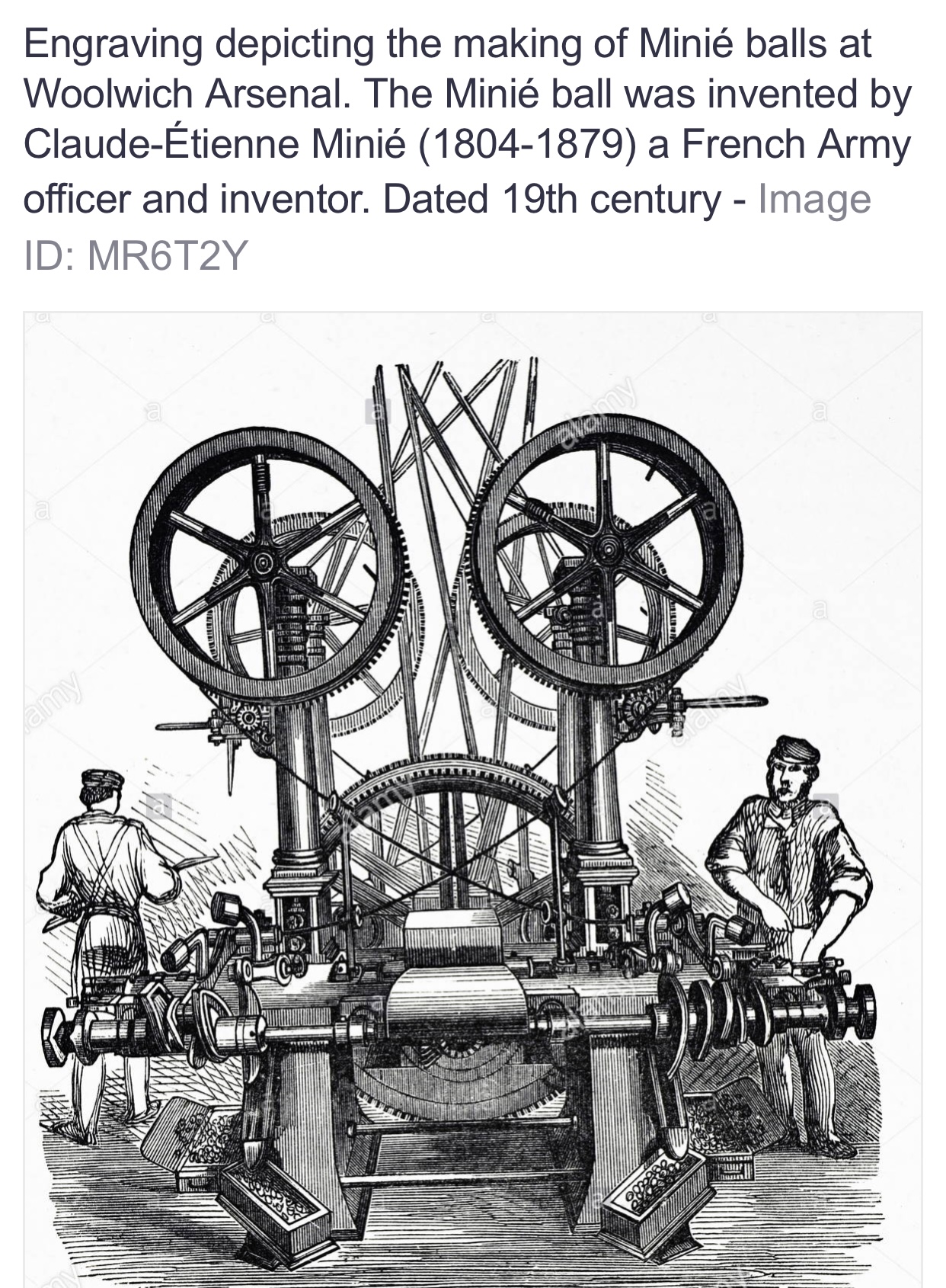

    Hinson is supposed to have used a form of minie, which had a hollow base to expand into the rifling. And a minie-type mold with a base plug as part of it. But… this remains conjecture.

    As I start to research bullet designs, I came across this interesting reference in an arcane bullet/cartridge reference from the 1990s.
    note the elongated shape and relatively small bore of the “Tennessee” style of Minie.

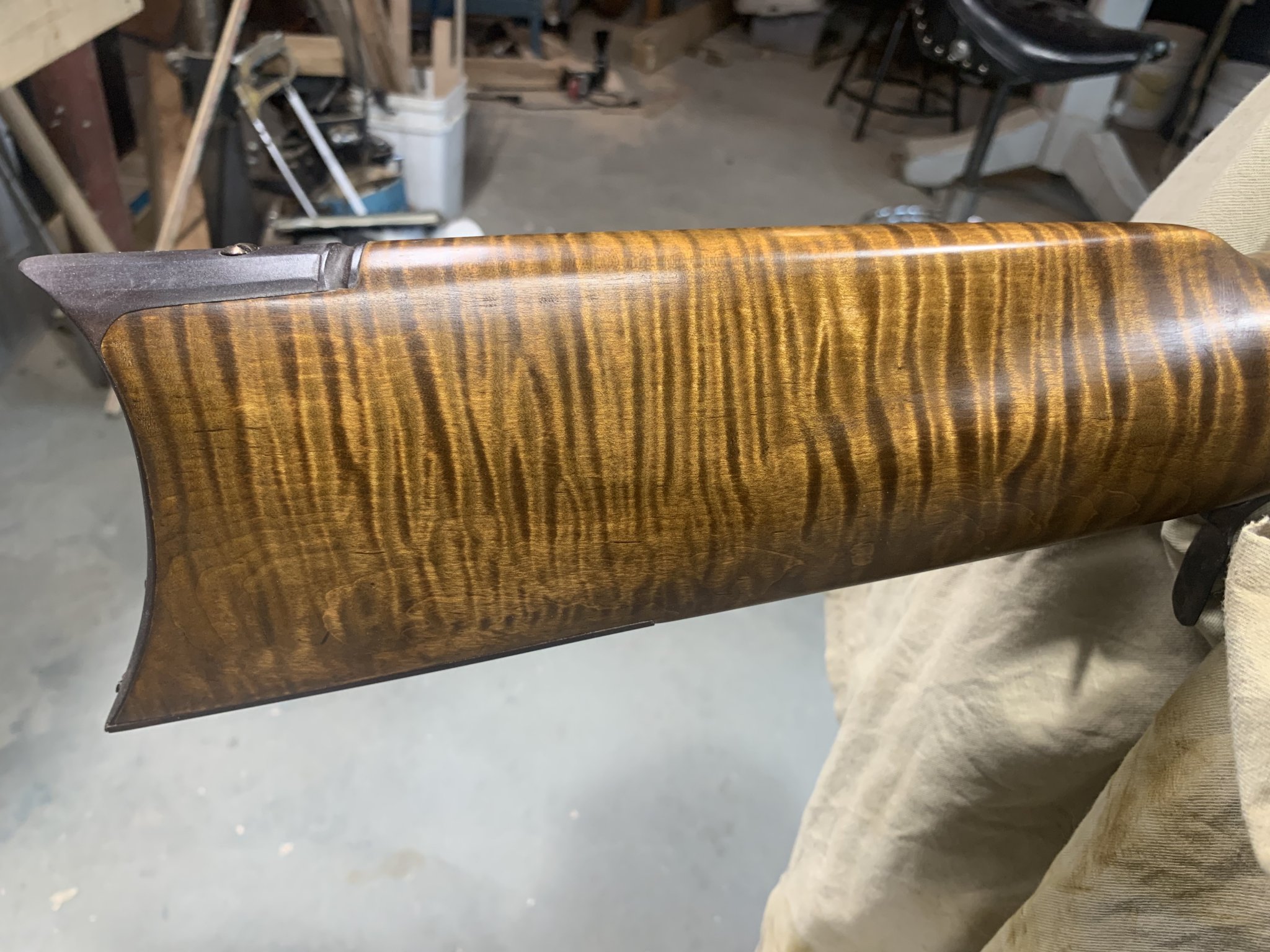

    The fiddle in that stock looks beautiful completely dry. It’s going to be amazing.
    Ed told me it is one of the most beautiful pieces of wood he has worked with. Spent a 'long' time trying to find a piece thick enough to accommodate the barrel!
    I pick up tomorrow. Going to be a long day!
    Sirhr
    Sirhr
    What’s you plan for finishing the wood? Going to try period correct, modern chemicals or a combo?
    Please don't do the burnt in tiger stripes some tards do.
    What else are you supposed to do with the Walmart wood burner? I think a krylon job would be the best choice here!
    The aqua fortis reagent darkens the maple and highlights the grain very nicely. Gives maple a beautiful brownish red that is very hard to replicate with dyes or stains. Very traditional coloring as well.
    Aqua Fortis is legit.

    Can’t wait to see pics of this. Was this a personal project or for someone else?
    The gun is for me... it's being made by Ed Parry of @Blackhartlongarms.com from Connecticut.
    Ed is the absolute master of the long gun. He has built several guns for me... I almost always have 'something' stewing with him.
    I have had no part in building it except in the detailed research and historical stuff. Feeding Ed everything from close-up photos of the original to the ballistic info that we know so that we can replicate the rifle exactly.
    Ed is a retired Navy Chief -- submariner. He was a machinists rating and built his first long rifles on cruises during the cold war. He is an absolutely awesome dude. If you ever wanted a custom-made long rifle for... whatever... hunting, target shooting, primative biathlon, collecting... even if you have something need restoration... Ed's your man!

    Also learned that minies and balls used by military were not cast. They were stamped. Big flywheel presses that took lead bar and punched it to shape and punched in the rear cavity. The bullets dropped out with a line around them that was shaved off before rolling into a cartridge. First by hand and later by machine.
    Almost nobody cast bullets in the civil war, unless you were irregulars or shooting special rifles or your own “skwerl rifle” which was certainly more probable with CSA forces.
    Even Whitworth “bullets” (technically bolts) were imported from England where they were die pressed. I assumed they were cast, but not according to war dept records.

    Corbin makes swage dies, just takes forever to get them. Easier to cast them for yourself when not supplying an army, lol.
    However, the military did cast bullets, and used gang molds. I’m not saying the military cast all of their bullets, but they did cast.
    Generally casting was done before the civil war. Revolutionary war and war of 1812… right into Mexican war. But apparently the invention of bullet stamping presses made casting mostly obsolete. But Inhad thought they were cast until I was reading the Ord. Dept info.
    That said, I bet that the CSA did casting. IIRC the book said that only two presses were in a southern armories at the outset of the war. But they bought a lot of bullets from England which was selling cash and carry and trading for cotton, desperately needed to keep its mills running. That said… two presses and a blockade meant that casting was almost certainly a necessity

    BTW, I can make my own swaging dies… in fact I have a lot of them. 7/8” bolt drilled and then case hardened in Kasenit. ThePin honed to within a tenth… works wonders!
