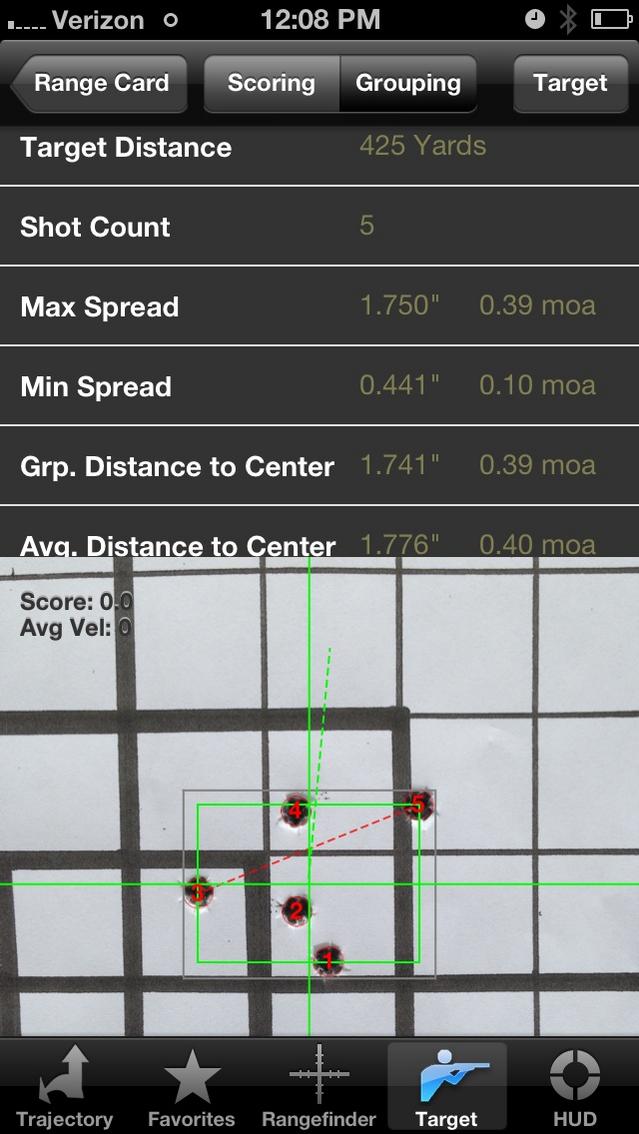

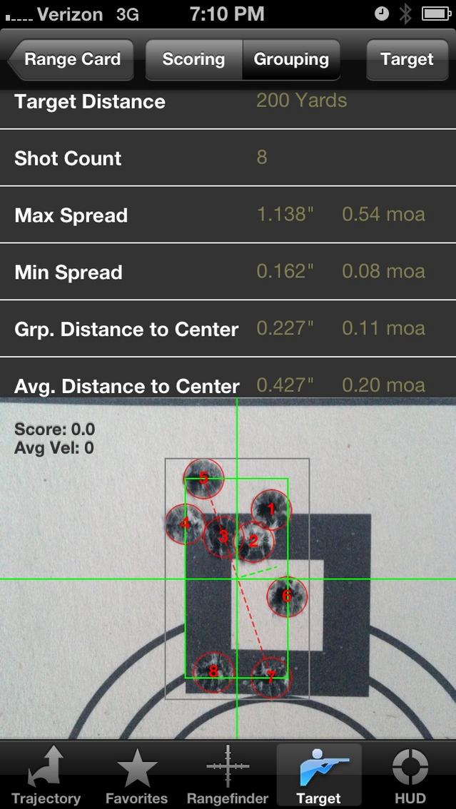

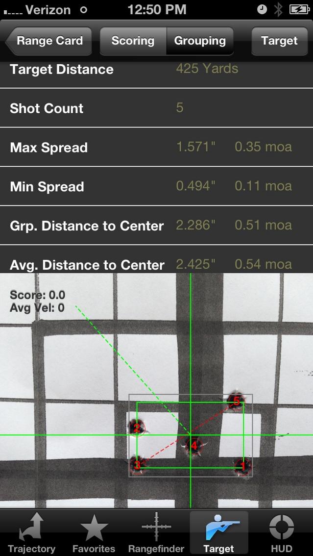

Target Results at 200 yards,
Range results using 5 round groups, .001 neck tension, CBTO 1.904(found this to be max slip fit ). Outstanding reduction in group size, .51, .57, .39, .35 MOA, looking very consistennt.
