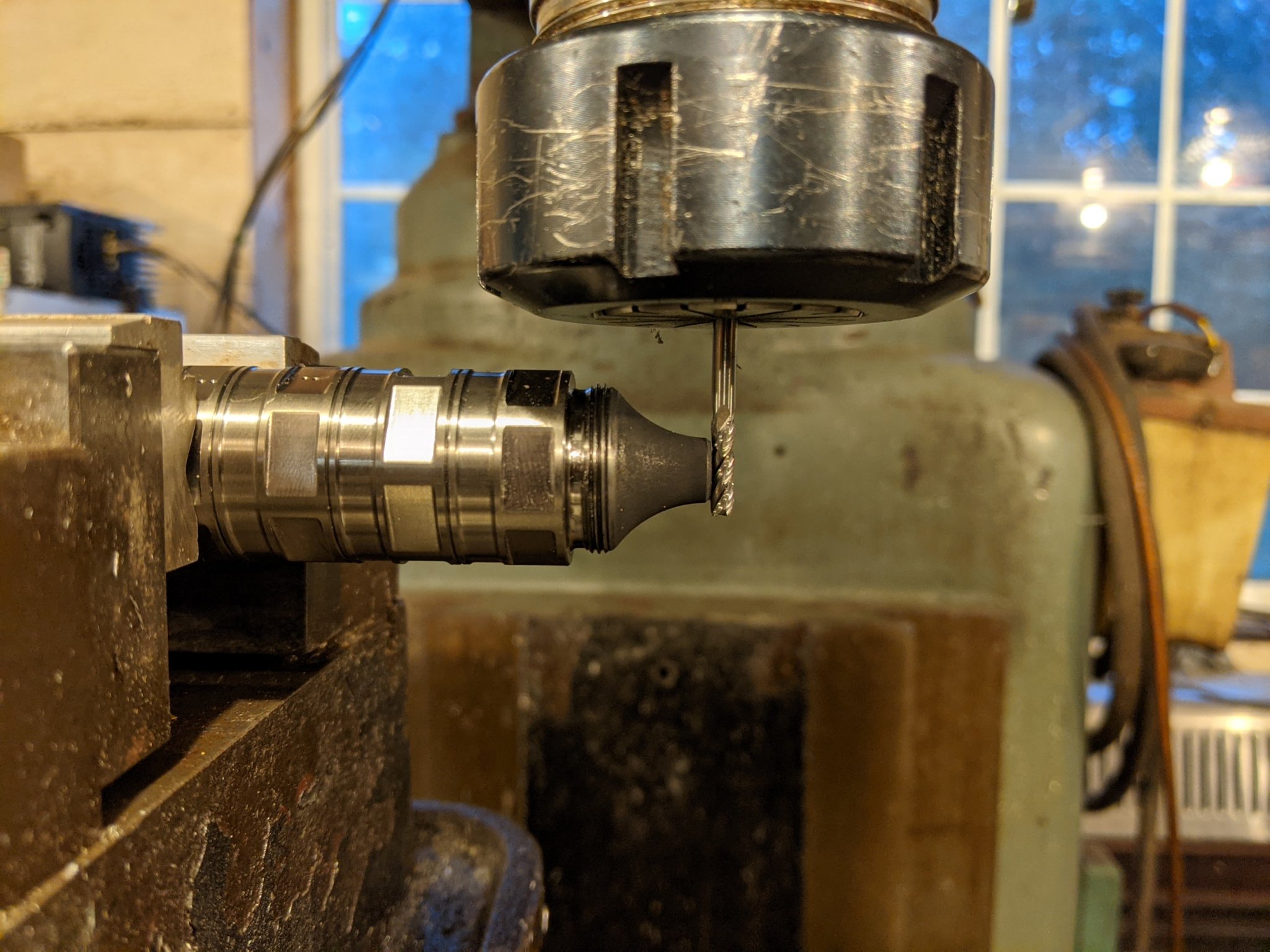

Would I buy one again? Eh, not sure. I did this F1 build and a modular Quell-Tech 22 suppressor because I thought it would be cool to configure the cans for different purposes, but the reality is that I typically leave them in their longest config to achieve maximum performance.
Clipping a modular assembly isn't all that hard:
1) Tighten the baffle stack
2) Scribe each baffle with a number or letter or hieroglyphics or whatever
3) If you're not clipping the blast baffle, pull it off and move it to the distal end of the stack.
4) Clamp the stack in the mill vise using only the last one or two baffles (depends on how you proceeded with step 3)
5) Clip the first baffle in the stack, and remove it
6) Repeat step 5 as necessary until all the baffles are clipped
7) Remove any baffles left in the mill vise
8) Reassemble baffles as marked in step 2
9) Stare down the bore and marvel at the aligned clips
10) Shoot the thing
The below photo shows this process at roughly the half-way point in a Quell-Tech Ti 22 assembly. This one got symmetrically clipped to test the efficacy of this method with a randomly assembled stack of unaligned clips, but that testing hasn't yet occurred.
