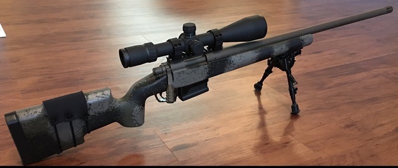

As my first post on Hide I would like to show off my new Rem 700 6.5 Creedmoor.
Specs:
Rem 700 action
24 inch Medium Palma Bartlien 1:8 twist cerekote-Patriot brown
Vias muzzle brake 5/8x24
Timney trigger set to 2.5lbs
Ptg m5 bottom metal
Magpul 5 round mag
leupold 15 moa steel base
Medium Seekins rings
Weaver tactical 4x20x50mm
Grayboe Renegade
Harris bipod
Diy beer koozie cheek pad
Gunsmithing:
Rws Gunsmithing: Barreled action
Alamo Precision Rifles: Stock/duracoat
Elam Custom Gunsmithing: Marine Tex bedding- Action/bottom metal
Cleaning Supplies:
Kg1, Kg2, Kg12
Tipton 36 inch rod
Tipton bore guide
Tipton steel core nylon brush and jag
I plan on running factory loads for the break in / first 100 rounds. Let me know what y'all thing!

Congrats on a nice gun.
Do yourself a favor and do away with the steel core nylon brush. JMO always use brushes with brass cores. Love KG products.
This is my first post here. Very nice gun, I am looking to start a build and was wondering how do you like the grayboe stock?
My stock colors are modeled after the Manners sponge camo- od green, black, and fde. The Grayboe stock feels really good! I haven't had a chance to take it out to the range yet, so I'll have a better review once I take it to the field. I was worried about not having an adjustable cheek riser but it's fits me perfectly with 0.92 rings. Without the bipod and with 5 rounds of ammo it weighs 13 lbs even.
Congrats on the 6.5 choice. I really enjoy shooting the 140 ELD's. Great job on the sponge camo and would also like to hear some results on the Grayboe stock.

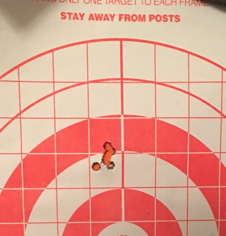

Quick range report from a couple weeks ago. Here is shot 13-18 after a 12 shot break-in period. I'm pretty excited about the results from the factory eld's! I picked up two pounds of h4350 and plan on doing a work up on some 143 gr eld-x's soon.

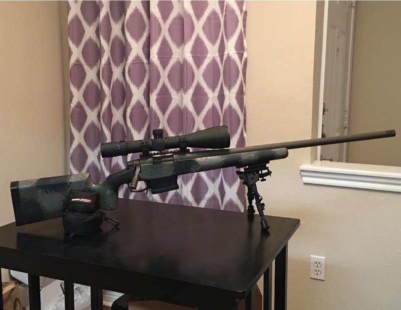

Also I added some olive drab paracord to my scope that I picked up from hobby lobby for $4 per 100 foot.

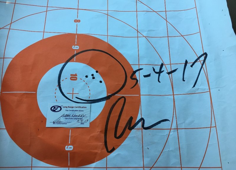

Five shot group at my local 3 hundred yard range which qualified me for to use the 400-600 yard range.

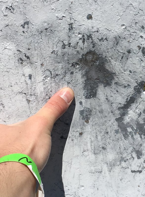

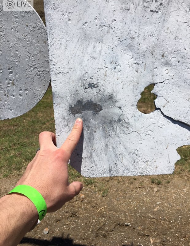

First picture was my first two shots at 413 yard hit right in the appendix, then I adjusted 0.75 mils and landed three hits just right of center mass. Not bad for 12-19 mph Houston wind!
