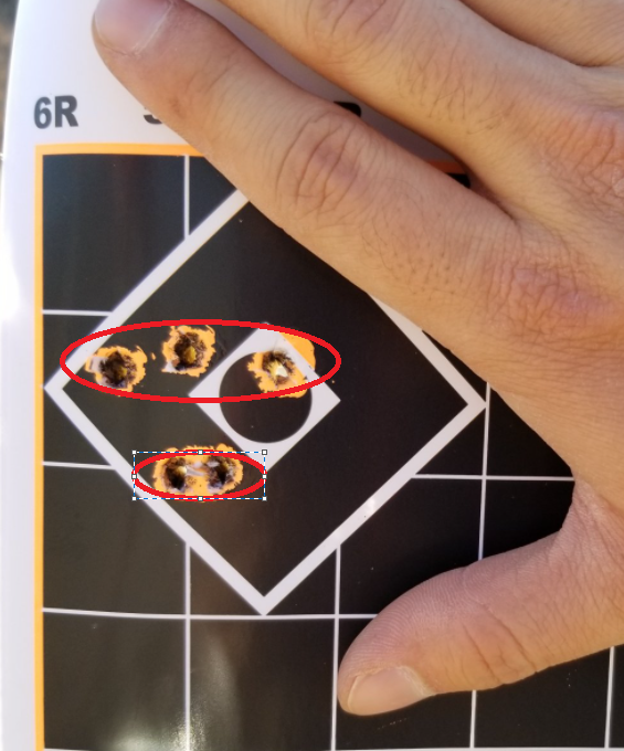

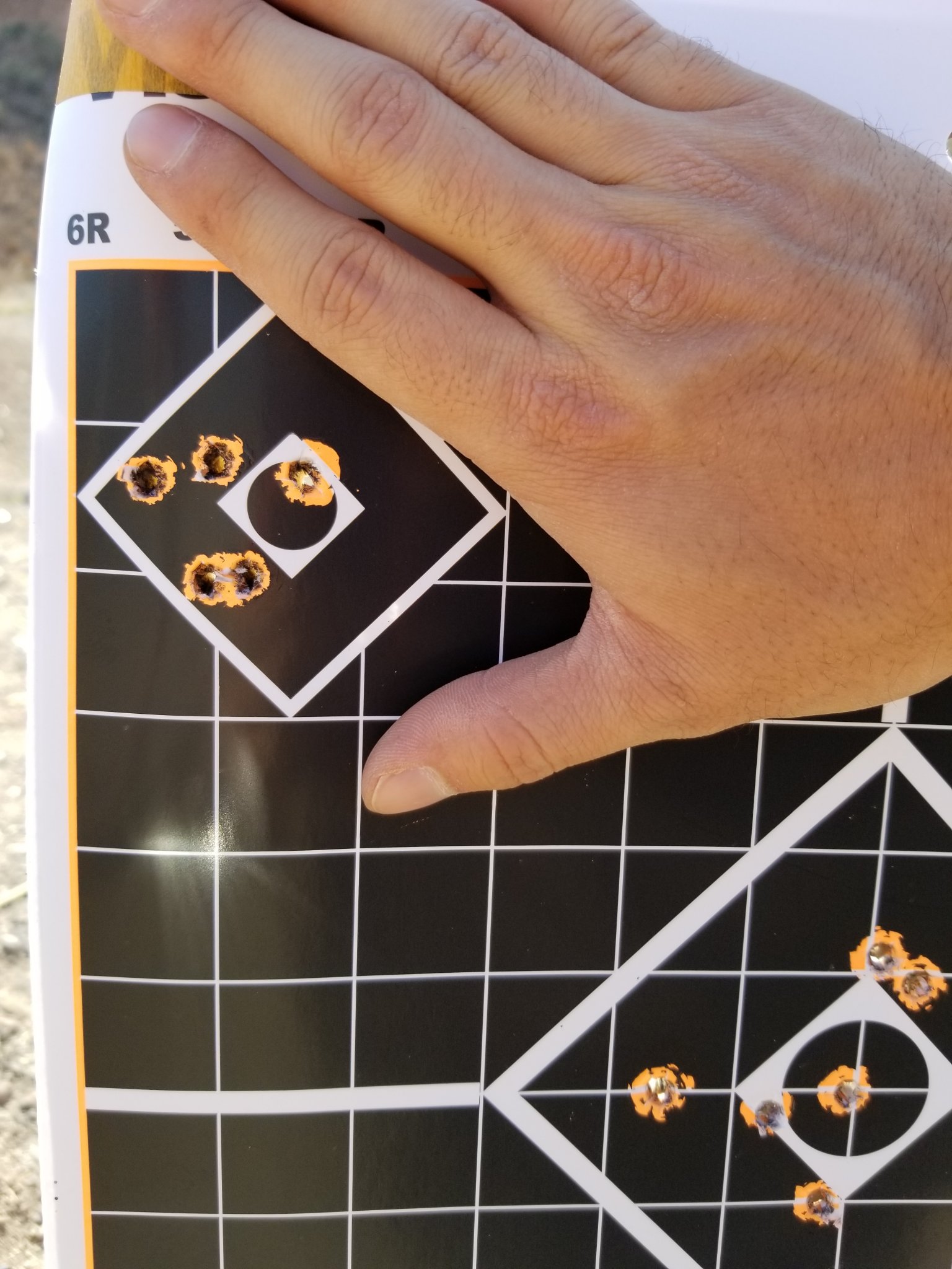

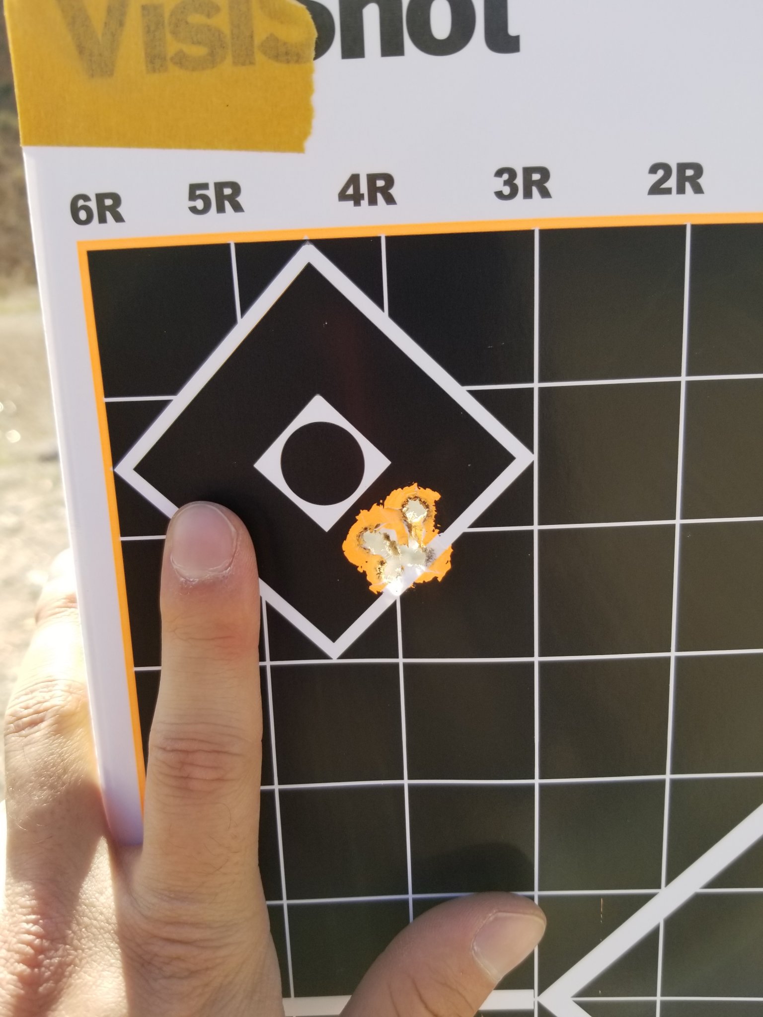

In my cases, it's not the last 2 that open it up, that was poor wording on my part. The flyers appear randomly. Sometimes it's the 2nd shot, sometimes the 4th etc... And I cannot discern any vertical vs horizontal stringing. Strange as it is, it just opens up wider in both regards. I also switched back and forth between shooting the Lapua vs the Black, the Black just underperformed each time. Weirdest thing.
I've got a pair of pics, the better group is the Lapua, the wider group is the best Black group I could manage (about 1.1moa).

If you just showed me this picture without any description, I would've assumed 2 different groups. Looks to be about a 0.6-0.7" space in between the centers. The difference between would've been two different powder charges as well as the top group being affected by inconsistent seating depth or strong gusts of wind.
Since you said it was a fairly gusty day, the wind is likely the culprit for the horizontal. However for it to affect vertical, that's only likely if it's also around a 6 o'clock wind (tail wind). So basically strong gusts of wind from roughly 4-7 o'clock could account for both the vertical and horizontal dispersion.

Interesting you say that, gusts were right at 7-8 o'clock. There was never a moment of "no wind" but I did my darnedest to take advantage of the precious few moments of "as little wind as possible" between the stronger gusts. I will make SURE to make my next range outing on a windless day!
