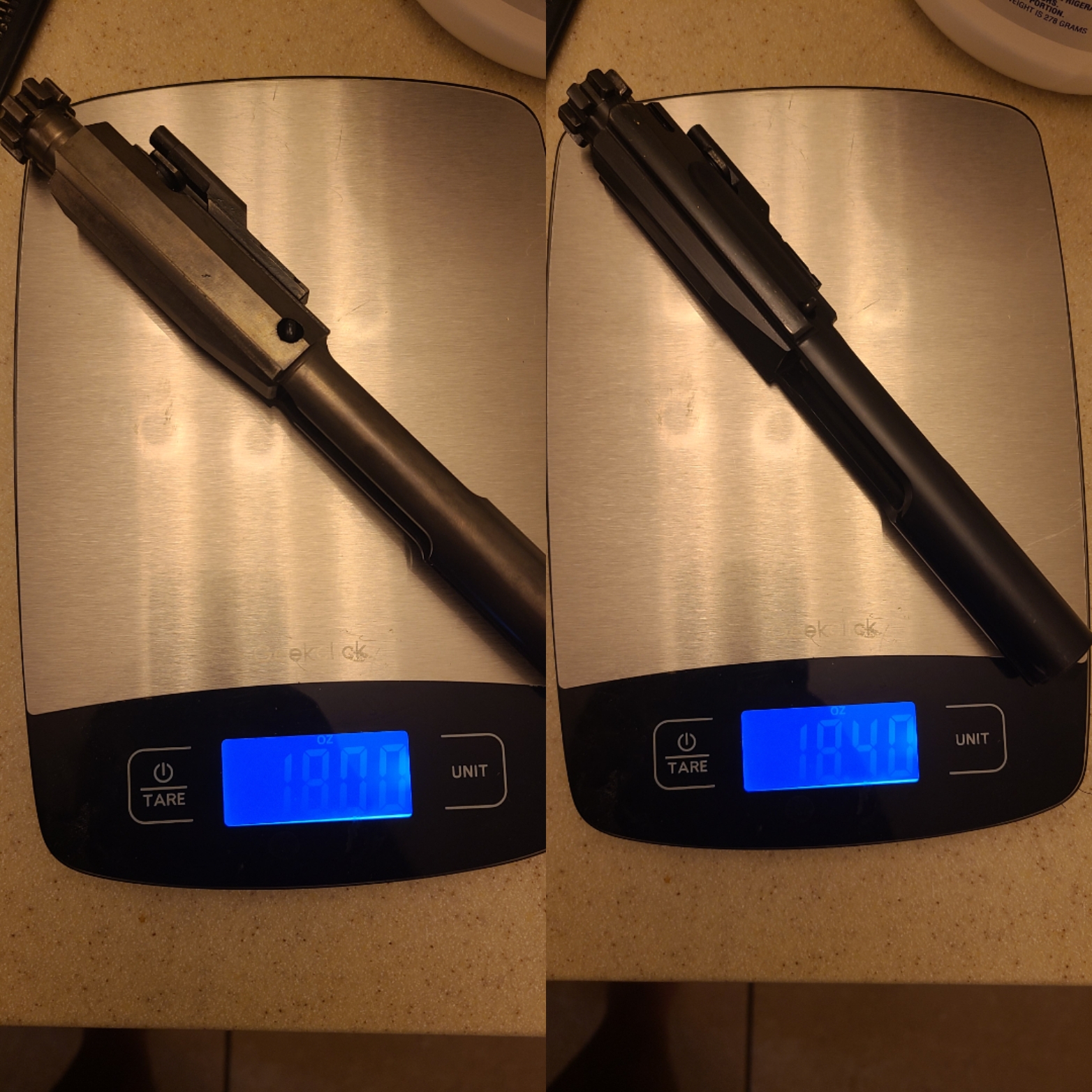

Also, the Aero bcg weighs 18oz and the JP weighs 18.4oz... so, that small difference in weight shouldn't matter considering all the different gas/ spring and weight variables I tested... not only that, but, every time I upped the buffer or spring rate, I adjusted the gas accordingly... I put one round in until the bolt holds back after a shot, then I add 1 more click higher for extra gas for added reliability... and, I start with 145 gr ammo for setting the gas, and then move up in ammo power...
