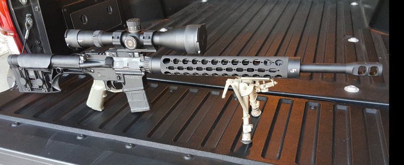

My .223 JP upper with a 20" barrel is the most accurate gas gun I've even shot. It's a .5 moa gun. I don't reload, so I tested around 20 different types of match ammunition out of it. There are some that shoot great and some that shoot surprisingly bad.
My search for a precision .223 gas gun is over.
Great:
Copper Creek 73gr Berger
Defender 69gr SMK
Prime 77gr SMK
