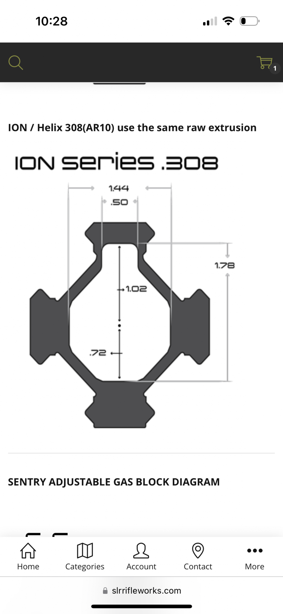

I’m currently building my first .308 upper and I am looking at an SLR Handguard. My question is if anyone here sees any issue with comparability given the manufacturer dimensions in the photos?
View attachment 8107710View attachment 8107711I’m currently building my first .308 upper and I am looking at an SLR Handguard. My question is if anyone here sees any issue with comparability given the manufacturer dimensions in the photos?
It will fit but won't leave enough room for handguard flex and barrel whip and the adjustment screw will be a pain to access, the JP AGB are nice but indented for round handguards.
Pick up a SLR or SA AGB.

I run all SLR handguards and superlative arms AGBs with no issue, both on small and large frame. Let me know if you want any pics.
