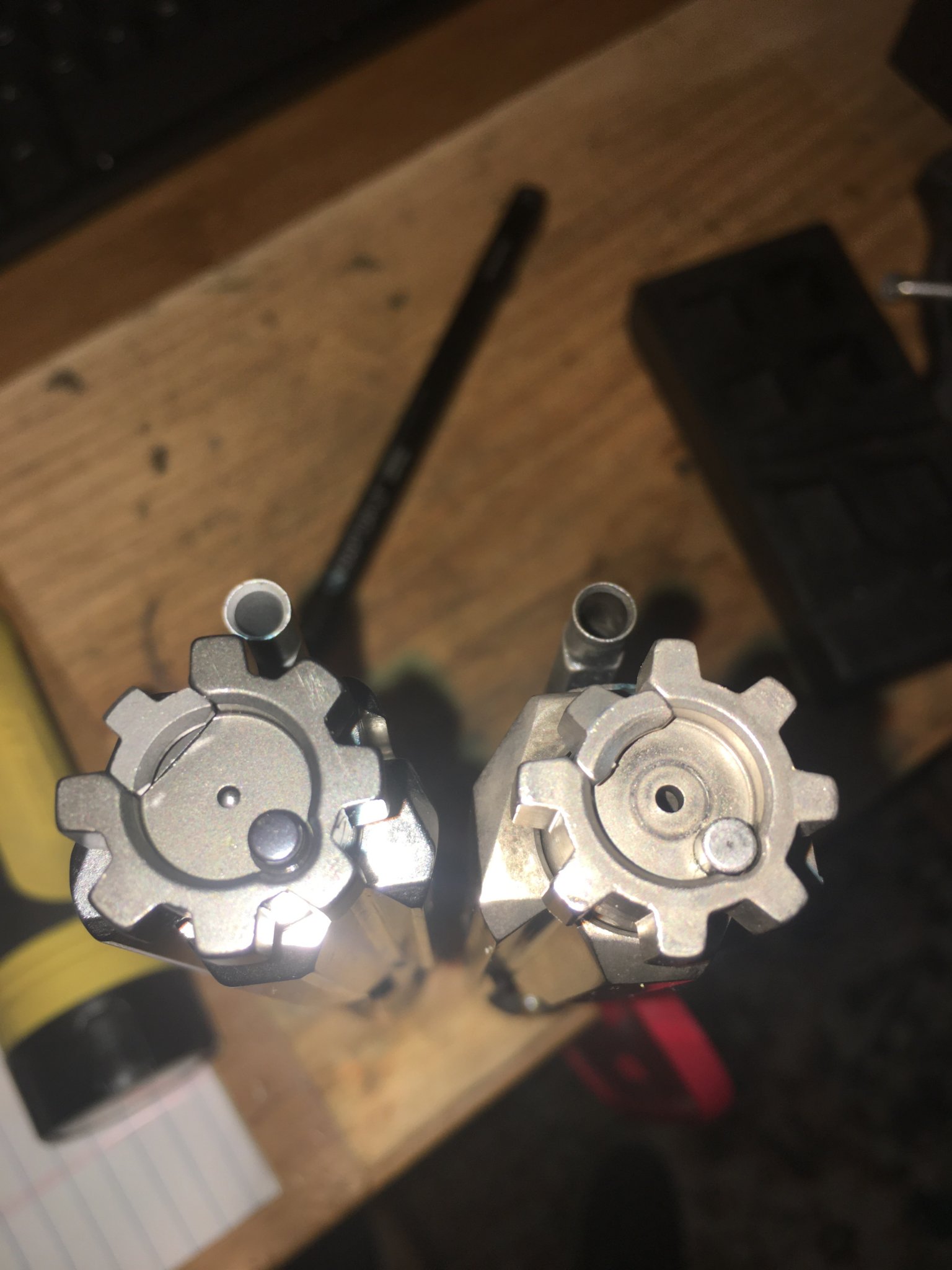

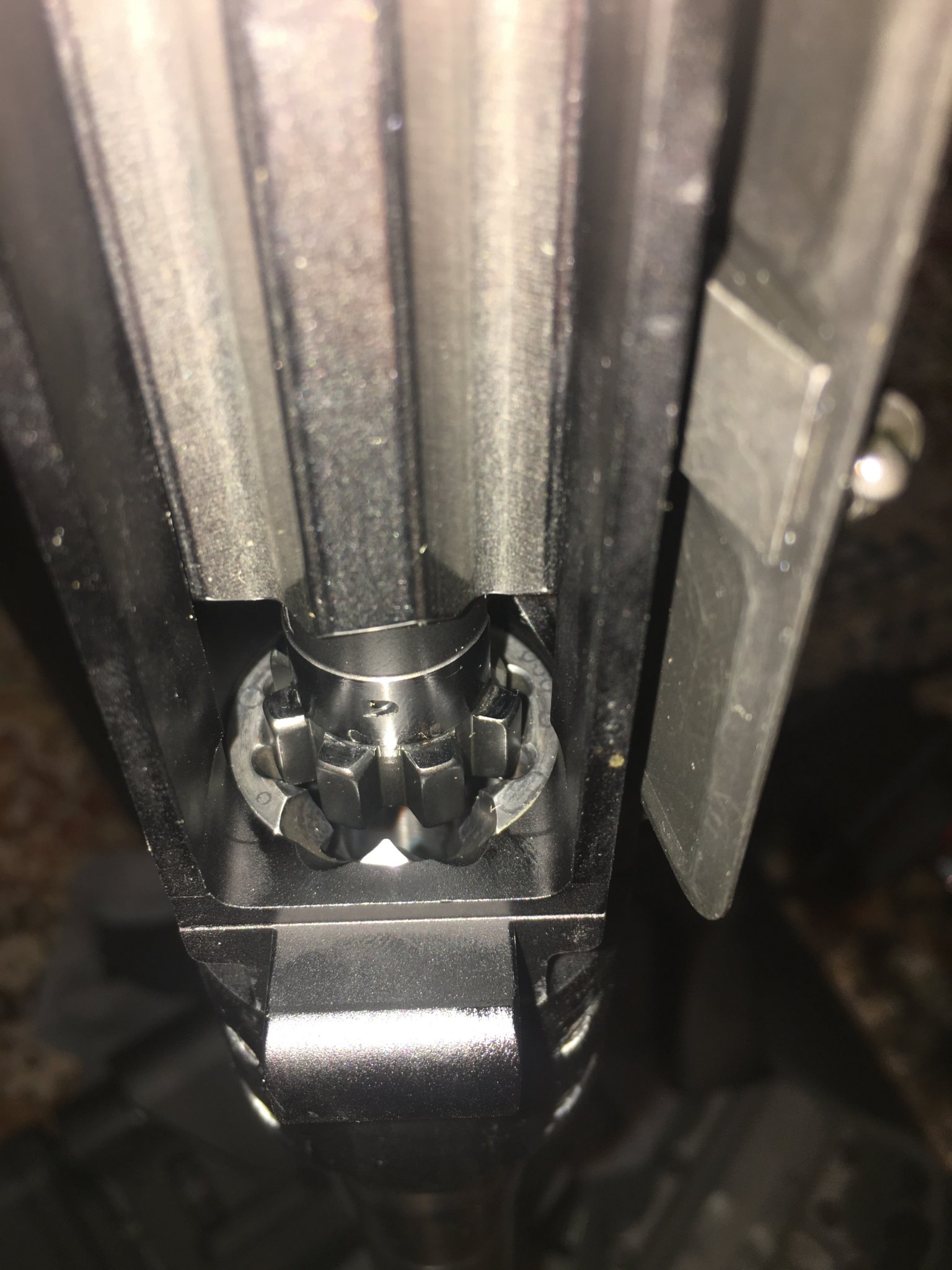

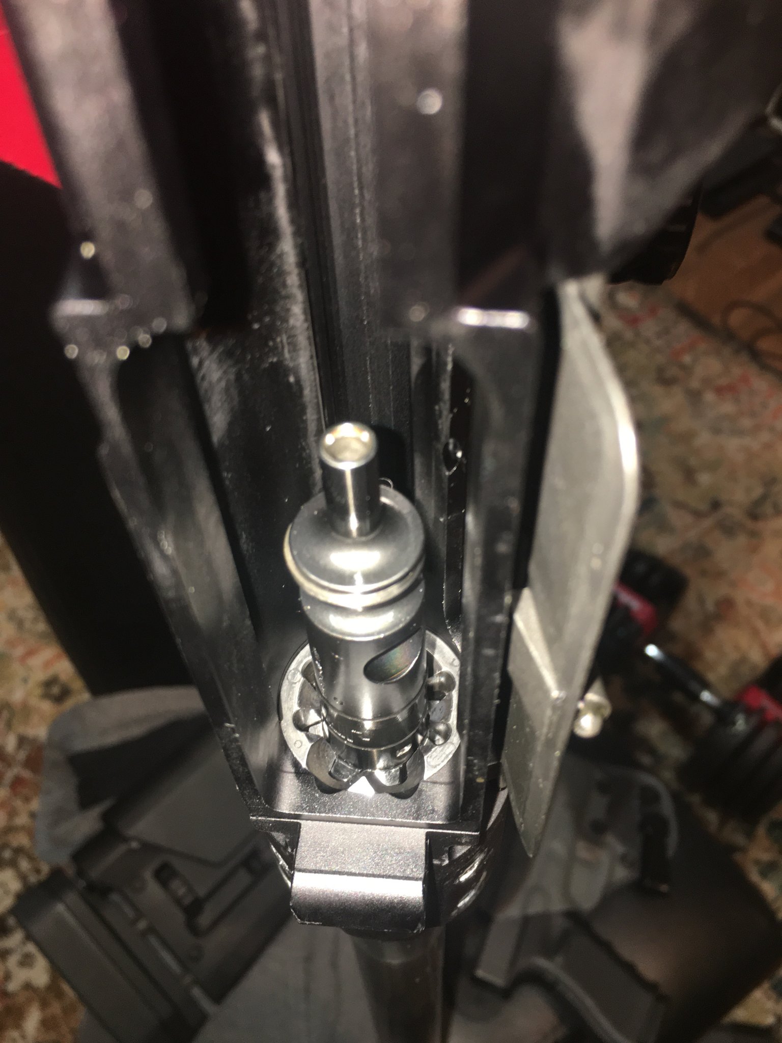

Just picked up a JP Enterprises LMOS bolt carrier along with the High Pressure Enhanced Bolt for 308 Win. I have an Aero Precision M5E1 with a brand new Bartlein 20-inch 308 Win barrel spun up by Paul Craddock. No rounds have been fired yet through this, was just waiting on the bolt to come in and quarantine to be over.
The Problem:
The JP LMOS carrier and JP High Pressure Enhanced Bolt came in today and I assembled them and tried dropping it into my upper. Problem is the BCG wont go in all the way. It seems that the bolt lugs are contacting part of the chamber or feed ramps which is not allowing to continue forward. I have an old Toolcraft BCG and decided to try the bolt from that. Dropped it in the JP LMOS carrier and it closed just fine.
You can also see in the photo below that the JP Enhanced Bolt will go into the chamber just fine, but not when installed into either the Toolcraft or JP carrier.
What could be wrong with the bolt? Tight tolerances on the chamber and the bolt stacking up?
Thanks for input!
Bill

Look at the barrel extension the lugs/feed ramps are clearly rotated too far clockwise in the reciever. Loosen the barrel nut and center the barrel extension before tightening. Also make sure the index pin and pin recess in the upper are not damaged due to overtightening.
If you look at where the receiver feed ramps and barrel feed ramps meet, it looks like the barrel extension is rotated off center.
Now look at the thickness of the lugs on the JP bolt vs the toolcraft lugs. The toolcraft are probably small enough to slide through the off center lug slots while the JP isnt.
So I'm in the shop right now and took the whole upper apart. Without the barrel torqued on, I rotated the extension so that it was perfectly centered and the JP Bolt slid right in and chambered... FML

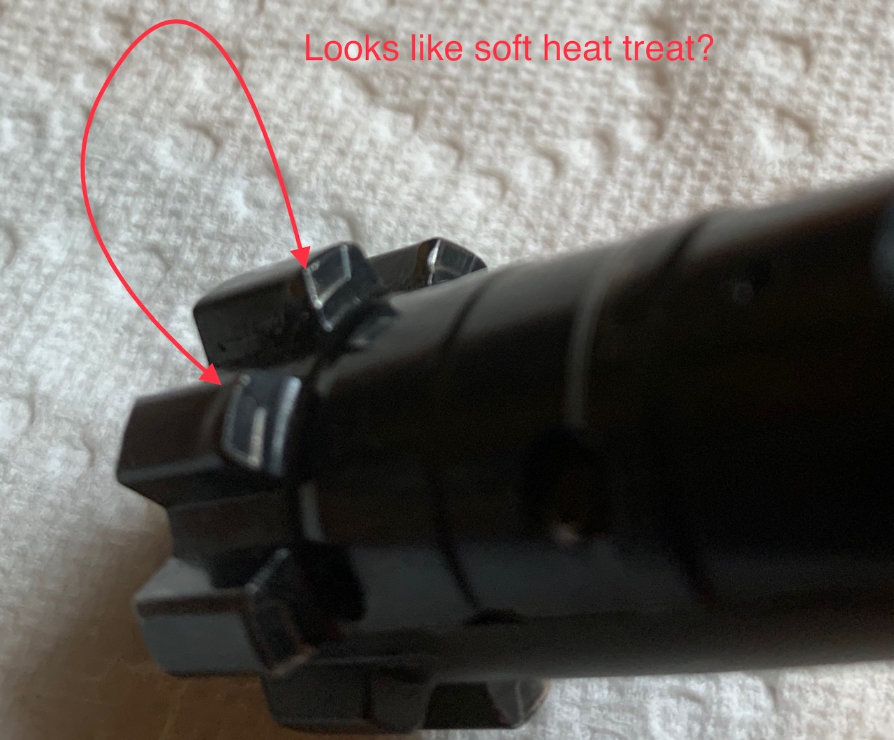

For what its worth, I see many bolts that the rear edge of the bolt lugs get shaved due to barrel extension indexing.
I shim all my barrel extension indexing pins to the upper. I make a small " U" or "J" out of hardened shim stock and adjust the barrel indexing so the bolt does not swipe the extension.

this is exactly what the issue is after taking everything apart. When I torque the barrel nut down the JP bolt catches the extension. Before applying torque, the bolt closes no problem. I noticed that there is some wiggle room with the indexing pin to the upper.
