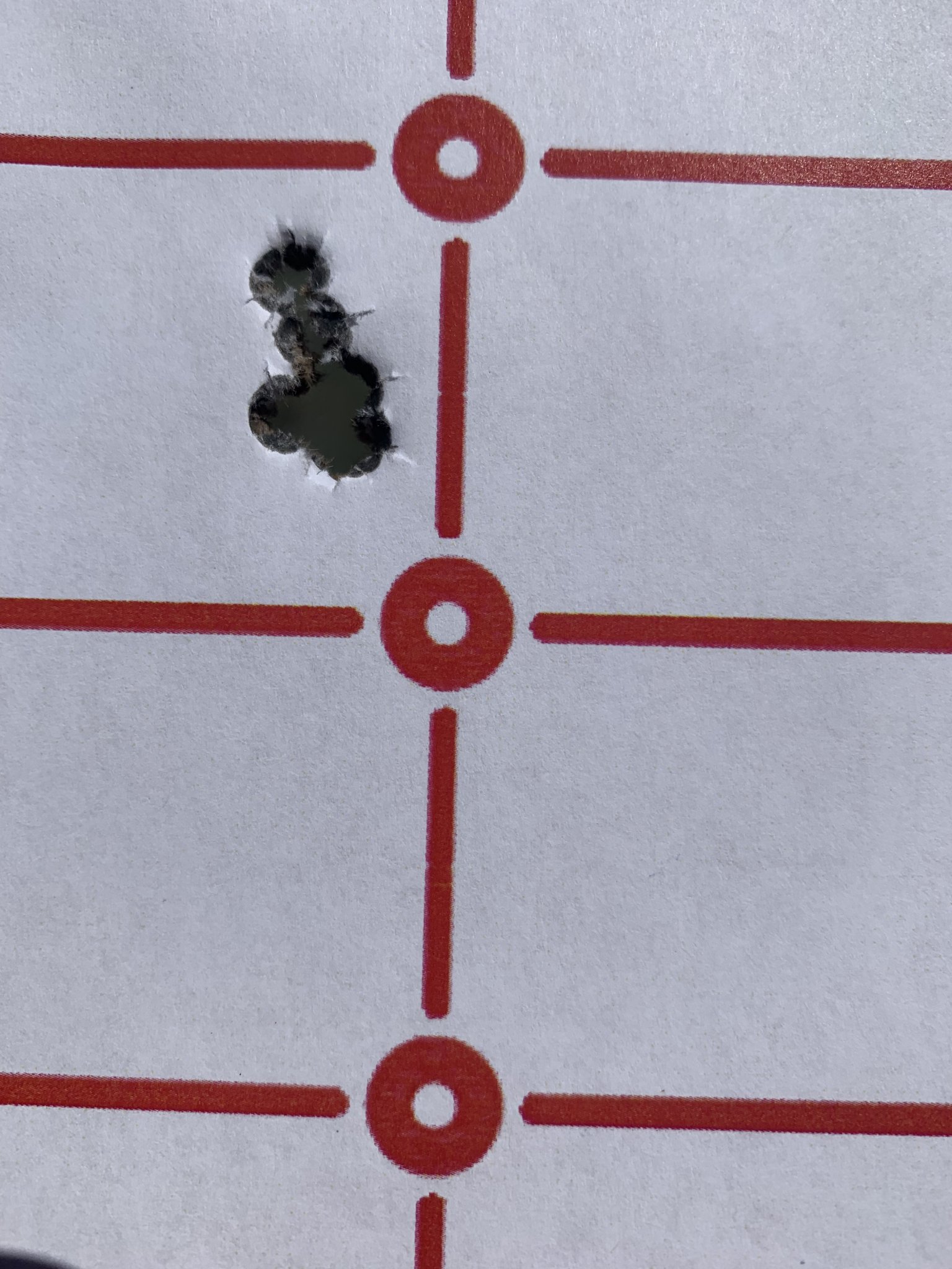

I did 7 different powder charges into 3/4" at 100 yards with varget and 130 ar hybrids at 0.010" off.
Only about 400 rounds wear and was barely inside asc magazine.
I went no farther cause would be beyond magazine length in no time.
Could probably use the berger method to find a longer jump that fits the magazine.
130 eldm 0.030 off were half inch with 40gr varget but hornady was hopeful on the bc. Fell apart past 600 yards.

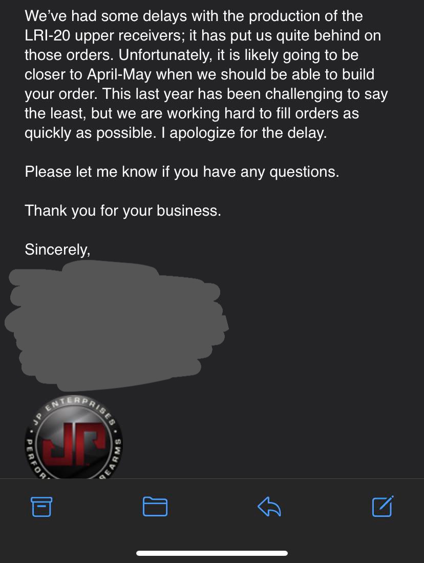

I’m actually so hurt right now man. Since I’m beyond the original 16 week lead time I decided to email. This was the response. I ordered this in September while I was deployed

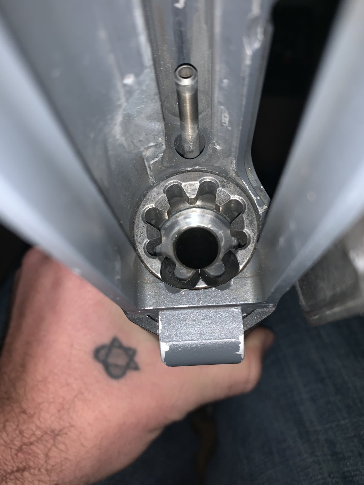

Awesome question. When I had JP build my valkyrie, I was also in the process of building a .260 rem gas gun at home. I knew before I started that precision ammo for it would be expensive at best and tough to find. The readers digest version is that my barrel choice (20” lilja drop in) had no feeding cone cut into the barrel. This, plus the width of the feed ramps created pressure issues where any VLD style bullet would pass through the feed ramp and strike the barrel at the 7 or 5-o clock position prior to achieving enough lift to clear the barrel. These were all seated at least .20 thou under mag length. This would cram the bullet into the case creating pressure issues. I panicked because I had a comp coming up in roughly a month.
I remembered one of the JP guys telling me that he still ran and reloaded for .260. So I hit him up. The dude sent me his recipes and I have never looked back. He recommended any polymer tipped round for gas guns. He was running lighter eld-m bullets. I went from the natural tendsncy of trying to push a heavier 6.5 bullet to super charging a lighter 123-130gr faster to offset the lower BC. The shorter ogive length allowed for flawless feeding. Also, to off set the pressure he was seeing with H 4350 he recommended the even more elusive RL 16. Great recipe. Not the most awesome group, but it works. Barrel pic below too. Resolution on it is garbage at best
