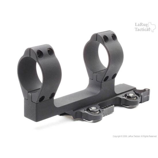

While I am sure you checked... make sure the scope mount and rings are tight.
If it happens to be a LaRue QD " Vertical" ring mount... make sure you tighten the bottom ring screws first, then the top ones.
Mounts like this..
Mounts like this..

Yes, good point, my first or second thought as well, just that mount! So I removed the scope and remounted it, tightening the bottom rings pretty tight first (with top open I doubt the torque really matters that much, NF scopes are pretty tough). Also cross-checked by switching scopes with my HK, NF NXS 1-4 with NF Unimount. No difference.

while the rifle is back at JP trash that larue mount.
actually do that before sending the rifle back haha
