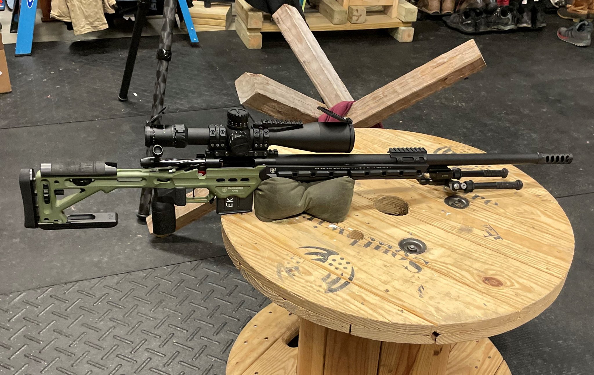

We have one TT525P 5-25x56 JTAC left in stock! It's not on our site so call us at 916-670-1103 :)
Here's a recent happy customer with his TT525P JTAC
