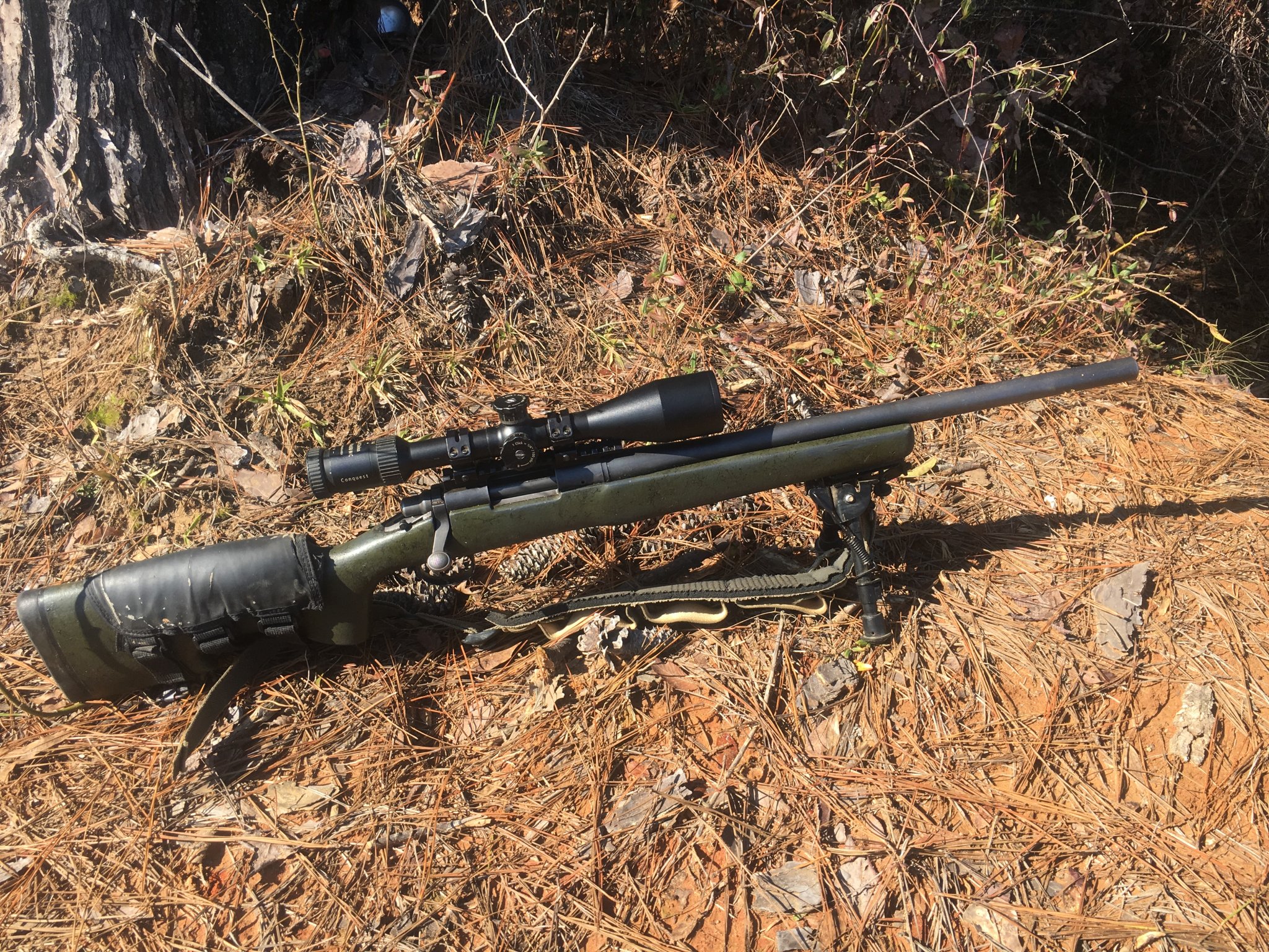

I’d like to start off saying that I own several “high end” rifles. GAP, AIAW, and some custom builds. BUT one of my favorite rifles that I own is a Remington 700 SPS TACTICAL 1:12 with a 20” bbl bedded in a Bell and Carlson stock. I have probably shot 5,500 rounds through it. Well, yesterday I picked up a box of Hornady 178 ELD-X ammunition just because I felt like something easy. SHOT LIKE SHIT. 3 moa at 110 yards.

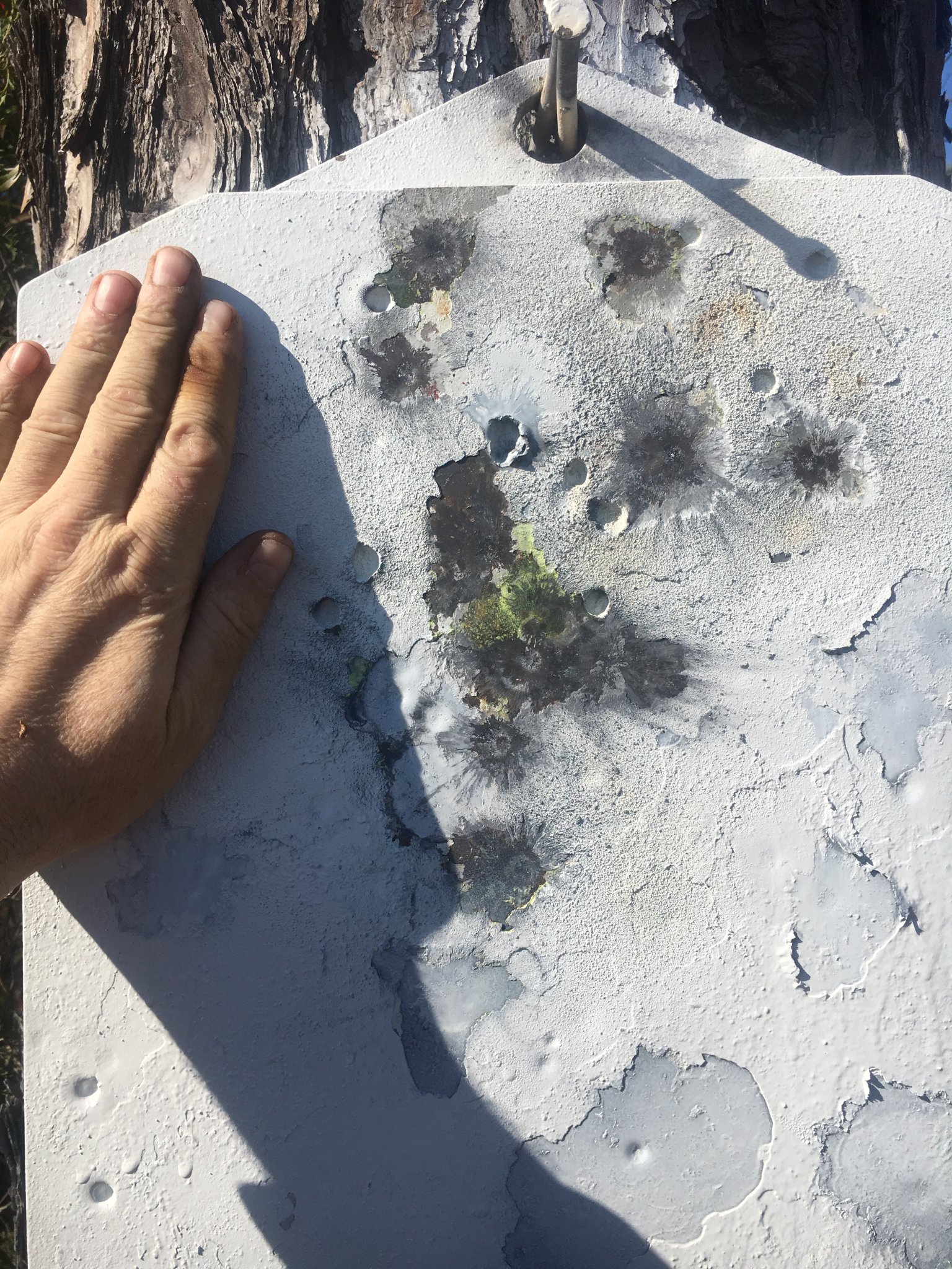

So I take all 20 pieces of brass upstairs to my reloading room, use a Forester bump die with a .334 bushing and load 42.5 Imr 4064 with a 175 smk. Guessed it would be running about 2490’fps plugged it in and this is a 10 shot group that followed at 605 yards. It’s still, after so many years, so satisfying to see a 600$ rifle shoot like a 2,500$ one. Now I know some people are going to say well that’s not that great. Well the wind was blowing 15-20 mph and I was standing in the bed of a Kawasaki MULE just to see the plate. Beauty is in the eye of the beholder

Nice , I’m down here in Mississippi and it’s the humidity that’ll make a 29 degree morning here feel like a 0 F day in Colorado. It was 5.4 mils to get to 605 and what’s crazy is I literally guessed 2490 fps. All those hits were literally back to back with no previous data. I was pumped!!

OP, nice group - what is that, maybe 7 inches high and 5 inches wide? Hop in your mule and drive a little further, I bet it will still hit well at 7, maybe even at 8.
