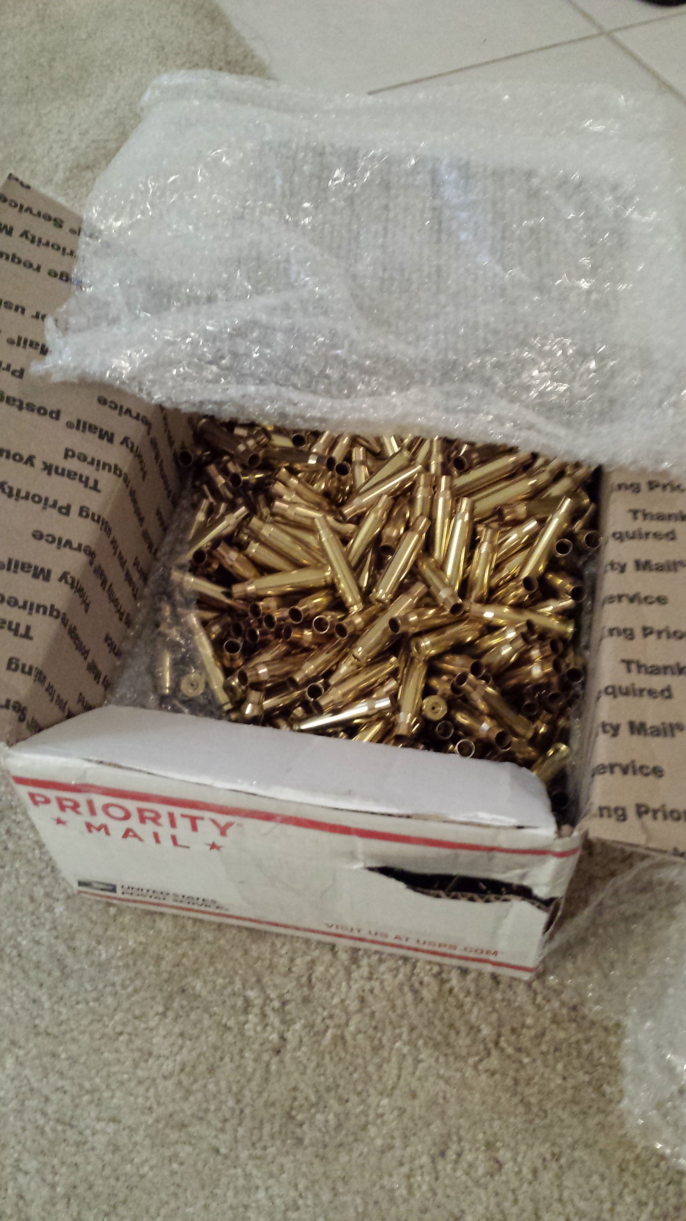

They have a fire sale going on now, $43/100 cases shipped.
Since I was on the fence about ordering I figured I'd share some info for anyone else that's thinking about it.
I ordered 400. Shipping was fast. They came in a USPS box with minimal padding, the corner was ripped open exposing them to the elements. There were 402 pieces in the box so two freebies!

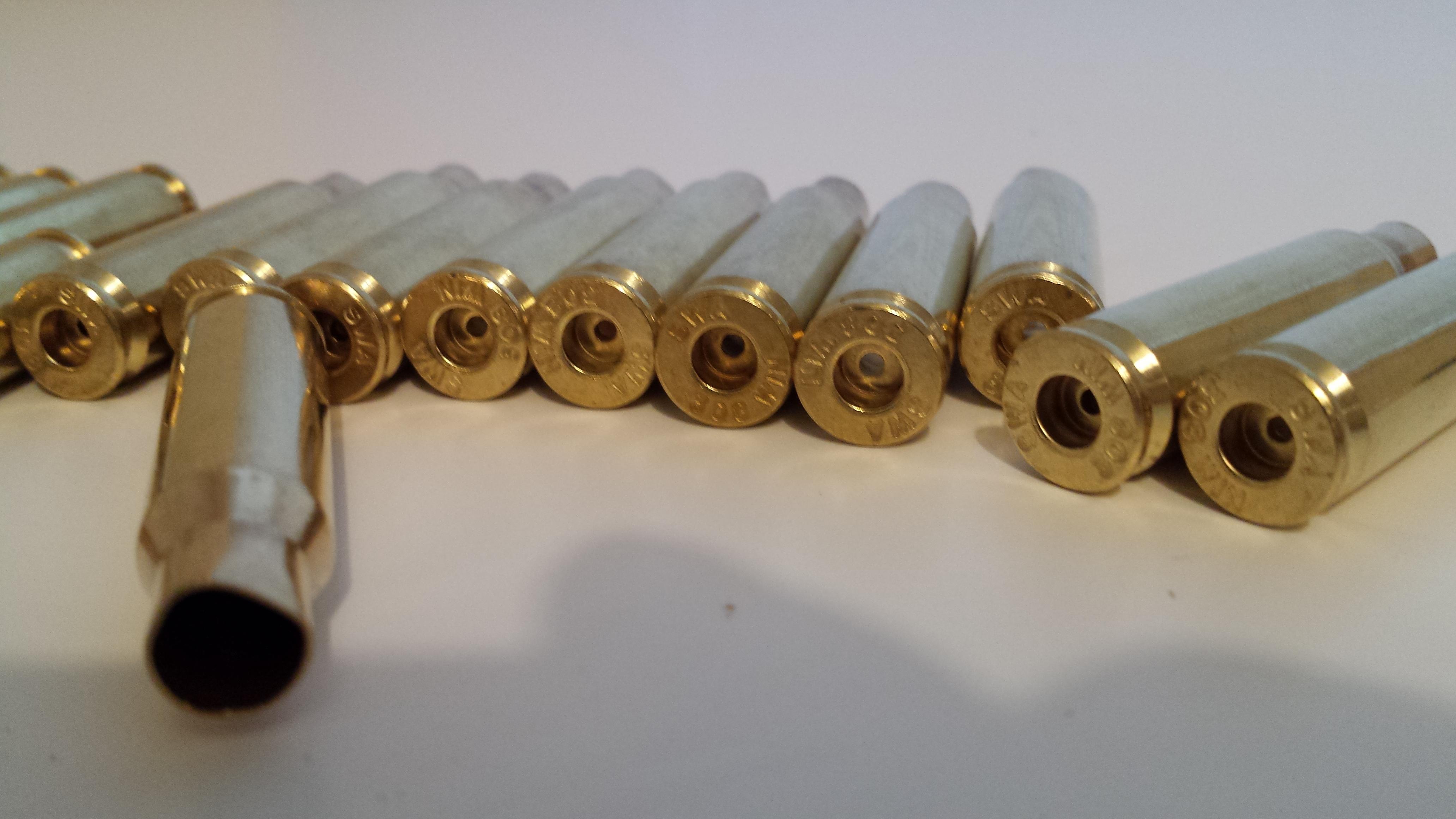

SWA headstamp, they weigh in around 179 grains. Headspace looks to be right on at about 1.630 (RCBS mic). Brass is very clean.

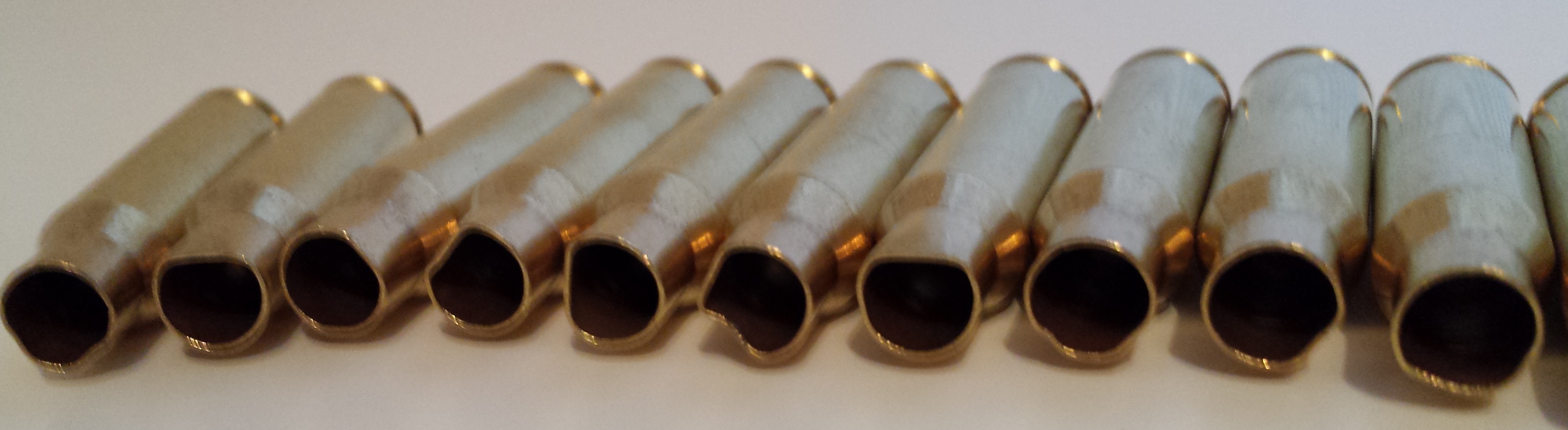

I was hoping to load them up right away but they will need to be neck sized at a minimum, about 10% of them were visibly out of round and about 5% had major flat spots or folds in the necks (not sure if that's from pre- or post-shipping). I also recommend touching up the flash holes. Otherwise they're very nice looking and consistent. If you don't mind a little extra work they might be a decent cheaper alternative to Lapua (about $63/100).
I will get some loaded up this weekend and update this thread with some info about how well the brass shoots in my rifle.

No idea. Yeah I was hoping they'd arrive gtg without having to go through and size. Some are bad enough I may need to anneal or just take some runout on the first cycle.
I picked about 100 that weren't too smashed and put them through the lee collet neck sizer. 50 for my R700 and 50 for the POF p308. Some of the primers felt like they went in a bit too easy and two of them popped out in the POF in a load that wasn't near max.
I also reamed the flash holes in the bolt gun set. They did great in the 700, had some nice groups and I may actually use them in an upcoming palma-style shoot.
Next I'll try the ones with really kinked necks to see if it makes a difference.
tula primers are going in with zero resistance on several of the once-fired cases. Extremely loose compared to FC/GMM. The brass itself looks great and is very consistent otherwise.
