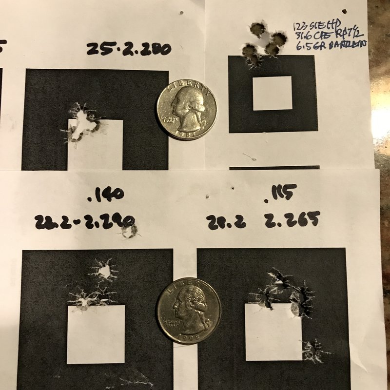

These are samples from testing Bartlein and Lilja barrels, for reference. Hoping your Faxon will deliver, as well. IMG_2773.JPG

As noted, give the Faxon a chance to do right. And it'll take 100+ rounds to just get it settled in properly. Should pick up speed along the way, as well. Handloading for your particular and specific barrel is best way to determine real potential-if after some thorough testing, it doesn't meet your expectations, then consider some of the above choices.
