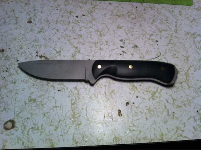

I figured I would try my hand at knife making. After watching countless hours of YouTube, I ordered some O1 tool steel, brass pin stock and some micarta grips. I didn't have any fancy knife tools. I mainly used a grinder and hand files to do all the work. I made a filing jig courtesy of Gough customs video and had at it. I decided to parkerize the steel when I was finished to give the steel a durable finish that looked good.
I bought a small belt grinder about half way through and found that it is a real good way of screwing things up. I think I will stick to files for the final finish next time.

Kudos brother, thats pretty bad ass if you ask me. Nice size and looks great. You should be proud of that!
How much time and money of you have into that? I'd love to try one myself.
Looks good. What did you do about a heat treatment to harden the steel?
I built a small forge using insulating bricks and a propane torch. You can find it on YouTube if you look up micro forge or search for Gough custom and then look for his video on how he built a similar forge. After heating to a non magnetic state, I plunged it in peanut oil and then put it in the oven at 400 degrees for an hour. According to the paperwork that came with the steel, that should have hardened it close to 60 Rockwell.

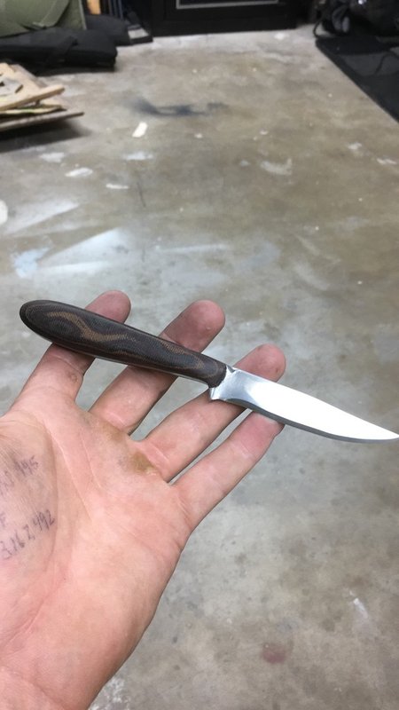

Here are a couple I finished recently. The two outside have g10 and the middle one is linen micarta. The g10 is a little tricky to get the color layers to look perfect when you grind it and I figured out that if you peen the brass pins too much it will make little imperfections In the g10. You can see it a little in the picture around the pins. Basically these are neck knives made of 1/8" o1 steel.

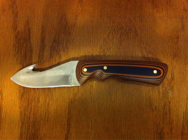

Finished up a knife for a friend today. He had the blade but never had any handles. He ordered up some g10 and I went to work on it. I wasn't sure if I would like the orange and black but turned out pretty cool looking. Also made a kydex sheath for him. Gut hook blades are a pain to make a kydex sheath for!

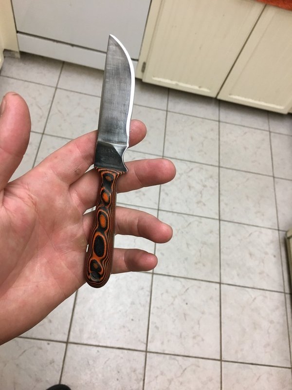

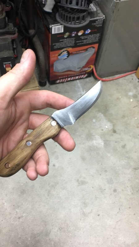

Just finished my first a few days ago.. forged from 1/4x3 flat and walnut handle
Sent from my iPhone using Tapatalk

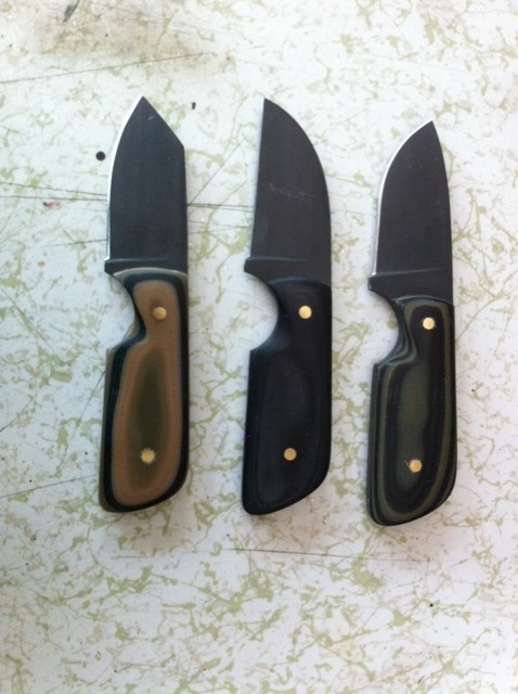

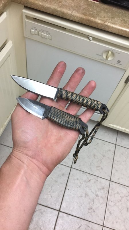

These were some neck knives I made that have 1.5" blades and can be worn around the neck with a piece of paracord for around camp use or just an easy to hide knife.

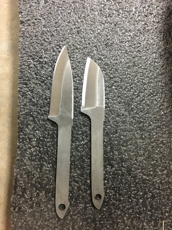

And made these. The small gut hook one is like the outdoor edge ones but smaller and works like a charm. I tested it on 4 deer and an elk and it was still sharp. The Schrade looking one was made for my Dad who loves this type of knife and I made this one so he would have one that would stay sharp and be more durable.

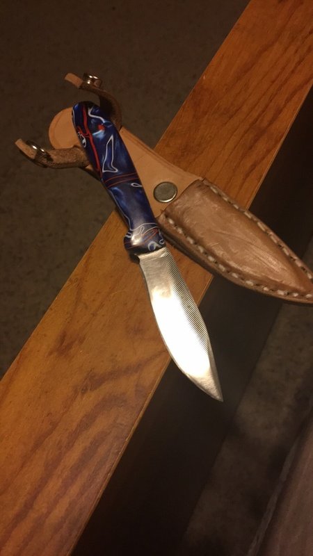

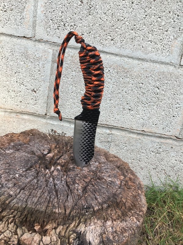

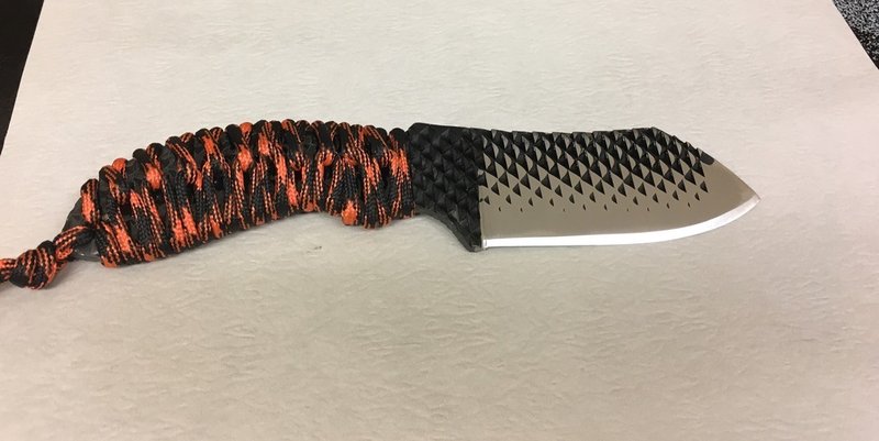

made a handful over the past few months...mostly out of files/rasps, but the black ones (cerakoted) were done with 1095...the piece of 1095 stock i got wasnt perfectly flat on both sides and it kept wanting to warp on me so that was a pain...idk if that was causing the warp or my quench process, but the files never gave me an issue...no expert tho, was just bored one day and decided to have at it
