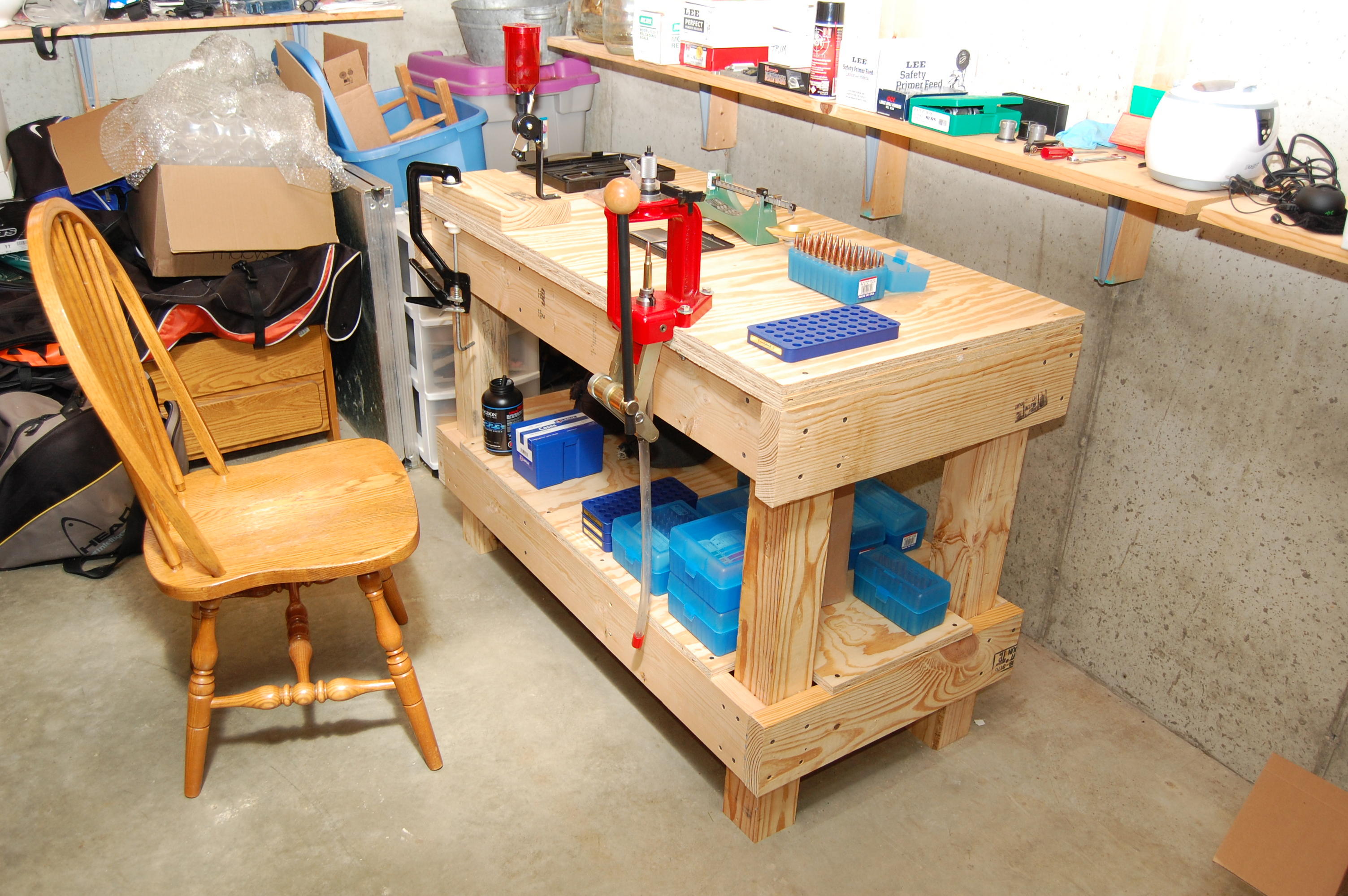

I'm pleased with it. I'm convinced you have to build what you want. This isn't something you can buy or I probably would have. What do you guys and gals think?

I built one very similar. The only thing I did extra was mounting corner wood around the outside to stop cases and things from rolling off the edge. But I wish I did an overhang like yours.
I also bought 2 boxes of cheap laminate flooring from home Depot for the top and sides. It's aesthetically pleasing and provides Alot of protection.
Looks like it is a solid build, and the overhang is a really nice feature for anyone mounting a press.
If there is some slack/movement in it still consider bolting it to the wall and floor, if it's parked permanently.
Also laminate flooring, countertop etc, will make a bench top that is much easier to keep clean
I am about to do the same myself in a newly finished room, 4x4 for frame,4x6 legs, woodscrews, expansion bolts and a 3,5 meters counter top, ontop.

Looks good and sturdy, also looks like you still have some room on the left and right, so the possibility of expanding is good. I am lucky enough to have a large garage and once done building 1st bench, got the bug of "expanding" so that's just what I did and for sure do not regret it. Shelves would be a good add-on, can't get too many of them. Eventually, you will get more and more "stuff" and that's a fact ;)
Good shooting and reloading.
Great job ! I need to modify my setup as well. I need to get my press and powder thrower higher. I am mulling over a "floor stand" type setup with the press arm mounted approx at head height. My back starts to ache from slightly bending over for hours while sizing or seating bullets.
Nice setup flashhole. I can appreciate neat & organized benches.
Hats off to you guys that build your own. Admittedly I'm not very handy that sort of way, so I went & bought a Kobalt from Lowe's. It got sturdy after I used some T brackets reinforcing the work top & back wall in addition to weighing it down with all the gear.
