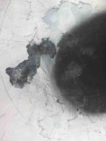

Just got the Montour meplat trimmer with inside de-bur tool, and john widden pointing die...
didnt takt long to set up, the montour trimmer kit offers the best results of all that i have seen but is not the fastest.
pic is of one trimmed, then inside de-bur, then pointed...

yea 1" verticle at 600 yds, i was sold.

Winds 5 gusting to 12 mph... 1" verticals about 2.5" wide... 600yds

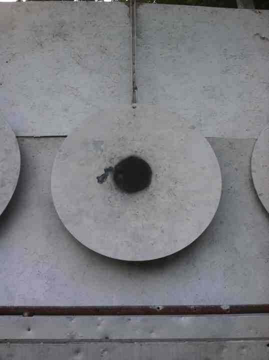

My gun was shooting around 3-4 inches at 600yds before trying any, the group pic on page 1 was in crap winds with a friends scope (ocular lens not set for my eyes)
So when I do return to the range, whenever that may be, I expect consistent sub 2" groups at 600

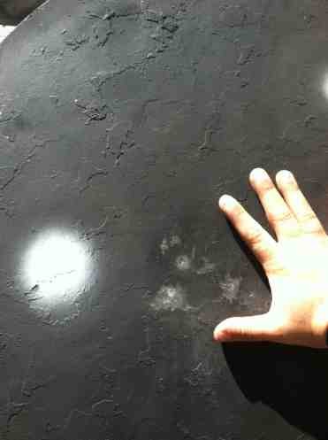

First batch of pointed and sorted bullets I have done... Shot yesterday, gun grouped 1.5" at 600yds
And my group at 1000 was 3x5" pictured below... (10" bull)
