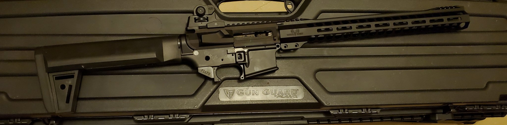

Just picked up the lower from my FFL. MVB Ambi Forged lower.
