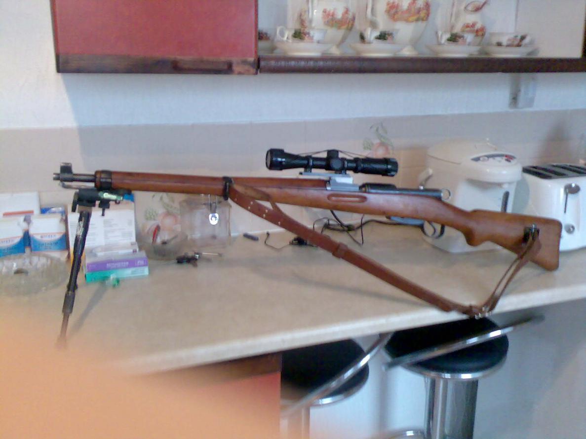

    scope onto Schmidt Rubin K31
    I know that most people like to keep these rifle,s as is,But i am know near 70 and have the start of Cataracts. So no option in the UK shoot the gun or give it up to Plod along with My certificate.that last one is sticks in the old throat as My certs started in 1958. So not wanting to butcher an old classic i made a block to fit the rear sight base only retained by the original pin with scope mounted, shimmed into center ,and to go back to iron,s only got to knockout the pin remove scope ,block,rings et al .The real joy of these guns is the way in goes the rear sight and give to My young Nephew and at 600 M He blew out the V bull, out 10 shots 9 in the v bull I cannot do that with the scope matey now days . still if it goes bang i,m happy.cheers 12 bore
