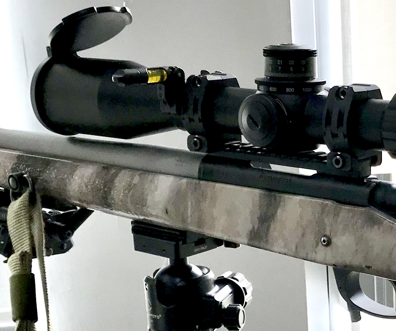

I have a K624i on my rifle with an M40 or MTU contour (I forgot) mounted in ARC low rings at .94 to centerline and i have a little room.
Tenebraex caps and ARC Low rings. I have the medium rings but this seems to feel good and haven’t tried the higher position yet.
Scope cover might be a tight squeeze.
