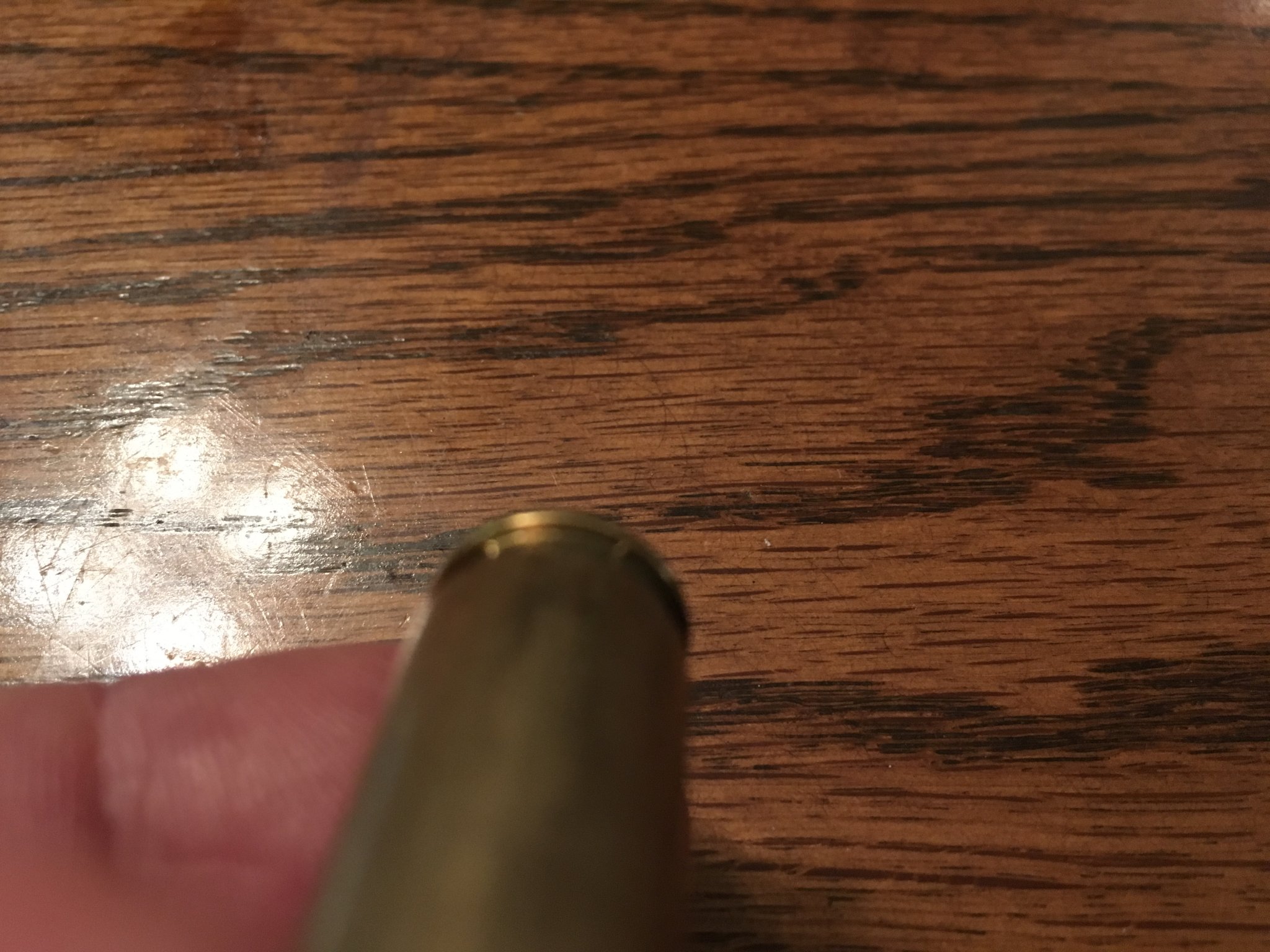

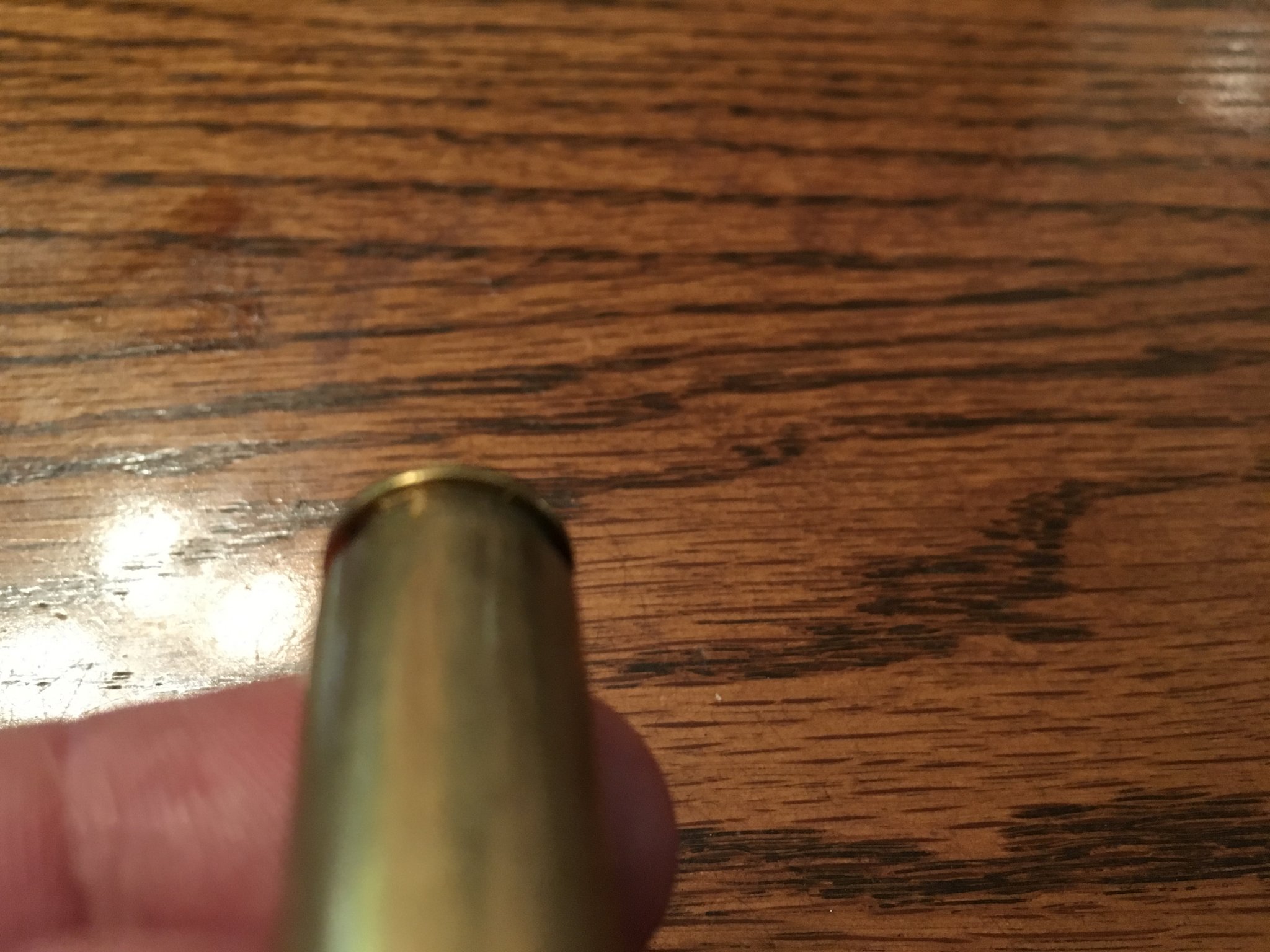

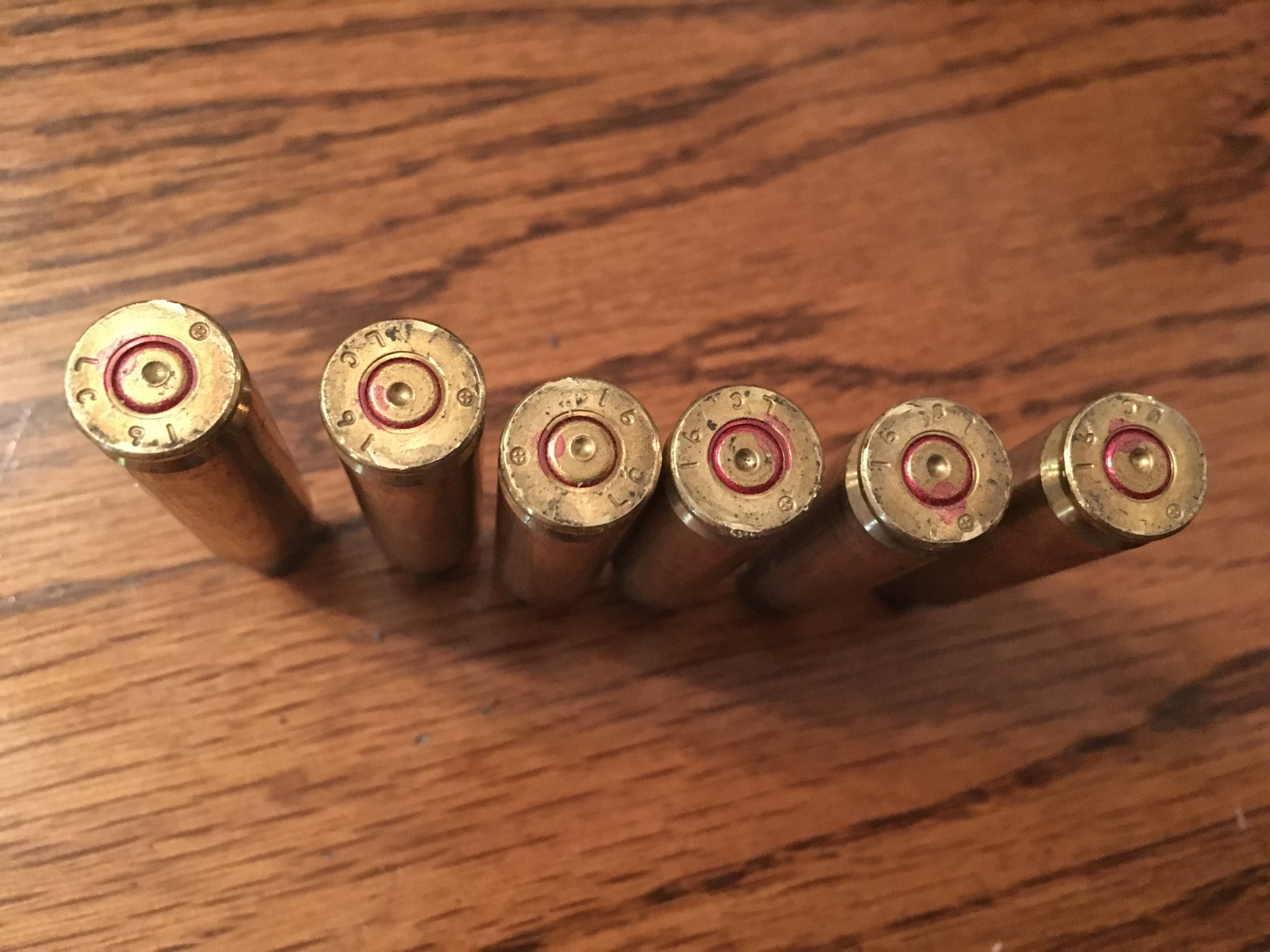

The extractor is polished to eliminate sharp edges. Some slight deforming the rim but primarily flat. Ejector smear on the rear of case. I will have to dig up some cases to get pics. By the way it is M118 SB. Not
M118 LR.
Pics of affected cases. First pic is of ejector swipe second of extractor marks, best pic i could get sorry

The extractor and ejector marks aren't bad. The unlock timing looks only mildly off. Have you tried reducing your gas a few clicks?
Reactions: bfoosh006
One click above lock back. I would like to eliminate the bur on the outside of the rim in case i want to reload them as i have a good supply of M 118 173 gr Fmj bullets.
Reactions: GhostFace
To save money, I would go reduce gas to the setting you get for exact lock back (assuming you're using the restrictive gas mode on the Superlative) especially if your brass was ejecting forward from the ejection port (1-3 o'clock ejection) for a summer (high ambient temperature) setting and then increase gas one click for a winter (low ambient temperature) setting if necessary.
If your current AGB setting is resulting in the 3-4 o'clock ejection, you can do a combo gas/mass tuning which is go up in buffer weight whether it's making a custom buffer (KAK sells internal buffer weights) or go up to H2, H3, etc. and then retune gas again from there, but this costs money.
The click increment resolution for the Superlative AGB is possibly too coarse for your gas port size, total reciprocating mass and ammo combo which is resulting in an "optimal timing" being an in between click setting.
