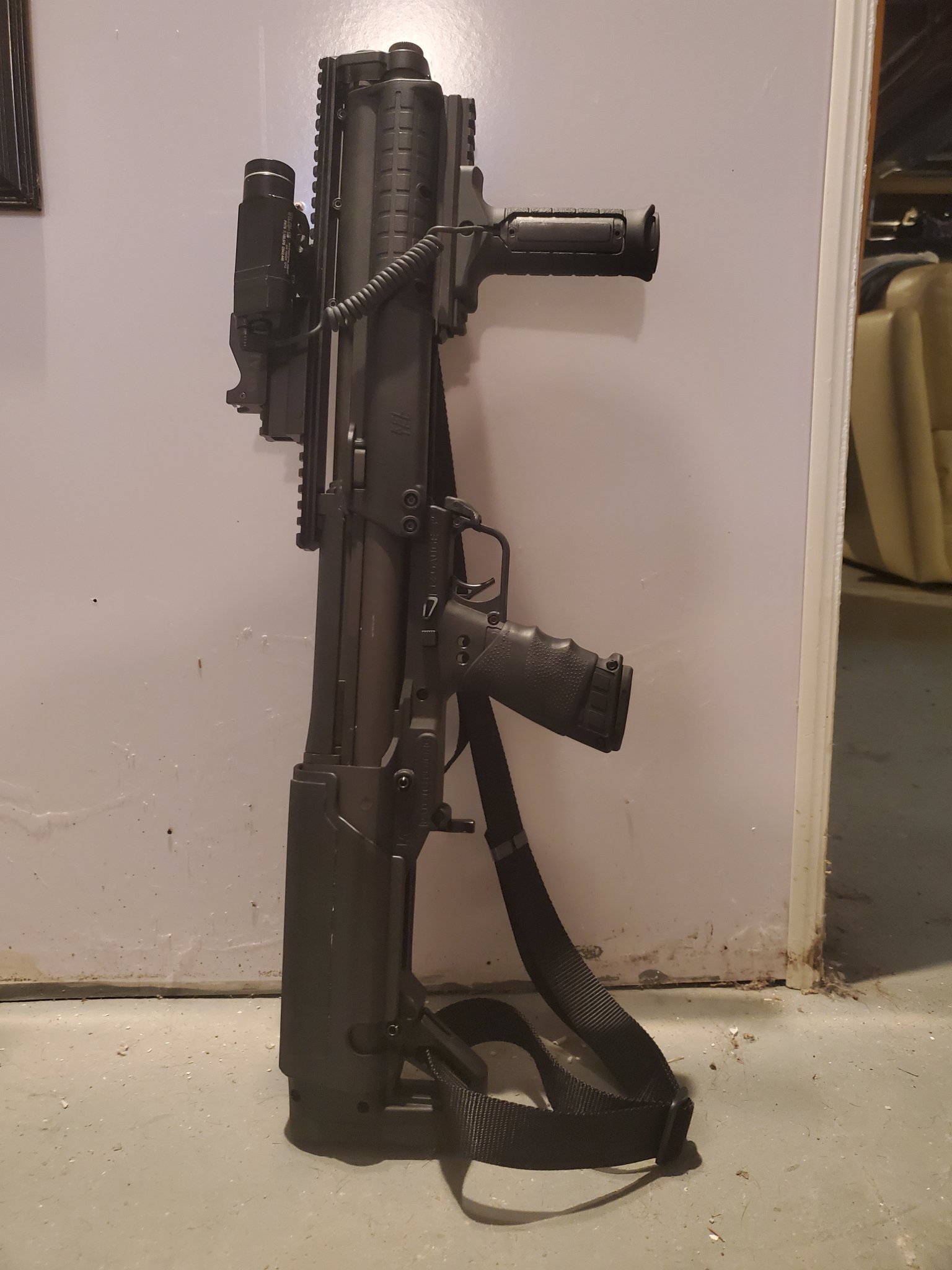

I'm cycling 2 3/4", 3" & minis without issue. But I did some extra work to mine. Replaced the tube followers with Teflon coated stainless followers, new tube springs from Wolf, extended tube selector, put an aluminum rail over the plastic rail (find an aluminum rail with a long attachment do it doesn't put all the pressure on a small area), vertical foregrip with cutout for a pressure switch that goes to an offset TLR-1 that's mounted on top, kydex cheek piece with a thin rubber pad over it, new trigger from mcarbo, sling, and probably something I'm forgetting. I have difficulty leaving things stock. My wife hates that about me.
Here's a picture. Also forgot to mention that the Hogue overgrip was a real pain to get on, but I like it. If you're going to do the trigger, do it before putting the grip on.

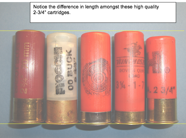

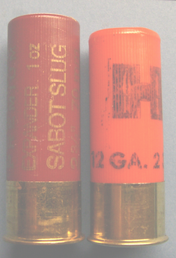

A general PSA- for shotguns whether 2-3/4" or 3" it is not a reference to the length of the unfired cartridge. It IS the length of the fired shot shell cartridge when it opens up " to acceptable length", so both the chamber and the ejection port will accommodate the cartridge firing and ejection port process. It is also the reason for the observation that unfired mfg. cartridges are not of equal length, so some complain that their magazine capacity cannot hold 6 shells, when the manual says so, but only 5 shells can be loaded. Any 3" chambered shotgun will manage 2-3/4" cartridges. The extraction / ejection process occurs at the back end of the cartridge......the shotgun doesn't know the difference unless you attempt to eject a 3" cartridge from a firearm with a 2-3/4" dimension-ed chamber/ejection port . That said, an insufficiently lubricated system or underpowered 2-3/4" cartridge may be inadequate to cycle a semi-auto loader.
