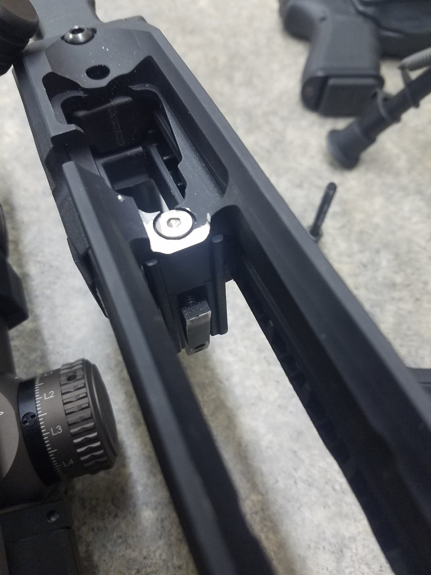

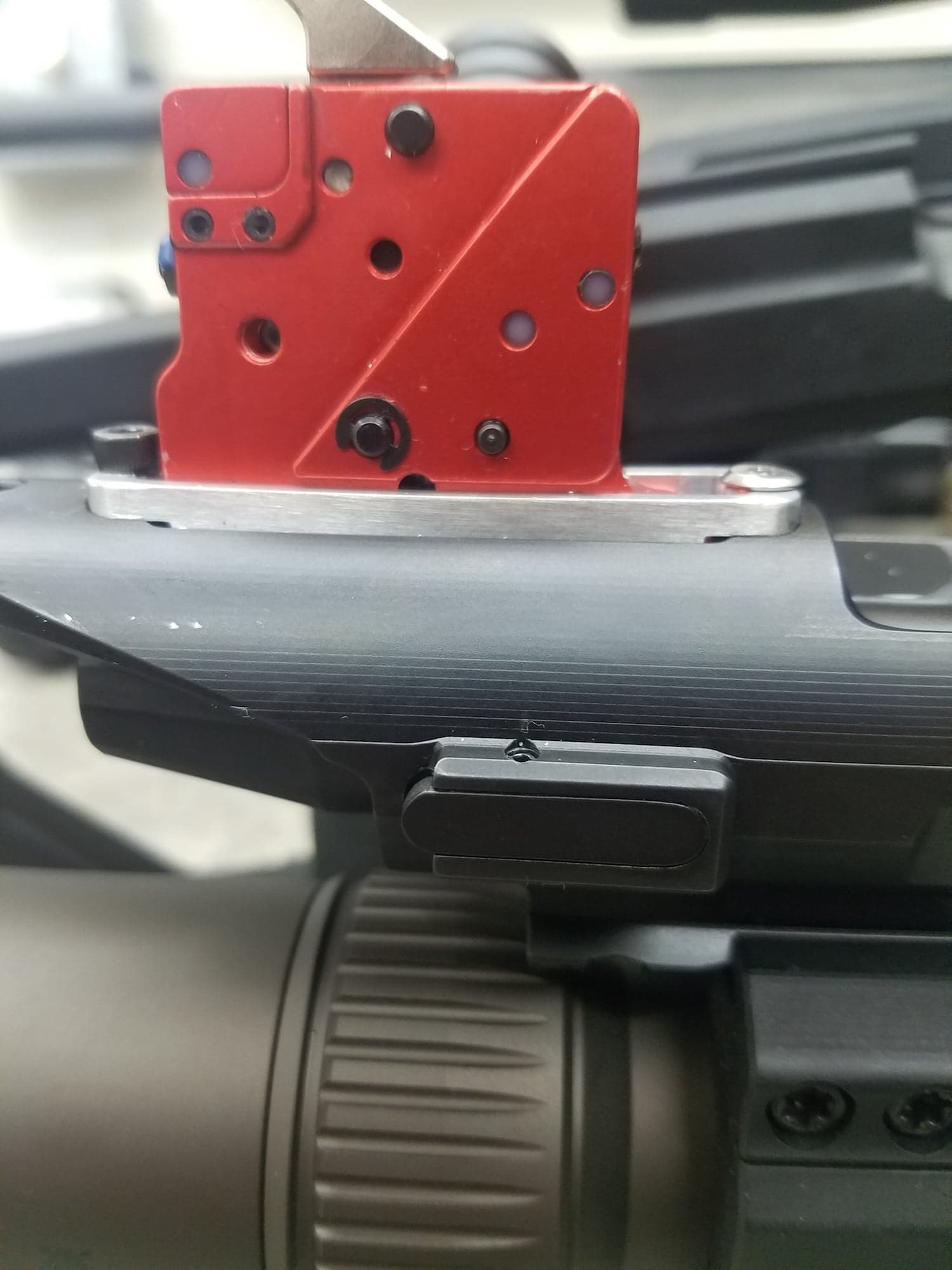

KRG emailed me photos of mods done by customers to accommodate an Atlas Tactical. Thoughts?

That is not an atlas.
I'll have to look at mine again but it did not seem as if there would had been enough clearance just to countersink and run a flathead. Also the atlas will run closer to the rear action screw, but very doable to clear.
Actually... The email I received back from them stated these are "pics we've received from customers who have performed trigger hangar mods."
The primary issues I see are that the SHCS on the front of the trigger hanger has been ground down to nothing and could be easily rounded out if it's even still usable and the one in the chassis isn't far behind it unless it's the angle I'm looking at it.
