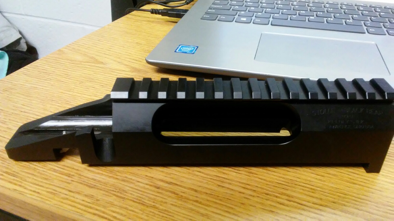

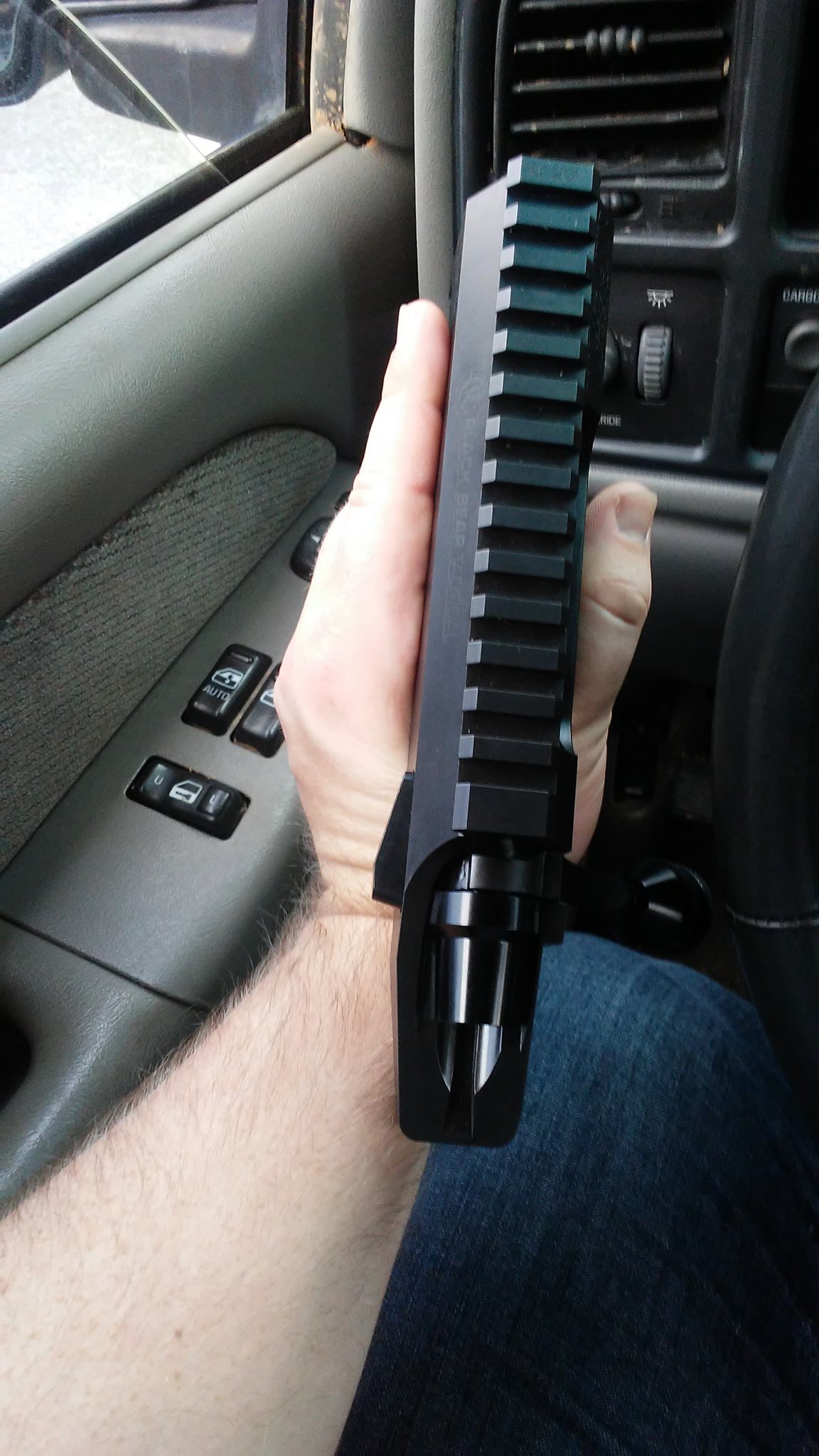

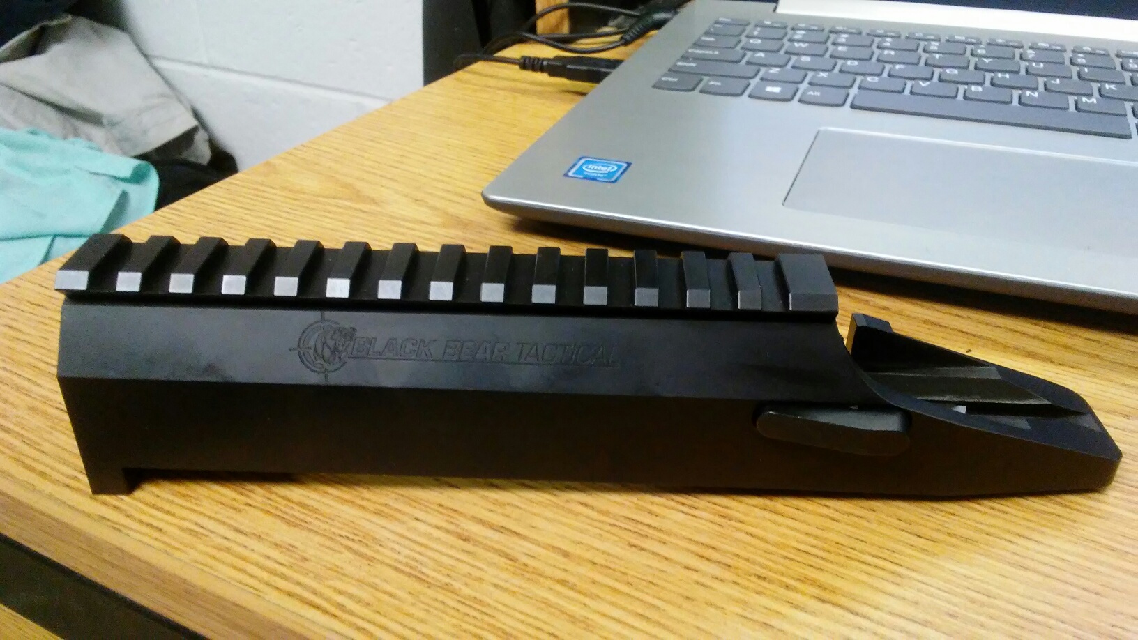

Just received the Black Bear through my local FFL.

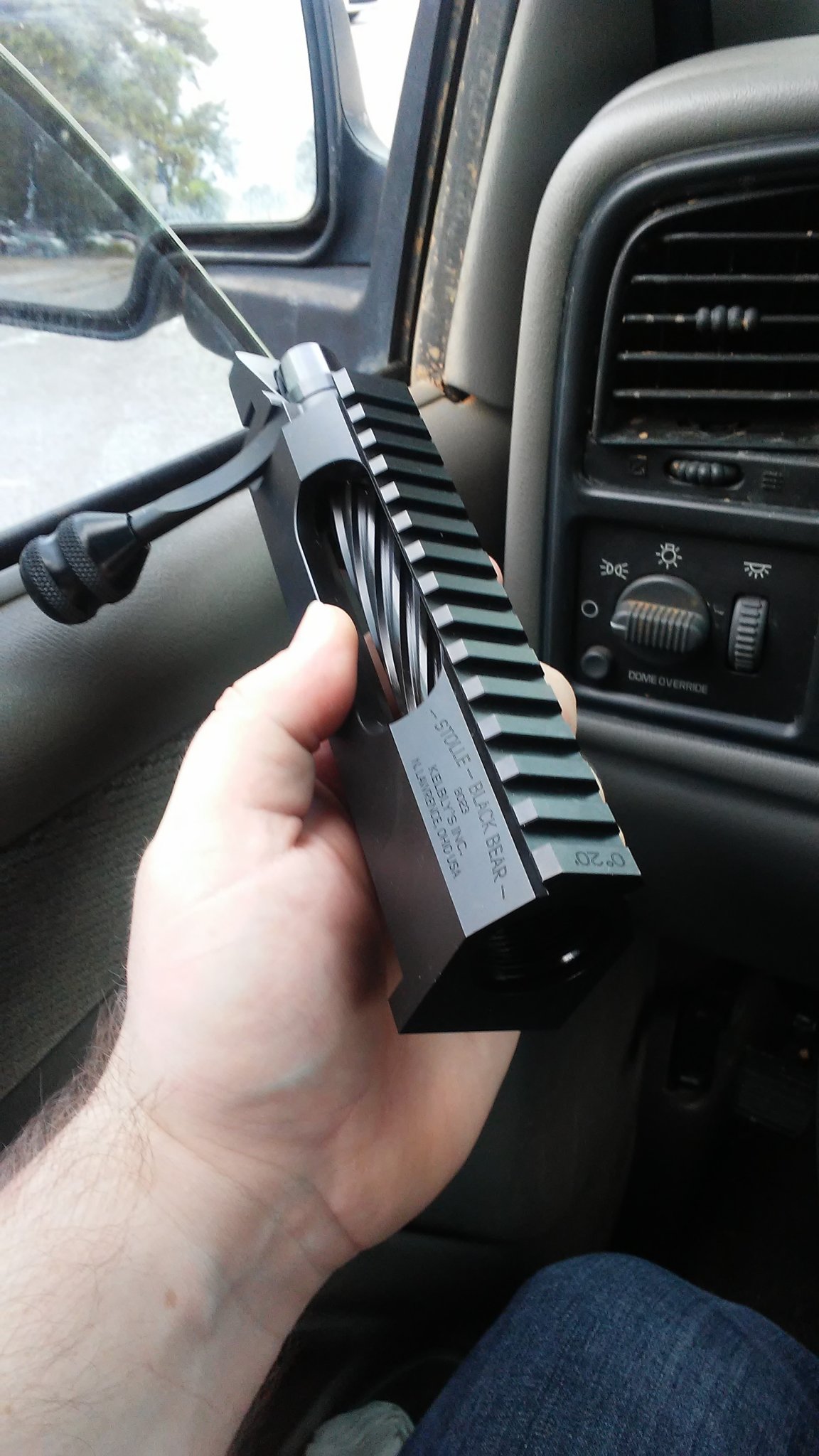

Initial impressions are that this action came to party, and its going to be hard to have initial negative statements (until I get the rifle completely built). I've shot dozens of differnent actions (Atlas Tactical's, Defiance's, Ultimatum's, Stiller's, GA Precision's, Trued Remmy's, Savage's, RPR's, Sako's, Steyr's, Cadex, etc) so I feel I have a decent amount of knowledge to judge an action, even though it is my own personal opinion and I understand that.

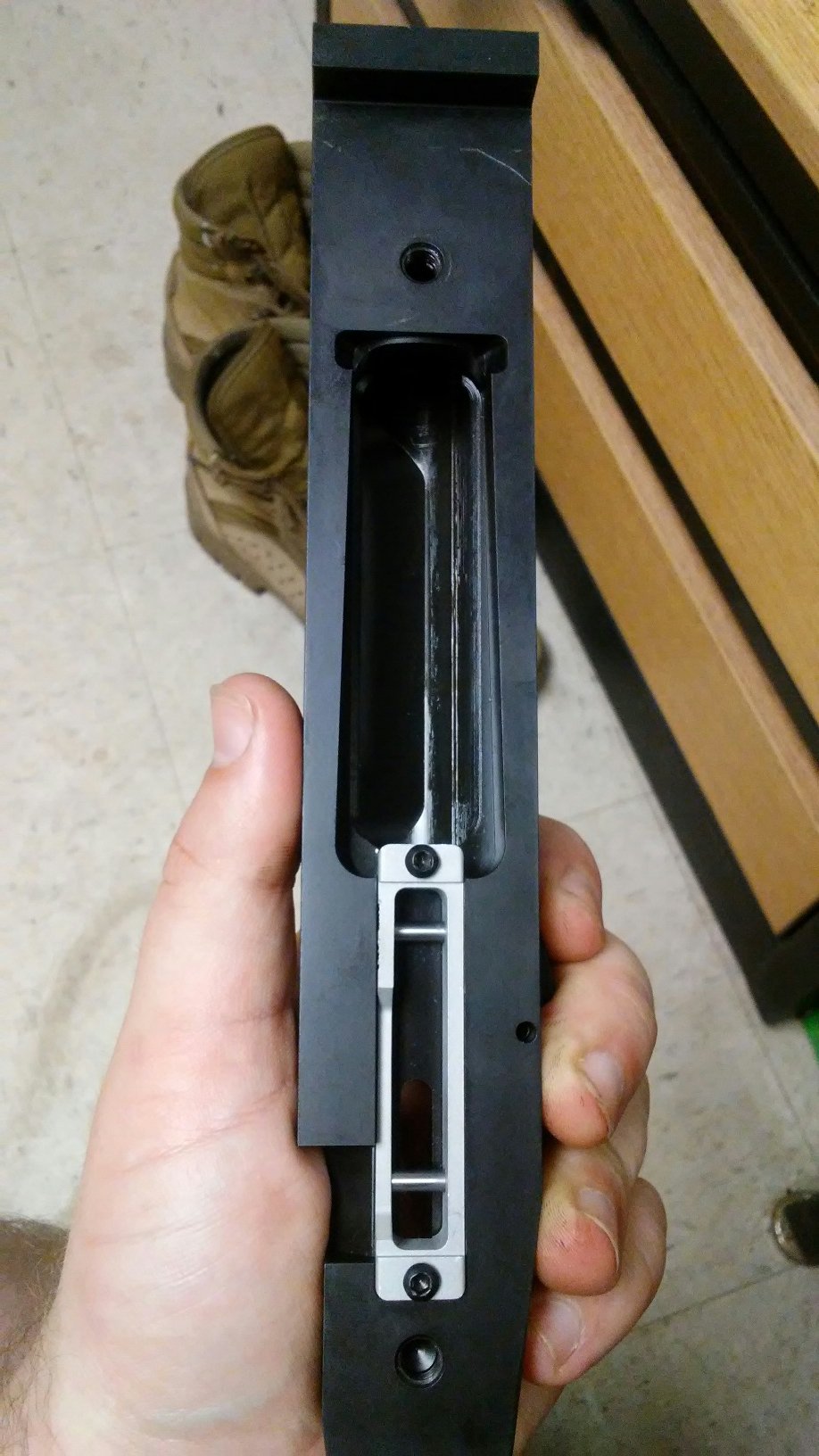

The receiver.... Large and machined EXTREMELY well. I ran an initial test with a couple dial indicators to check concentricity, if all of these actions come as mine has, they're all going to be within 1-2/10000th's of concentric to the centerline of the action. My dial indicator didn't move when I checked the tenon and machined threads. OUTSTANDING. Flat bottom design which isn't the norm for tactical rifles unless you talk about the Badgers and some European stuff. The tolerances are very tight, but not overly to allow the action to properly cycle. The nitride finish is as expected, deep and smooth.

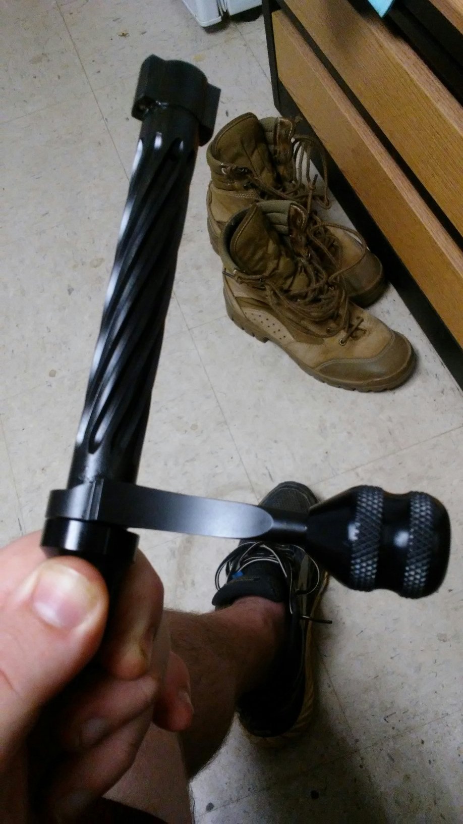

The bolt.... It's a work of art. Spiral fluted, 2 lug design, with a long bolt handle and knurled tactical knob. Feels great in the hand and the force needed to throw the bolt is much less than I expected. This is 100% the smoothest action I have ever touched. I thought an Atlas was smooth... the Black Bear steps it up. The only thing I can really compare it to, is benchrest actions. Stolle's (which I understand is Kelbly's), Bats, JJ Rocks, etc. Its crazy to think of that smoothness coming from a tactical action. Not to say there aren't actions out there that are super slick, but the Black Bear makes a lot of my other rifles feel gritty and sticky.... Kelbly's claims they don't have to run any lube on the bolt and it gets even better as it wears in, so I'm interested to see just how that's gonna be.
Large oversized side bolt release/catch.... The thing is massive. I have no reason to believe I will ever have a failure with it... ever. Its that substantial.

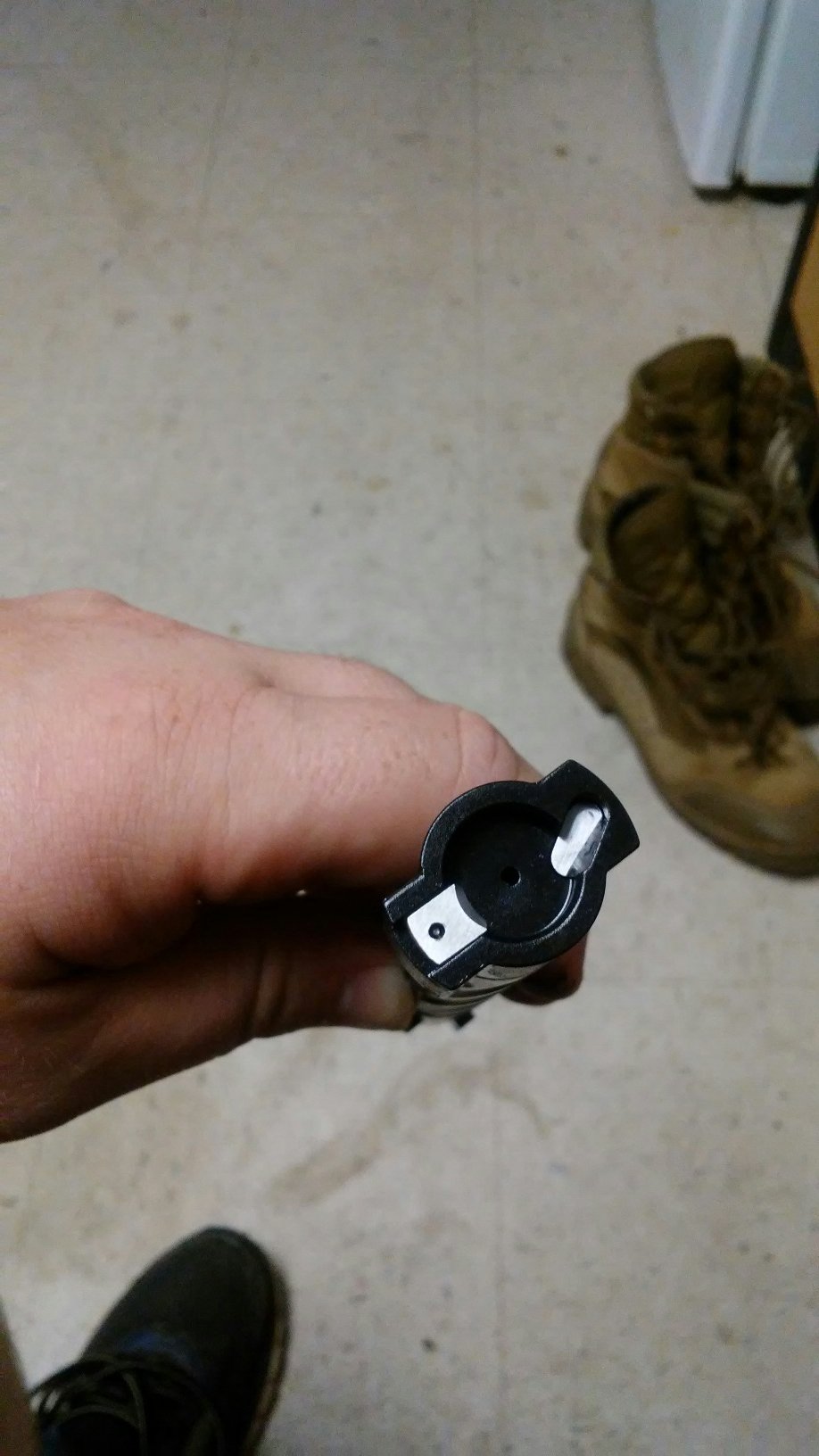

Mechanical Ejector.... Kelbly's hit a homerun with the TG ejector on the Atlas's so I knew it would be the same on the Black Bear. Still need to test it with the rifle built, but overall I have reason to believe I'll have any issues with it. Plus, it prevents short stroking the bolt and if you wanna be soft with your ejection, say at the range while doing load development and wanna look at each primer instead of hunting for it, you can. That's a personal gripe, so your view may be different. Its a plus in my book.

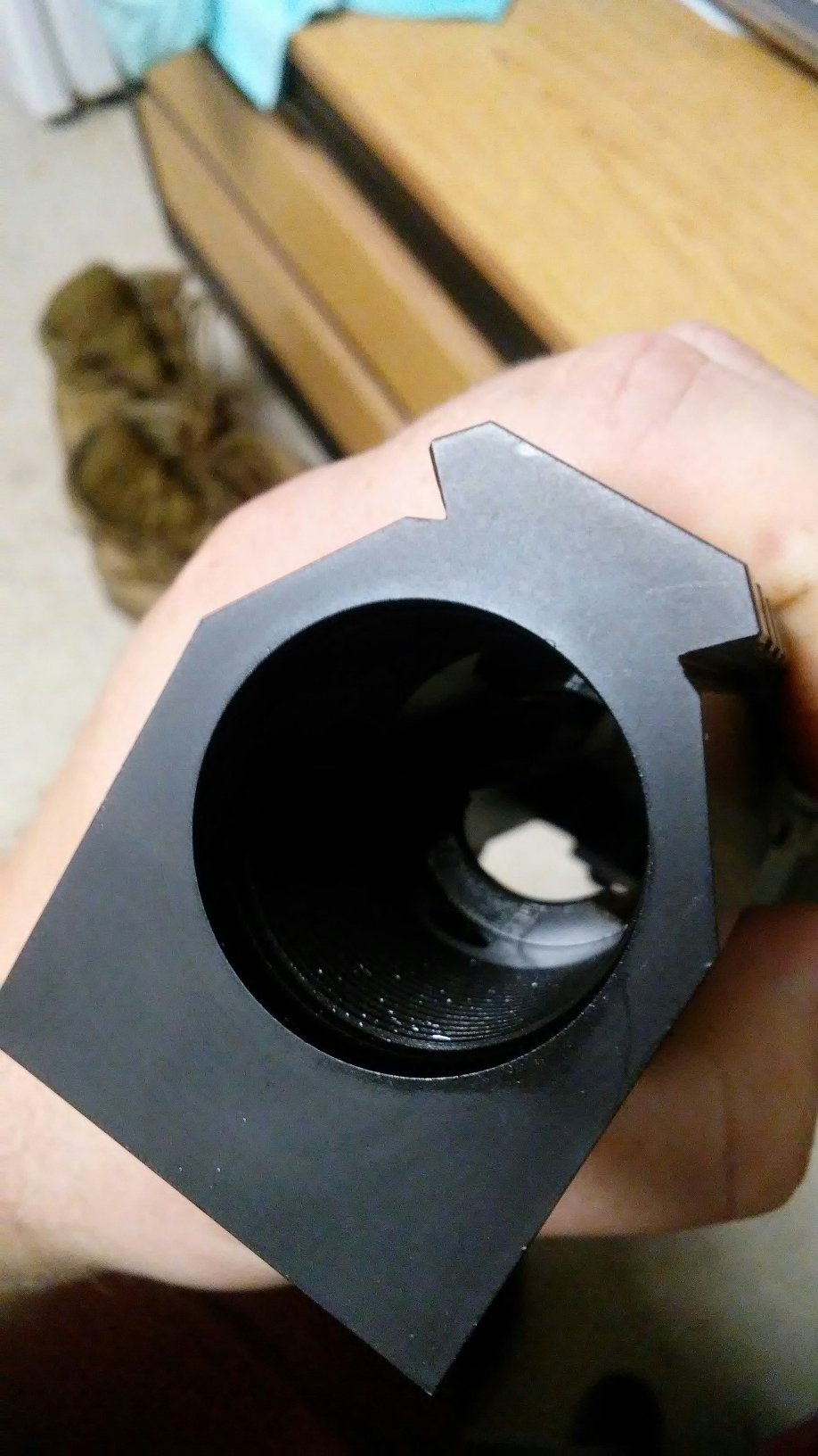

Integral recoil lug.... This isn't anything knew to the industry, but it makes my life a lot easier when I spin a barrel for this thing. The lug is large and pronounced, but not so huge that it will make an issues with the coming bedding. Its at the front of the action vs being set back slightly. Now for me, I always questioned with certain actions if setting it back slightly would effect the tension in the tenon area and possibly add stressors to it. I'm not a machinist, but I do all of my own guns, so small things like that creep in the back of my head. I've never had an issue, just always wondered. With the Black Bear, I wont need to. Its where it's traditionally been for decades.
Ejection Port.... One word..... Massive. Largest ejection port on a tactical action I've messed with.
Trigger Hanger... When I got to the point of putting a trigger in it to check the drop and cocking, I already had a really good vision that this was one of the best machined actions I've ever touched, but then came the trigger hanger. I love trigger hangers. Super convenient, super easy, and makes life a lot simpler. You can tell Kelbly's has been doing this for a long time. The hanger is set in place by two set screws and two pins hold the trigger within the assembly. When I pulled the hanger out of the action, it felt like it was almost a press fit. The machining was tight but not a pain in the ass to mess with. The pins were what caught me off guard. Kelbly's took the time to machine pins that are almost exactly to the dimensions of the pin holes... I don't know if any of you have dealt with hangers before, but I hate it when I pull one out and the pins basically fall out. I don't know why, I understand there's no room for them to go anywhere within the action, but the though makes me cringe. With the Black Bear, that's not gonna happen. The pins are tight and will not move unless you force them to....Top notch!
Machined 20MOA Picatinny Rail... I like a machined in rail. Some guys don't. Some guy's enjoy a pinned/screwed in rail. To each his own, but I like simple. I like reliable. With this, you don't have to worry about something not lining up correctly, or not having the screws torqued. My gripe is, you've spent all this time and money developing an action to sell to the public....just like a mechanical ejector....DO AN INTEGRAL RAIL. Its fool proof.
Overall, you can probably tell by my initial views of it, the Black Bear is ridiculously good. I'm looking forward to getting this build done, which in all hopefulness will be before the end of the month. I have super high expectations based off of the first look and testing it's function/fit and finish.

Here's more pics of the Black Bear showing more if its details. Pay attention to the tenon area paragraph, I think a lot of readers will be surprised by it.
--Massive ejection port with machined in 20 MOA Rail and large sturdy rear tang.
--Flat bottom receiver body, large magazine cut, and two screw trigger hanger design.
--HUGE bolt release/catch, integral recoil lug, and super smooth nitride finish. Very appealing to the eye and feels great in the hand.
--Tenon and lug area's are machined flawlessly. Kelbly's is one of the only companies that can keep tolerances tight enough, to were when you order your action, you don't actually need it to thread your barrel. Yes. I said you don't need the action. The tenon on each and every Black Bear and Atlas is so exacting, you follow the tenon blueprint provided by Kelbly's and spin your barrel. This saves a ton of time and money for the end user and allows the barrel to be waiting on the action and not the user waiting for the action, then gunsmith to spin a barrel. HUGE thumbs up.
--I love flutes. I don't know why, but visually they appeal to me. The bolt on the Black Bear is beautiful. Nice deep flutes, long bolt handle, and a knurled knob that feels really well in the hand. In the action, cycling is the smoothest I've felt.
--Taking a closer look at the Kelbly bolt face. Now some people would say, "Oh, its just a Remington clone bolt." and technically you would be correct, except, a Remington extractor and ejector setup isn't nearly as reliable as this. Does it share the traditional 2 lug design, absolutely, but that's basically where it stops. The TG ejector system, is simple, but perfect. It's virtually fail proof. There's no spring adding tension to the back of the cartridge, so headspacing a barrel with a go/no go gauge will be much easier, and will ensure your round isn't being canted in the bore left or right.
-- More to come as soon as I get my stock in, which should be later this week.

The TG ejector is a fully mechanical set up, where the bolt has a floating piece that rides in a groove within the bolt face. Best way I can describe the piece is kinda like a small ram that gets pushed forward when the bolt touches the bolt catch. The catch has a small blade built into it, which catches the back of that ram and forces it forward, which creates pressure on the round and sends it out the ejection port. Its sounds complicated, but its ridiculously simple and fool proof. I wish I could get a better picture on the inside of the action to show the blade.

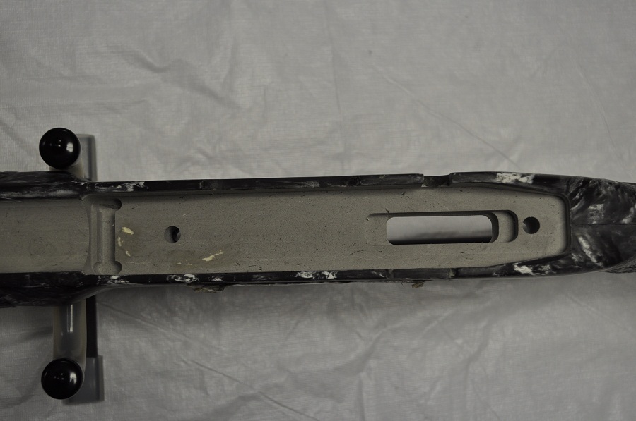

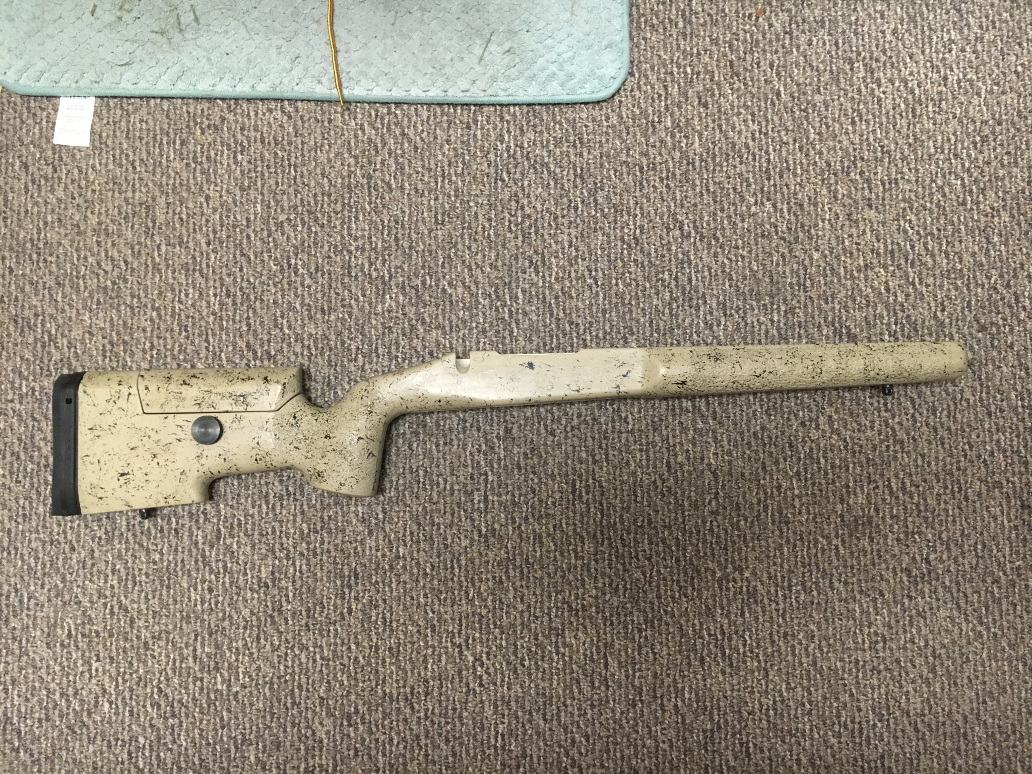

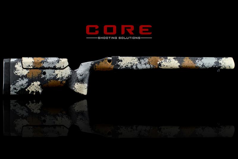

Changed my mind on the stock I'm going with. Instead of running a PRS 1/2, I bought a T4A elite from the guys down at Core. Made the decision to switch because I wasn't a fan of how wide the fore end is on the PRS and I wanna do an EFR set up so the the meat at the front on the T4A is perfect. I've been running a McMillan for the past year, and I like it, but I think the Elite is gonna be a lot better...

That's 100% why I went decided to get the T4A over the PRS. The angle kinda threw me off and the width was a little much for me. I'm in love with my AI AX chassis, just because it fits me better then any traditional stock but I'm starting to come around to them. I felt kinda bad getting a Manners when I already had a McMillan A5 I could've used, but with the little added weight of the Black Bear, the carbon will help even it out. Plus Core's new camo colors are just badass.

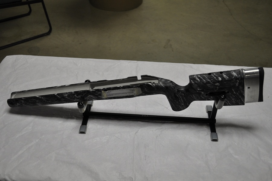

Is the inlet change from a Rem700 to Kelby Black Bear as simple as going from a round to flat/square bottom? Does the pillar length remain the same?
Screw spacing is identical to a tradional REM 700 length, but as far as I can tell, I may need to shorten the pillars slightly but not by much. I'm about to inlet a Rem footprint Manners for the Black Bear here shortly (within the next week or so) and will give more info/pictures to show what's needed to do it. I've got all the action blueprints and depth dimensions from Kelbly's and it looks to be pretty straight forward. If I read the blueprints correctly, retaining the overall depth for the recoil lug and working backwards from there, the inletting should be very simple. Mill the inlet slightly wider for the Black Bear and start at the recoil lug and work back making it flat instead of round.
The only real area that's significantly different (other than the flat bottom, which I understand is a departure from the norm) would be the tang area. The tang on the Black Bear is much larger than a Rem or clone Rem.
Based off of what I've been talking with Ian about, the inlet should look very very similar to this, with the only difference being the M5 cut for DBM:
(Don't pay attention to the barrel channel, that stock isn't set up for tactical contours....)
Also, after looking over the action and inlet blueprints, expect to either shorten your traditional action screws for the 700, or ask Kelbly's to provide action screws when you order your action. This is specifically for guys wanting to convert 700 footprint stocks to the Black Bear and not wait on Manners or McMillan to build their stocks out and provide action screws to them. If you're planning on running an MPA or XLR chassis with the Black Bear inlet, those companies SHOULD provide screws as well.
I picked up the a Manners T4A Elite from Core last month and I'm with you. I prefer it over the McMillian stocks.
Off topic but.. where did you get that stand?
That's actually a picture from Kelbly's webpage, but Ill be with Ian and Ryan this weekend and Ill ask for you bud.

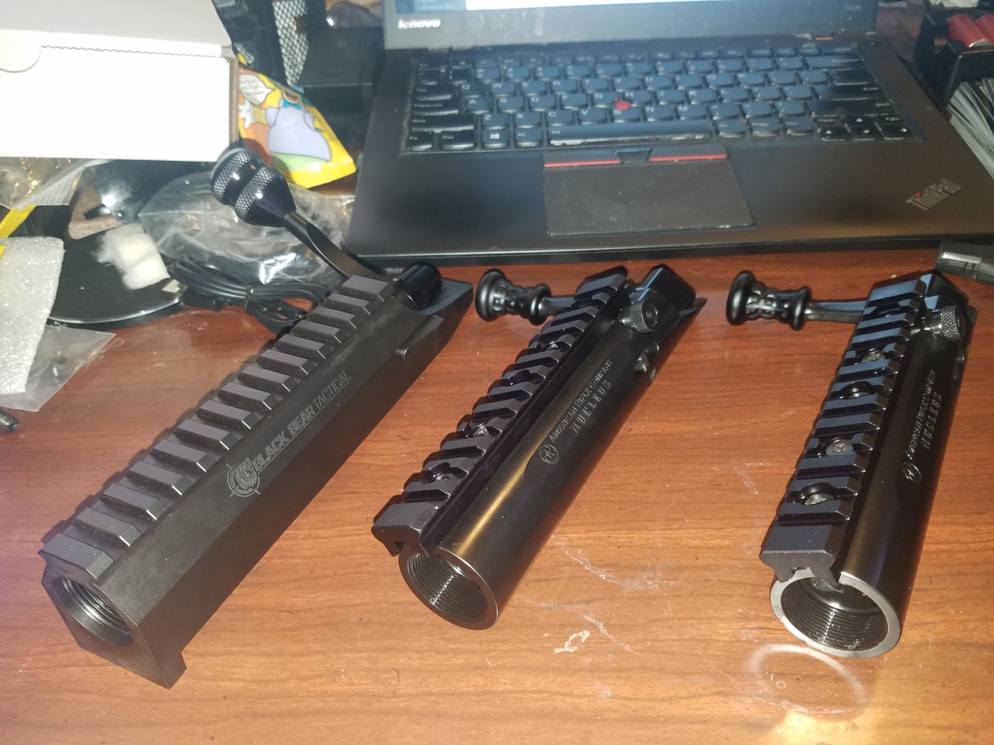

Like Christmas today. Got 2 nucleus and black bear sn 26 in today. From initial handling I'm wondering if I should sell the nucleus actions while they are hot and get a couple more of the black bears. Will have to play with them some more before I decide for sure though
Reactions: FollowThrough10
The black bear looks like a tank next to the nucleus actions. Can't wait to see a finished black bear build.
