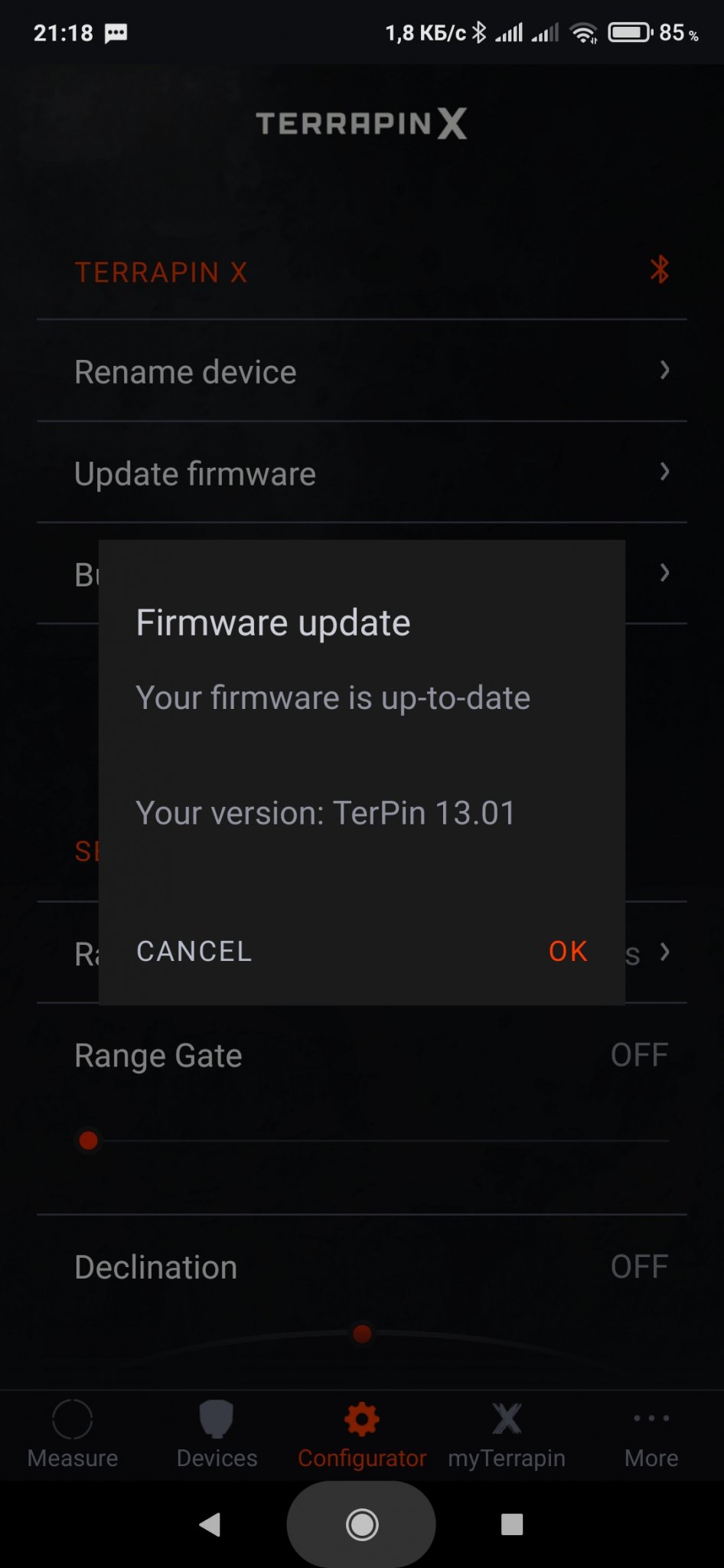

Firmware is latest.
Reactions: Lite

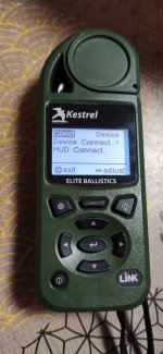

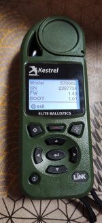

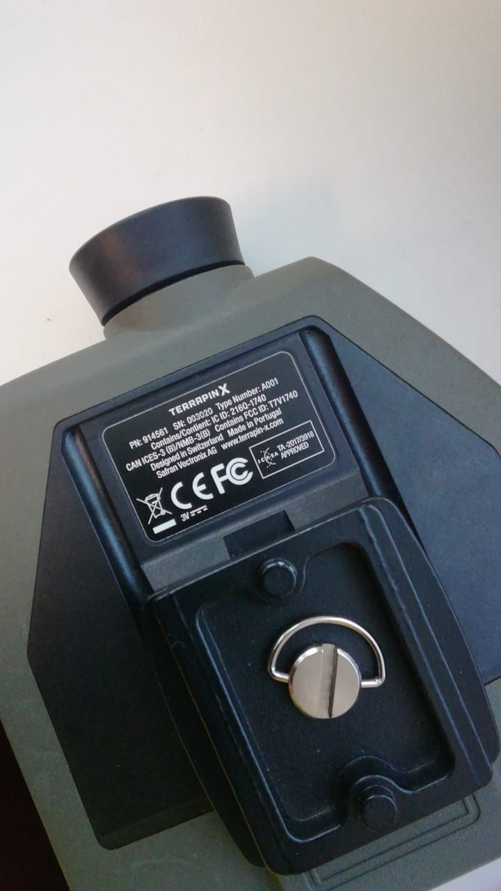

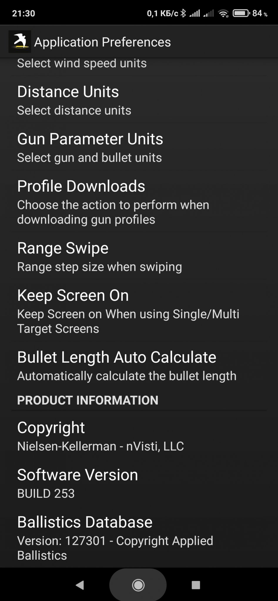

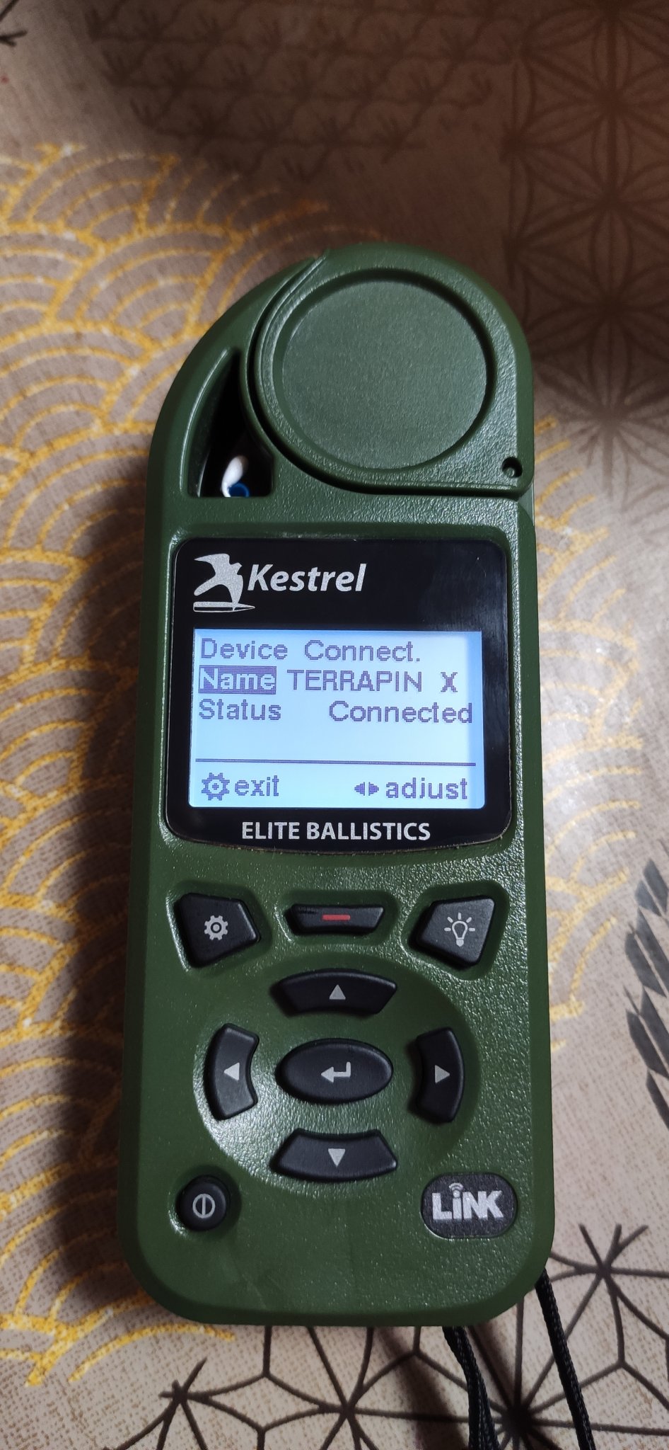

My Kestrel doesn't work with Terrapin X. I don't know why.
Did you remember to put the Terrapin X into "Kest" mode? You probably had it in App mode to talk to the smartphone app.
My trick to get it to work in the field was to switch the Terrapin from Kest to App, then from App back to Kest and it would connect. So I got very good at switching modes. Not ideal and I'm using another LRF for now until this gets resolved.
Yes I did.
My Kestrel can't see the Terrapin after wake up. I need to reboot Bluetooth in Terrapin. After that connection is established
P.S. Sorry for my English.
Yes I did.
Looks like you have the exact same problem I have. Thanks for clarifying.

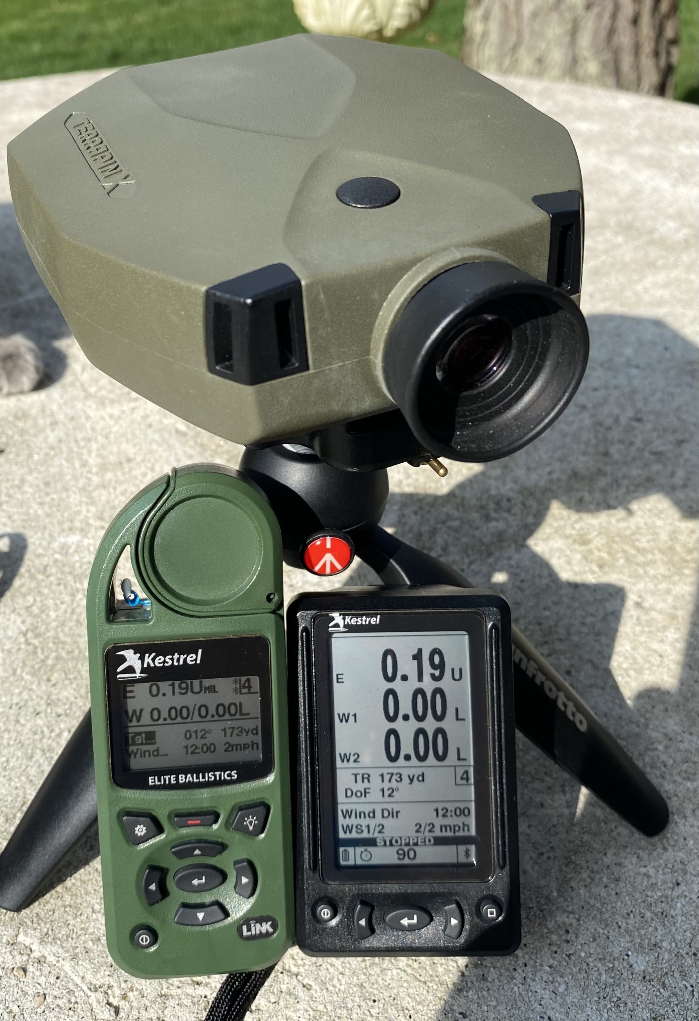

Update: Ran 2 more tests with only the Terrapin X and Kestrel and got the same result. Initial connection is fine, can measure several targets, but once the Terrapin X goes to sleep after about 3 minutes, it won't reconnect to the Kestrel automatically or manually until I cycle the Bluetooth off and then back on in the Terrapin X.
Wish I had better results to report. Here is a photo when all 3 devices were working initially before the LRF went to sleep.

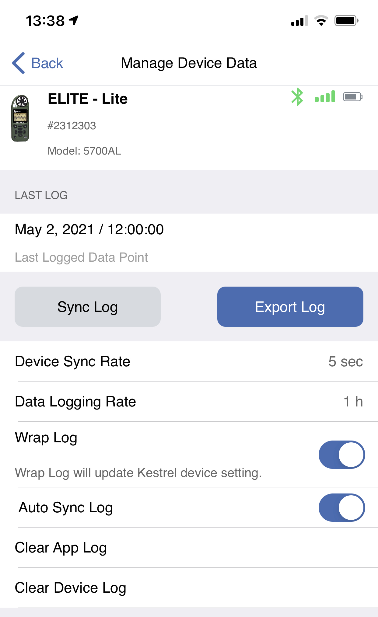

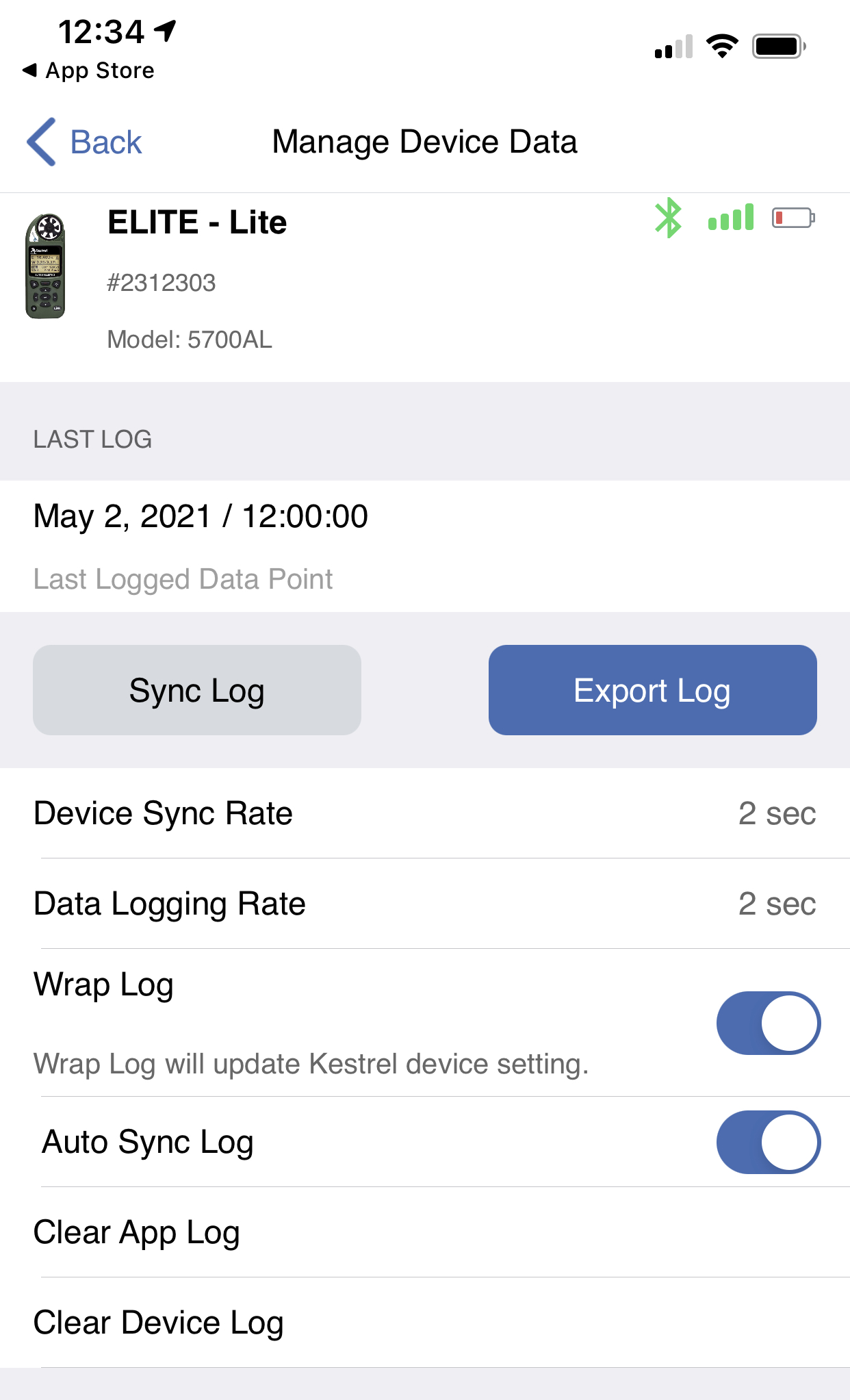

If you have connection problems and have not increased your Kestrel data logging rate to 2 seconds, try this, if this works keep it handy as the logging rate reverts to 5 seconds with a Kestrel fw update.
Yesterday at Coleman's Creek my TerrapinX would not reconnect.
I checked today and my Device Sync Rate was 2 seconds. But my Data Logging Rate was 1 hour!
Adjusted now (see photo below) and will re-test today.
BTW @Kestrel Ballistics, what should Device Sync Rate be and what does it do?
Lite
After factory reset, here are the default values. Hum...
