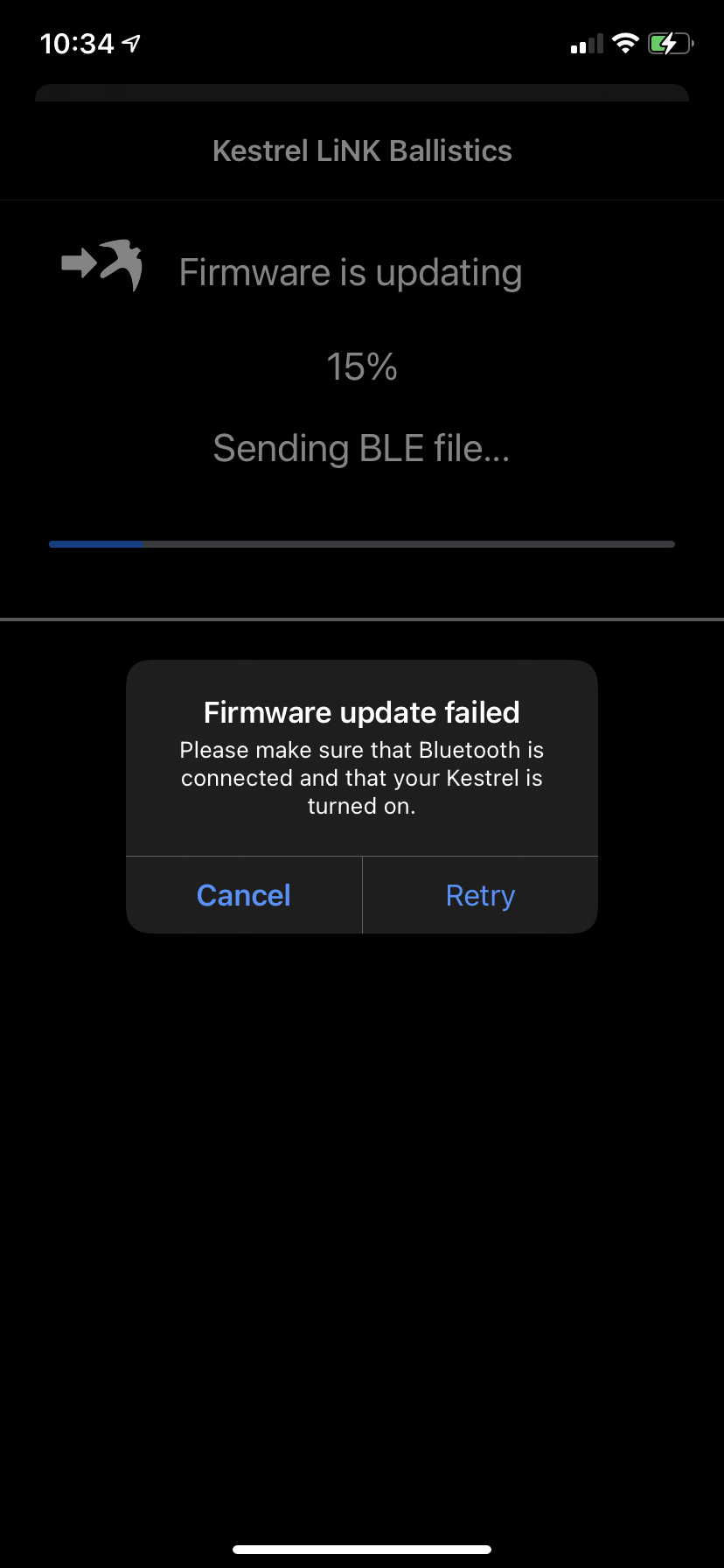

I realize this doesn't change anything ballistics wise, but the update alert keeps popping up every time I connect my Kestrel to my iPhone XR (with latest Kestrel LINK Ballistics). I tried updating the Kestrel, here's what pops up every time. Just FYI.

Please make sure Privacy Pin is off when trying the update. Go into Kestrel->Main Menu->Bluetooth and press the center button and make sure Privacy Pin is off.
