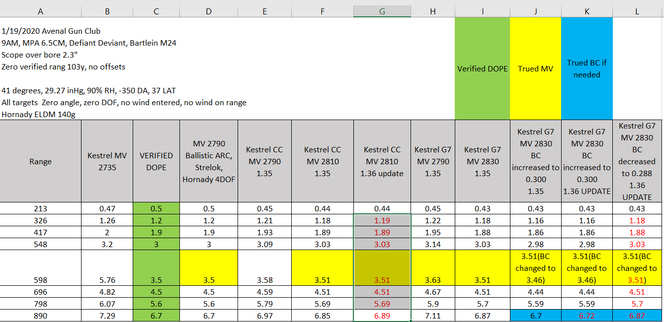

    At the range I used the Kestrel for the try dope(column B), wrote it down, adjusted and wrote down the TRUE DOPE (column C). I did this for all LRF verified ranges, shooting from 200 yards out to 900 yards on steel that was freshly painted and had a water mark. I worked with a spotter and we spotted and verified each others shots on each target, most ranges we each had our own targets, but on the larger gongs we were able to differentiate very easily. I added a drone picture of the 900 yard target.
    Then at home using various apps used the 598 yard target to true up the MV, and this worked well for Ballistic ARC, Strelok Pro, and Hornady 4DOF (column D). I captured all of the environmental data from the session as captured by the kestrel and written down, and locked the Kestrel.

    The new MV for all of these to line up was 2790 and no BC correction. I expected as I have before to go into the Kestrel adjust the MV to 2790 and it would line up as well. This is not what happened and the data was significantly off from 500 yards and out, and I could not get the custom curve to line up at all (column E&F). I created another profile with the G7 BC and captured the results (column I) it was off as well but with MV and BC was able to get it close. As I was finishing this Kestrel pushed the 1.36 update and it moved the numbers as well. captured below.
    The result is I had to move AWAY from the AB custom curve to get any data to line up. I tried the DSF but it had no impact as I believe 600-900 yards is too close for this to have an effect. This is the hardest I have had to work to get my Kestrel to line up with verified dope. Are others seeing any anomalies with Hornady ELDM in the AB SW not lining up?

    I was all done when the 1.36 released this afternoon so I added that data. My worry of sticking with the CC is it will diverge further at 1k and beyond.
    I will use ballistic Arc for my paper dope, and the G7 on the kestrel with the higher mv and changed bc.

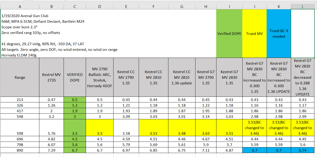

    I just realized the factory reset turned Spin Drift back on and the delta over TRUE DOPE is worse. Any adjustment up more on MV is going to destroy the close yardages.
    Below RED text is modified after turning Spin drift back off. Looks like for the Kestrel, my solution is G7 MV 2830, BC modified to 0.300 (from 0.291).

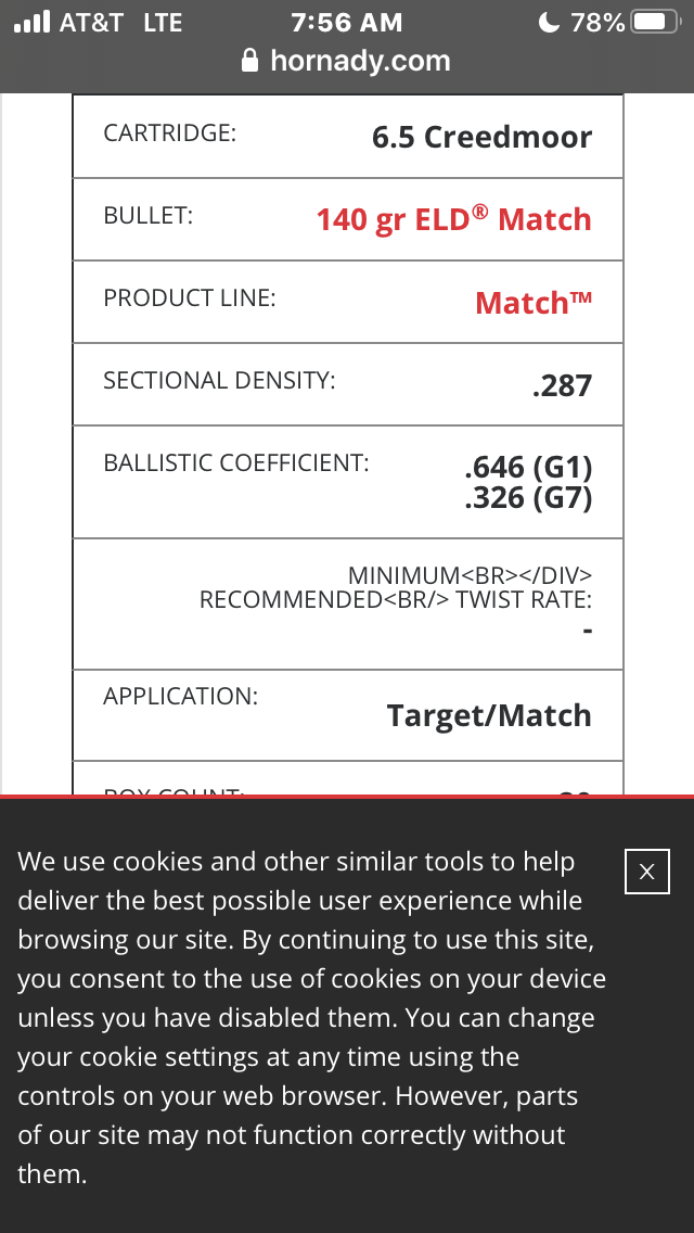

    FYI copied from the Hornady Website:
    6.5mm 140 gr. ELD Match
    MACH 2.25 (roughly his MV)
    0.646 G1​
    0.326 G7​
    MACH 2 (reached by 420y in his DA and MV)
    0.637 G1​
    0.320 G7​
    Gotta say Horndy's Doplar seems spot on to his numbers

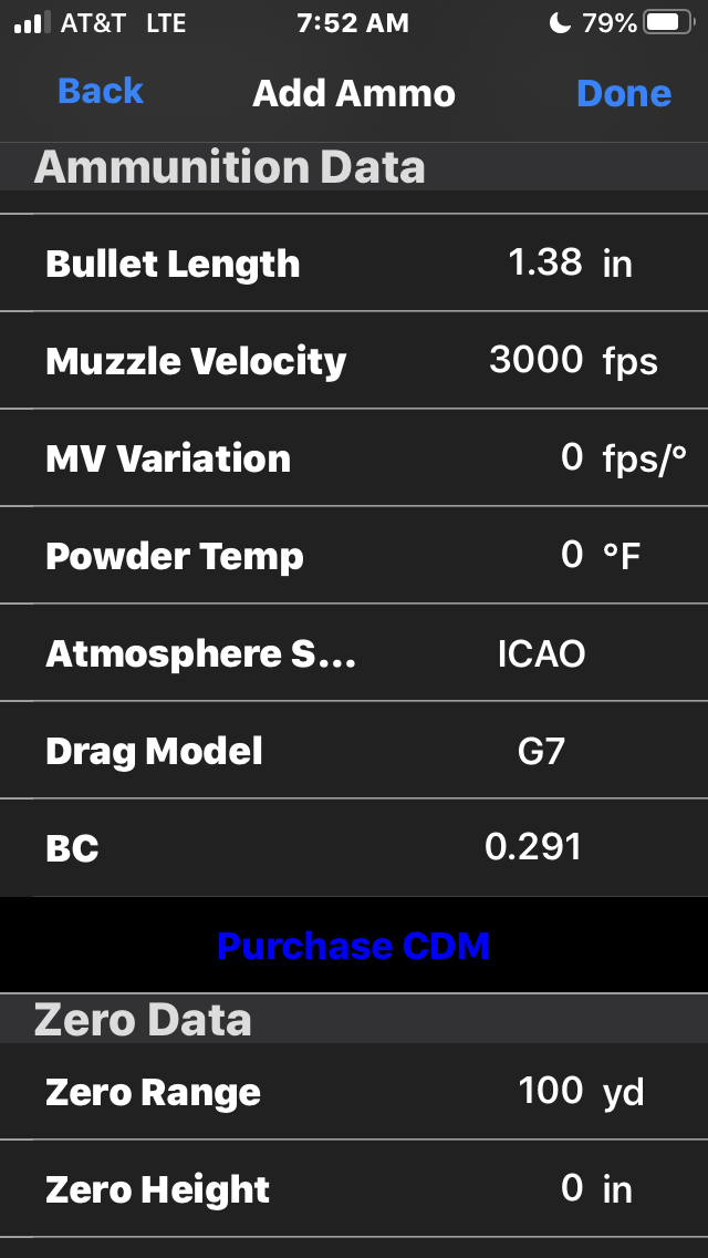

    Would love to hear why AB or Kestrel is publishing 0.291 in the latest library. @Kestrel Ballistics can you help in the source of the BC for 1.36?

    The hornady recommended BC for the 140g ELDM is 0.326 to 0.320, the latest 1.36 library is loading 0.291 which is a pretty large difference.
    I don't know when it changed, @Diver160651 version (he hasn't updated his kestrel) pulled 0.321 I believe. It was seeing in both 1.36 and 1.35 not sure before that.
    https://www.hornady.com/support/ballistic-coefficient

    Hi @DocUSMCRetired can you comment on the Hornady ELDM 6.5CM in the latest library?
    It seems the library has it with a G7 of 0.291 and the custom curve seems to line up with this number. Hornady's website is recommending 0.326 - 0.320 depending on MACH. This is a pretty large difference and looks like the October library release changed for this bullet.
    My trued dope(up in the thread) aligns with a 0.321 BC. The custom curve, or the one default in the library (0.291) could not get lined up.
