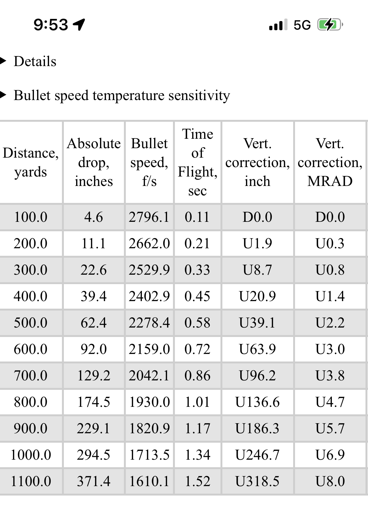

Give us a run down of drops from 0 to 1k, it could be useful to decide where the error is since different values change the drop in different ways.
Ok. I’ve attached the StrelokPro table and I will attach the kestrel when I get back home for comparison.
