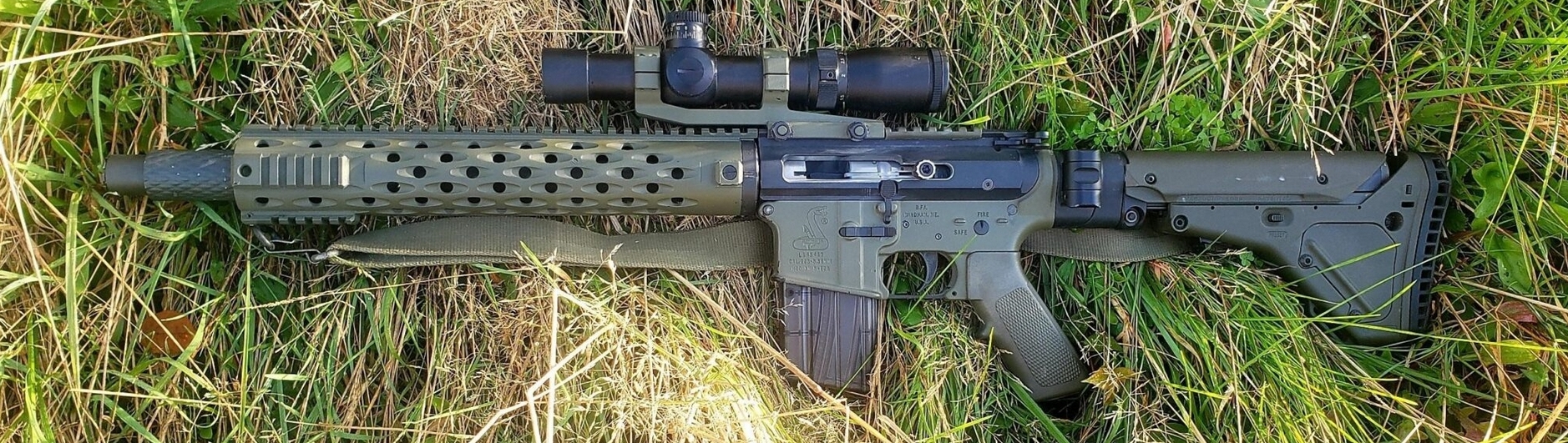

Here one that I built for myself several years ago. I have run several types of ammo through it, but as with any .22 semi auto, the more consistent the ammo, the better the reliability.
The upper needs regular cleaning as well at the trigger group due to the dirty nature of rimfire ammo, but if kept clean, they function surprisingly well due to the aid of the integrated feed ramp.

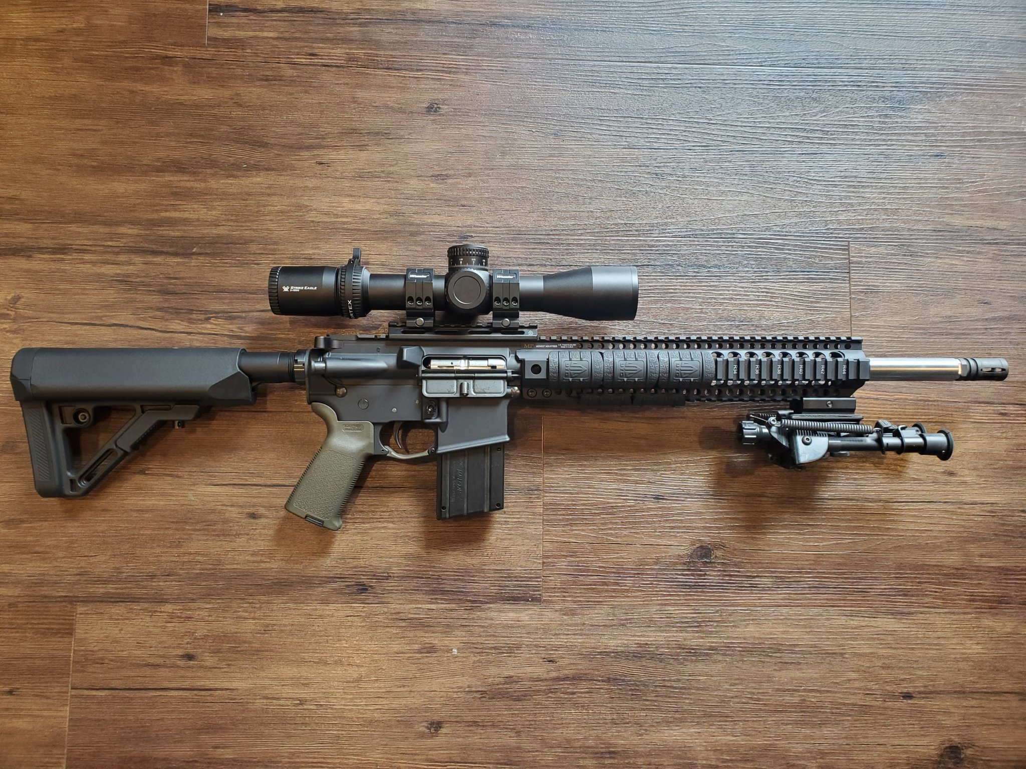

Ok here she is. Keystone Accuracy upper (18" at .850 diameter), CMMG bolt, mil spec upper and CH.

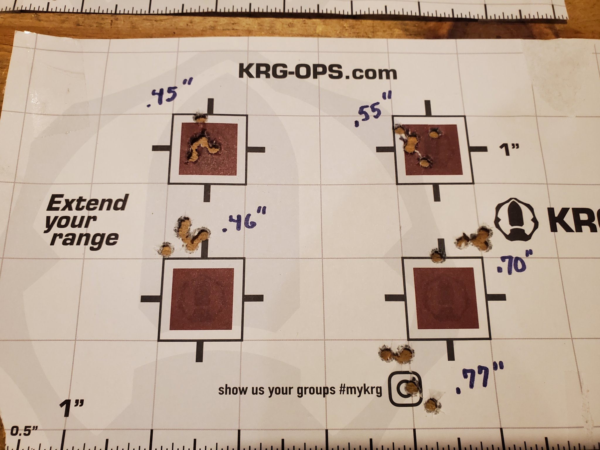

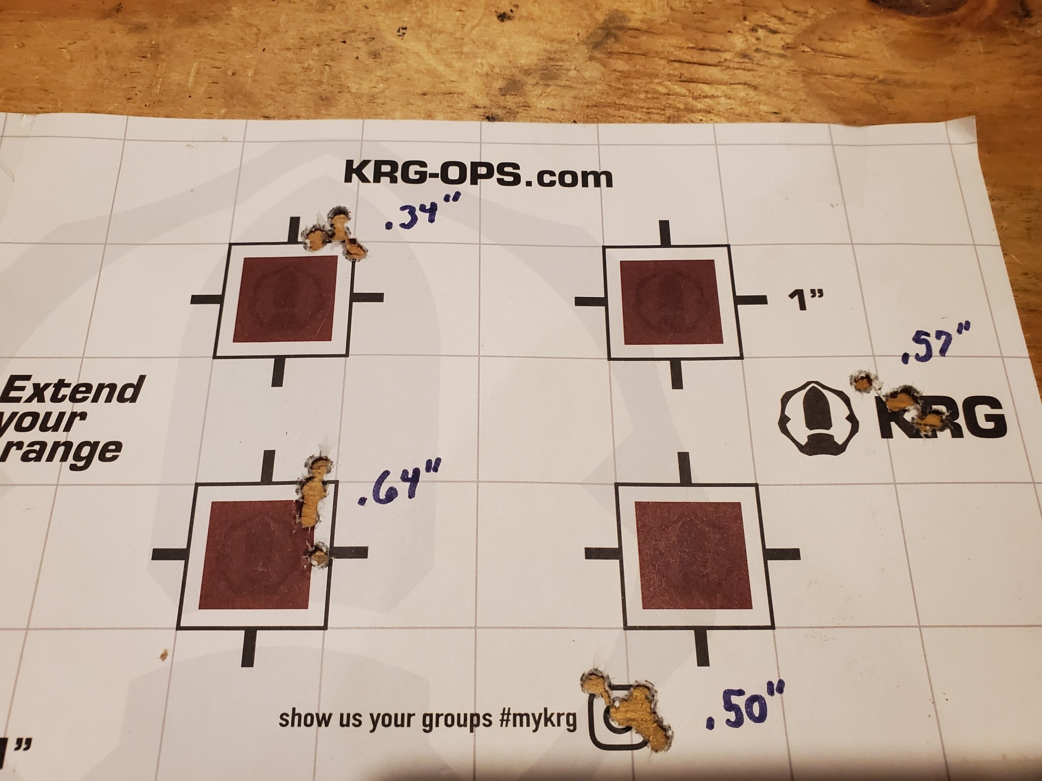

I only have about 200 rounds through it, but it's running great so far. Initially a few malfunctions, but it's breaking in. Then I ran Eley Tenex and here are the groups at 50 yards. That puts the average 5 shot group right about .5". This is also with a mil spec 9000 pound trigger. So I'll shoot again when the Larue MBT arrives.
