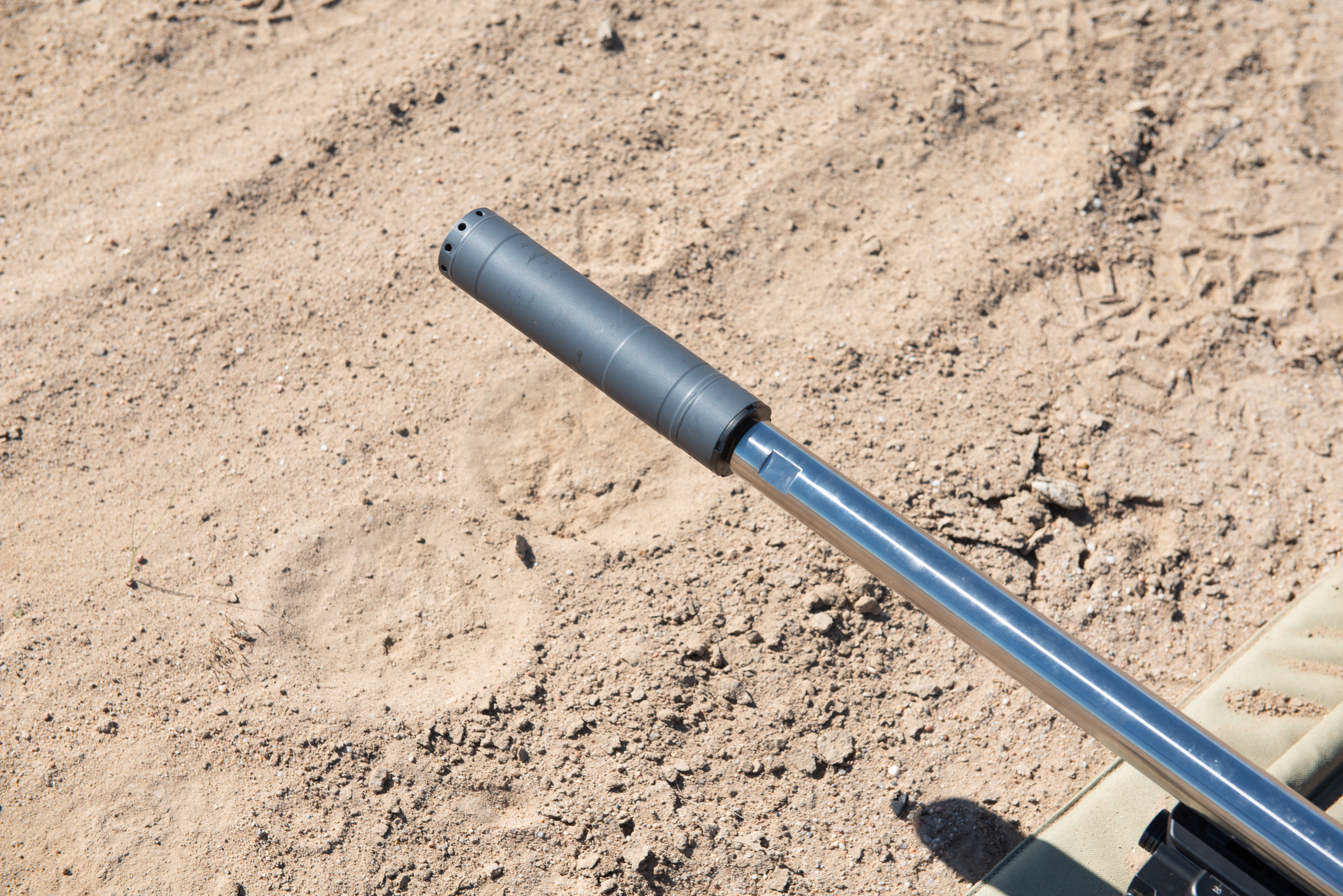

    No comparison experience between them but here are some cool shots of the R30 from Holtworks.

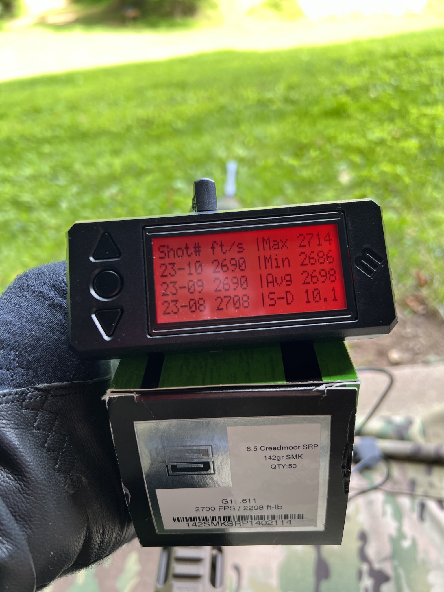

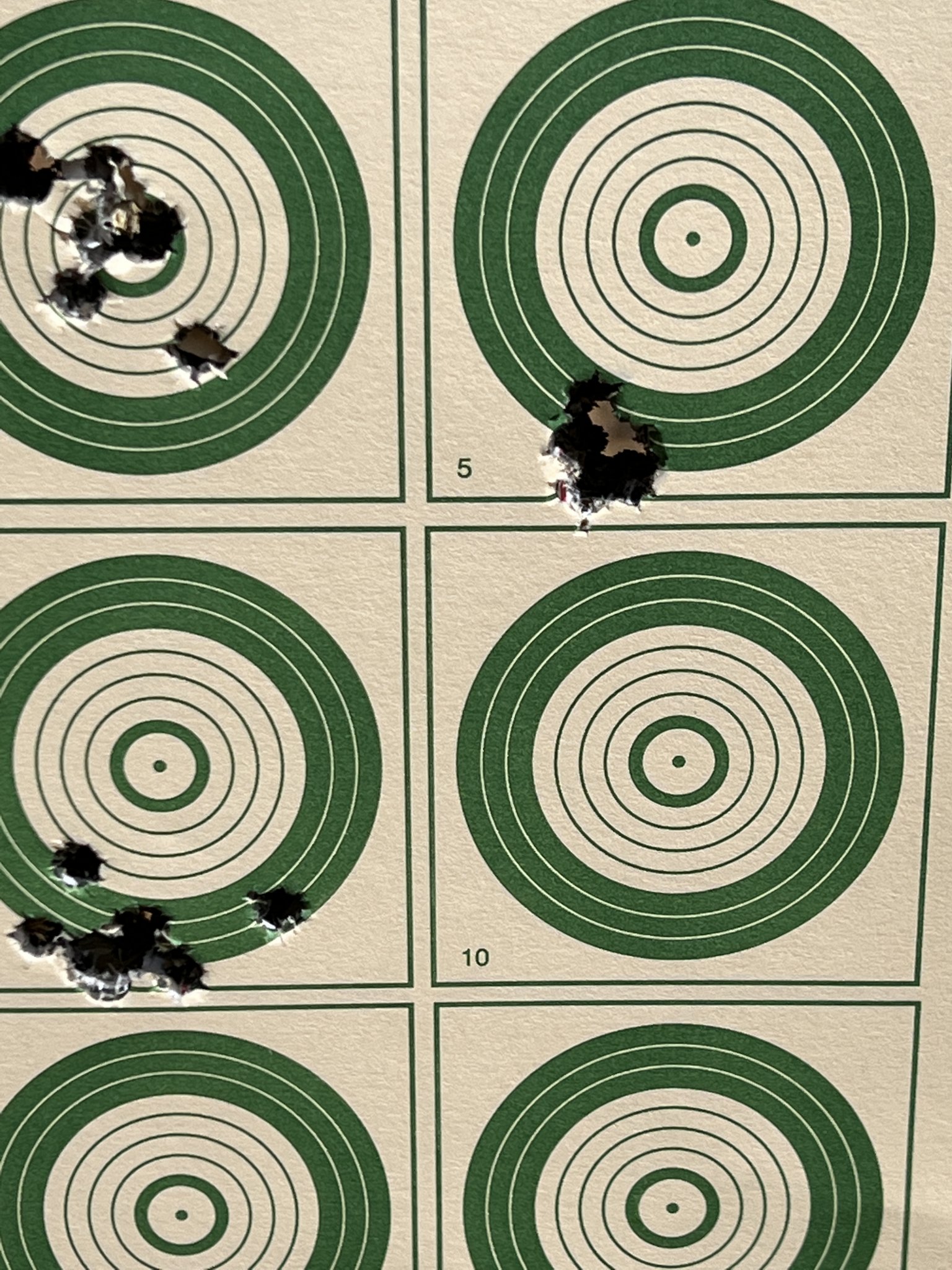

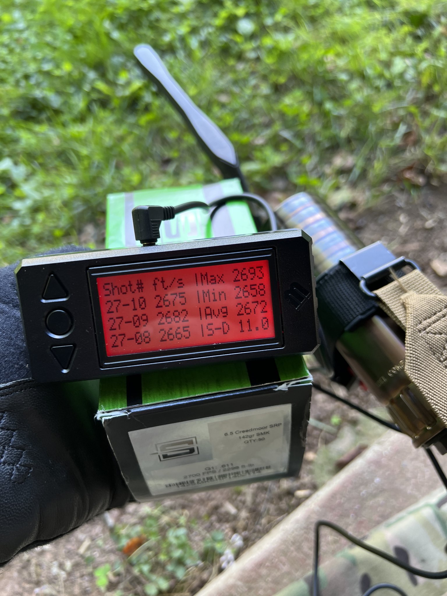

    I got my KGM R30K, Able Biscuit (30), and TBAC Ultra9 (6.5) from the Tax Man in the last few months.
    Yesterday I was able to take them out and run them through some ammo tests.
    The ES and SD (as well as velocities) we’re pretty much exactly the same. So no differences between the three suppressors…
    It was interesting to note that the POI shift on the KGM R30K was less than the TBAC. (though they all shifted the pattern versus a simple muzzle brake down by .25-.5 mil)
    I set the KGM up so that it has the top four ports open and the bottom four ports closed. Assuming that this might keep whatever slight amount of jump from happening.
    Without a doubt the thunder beast does a better job in noise suppression in general. (it’s also a 6.5 can, as opposed to the other two which are 30 caliber cans so you can take that with a grain of salt)
    I didn’t notice any statistically relevant differences between the cans…
    Target is with the TBAC 9, 10 rounds. Seems my 1:7.5 Bartlein likes 142 SMKs… the other ammo I tested not as much.
    I didn’t get a KGM picture, but the SDs with the R30K we the same as the other two.
