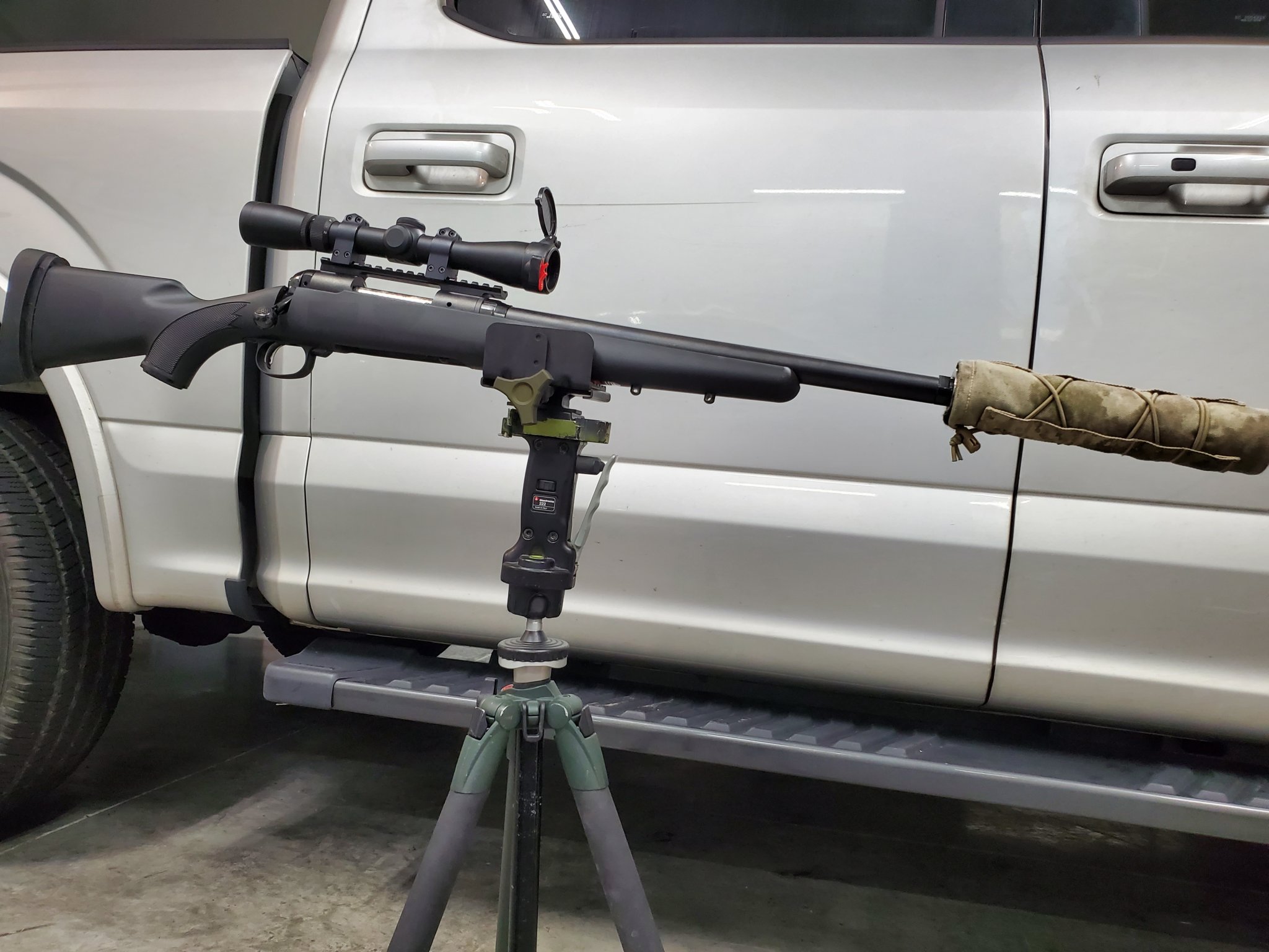

Nothing crazy fancy but built this for my 7yo
16.5 inch 6.5CM
I measured his LOP and cut 4 inches off to get it just right. Shooting factory 129 Hornady American Whitetail, hopefully see how it performs tomorrow in the field. It grouped nice on initial sight in/zero.
7ss could work great if the kiddo is ready. Brakes/suppressors/tripods can help reduce recoil. Has the young one shot anything in a smaller caliber with a brake?

I like your shorty setup! A couple of questions - what did you put on there for a buttpad? It looks like it is much larger than the stock. Is it just the original pad but moved forward 4"? Also, what is between the ball head on the tripod and the hog saddle? (the thing with the squeeze/release handle)

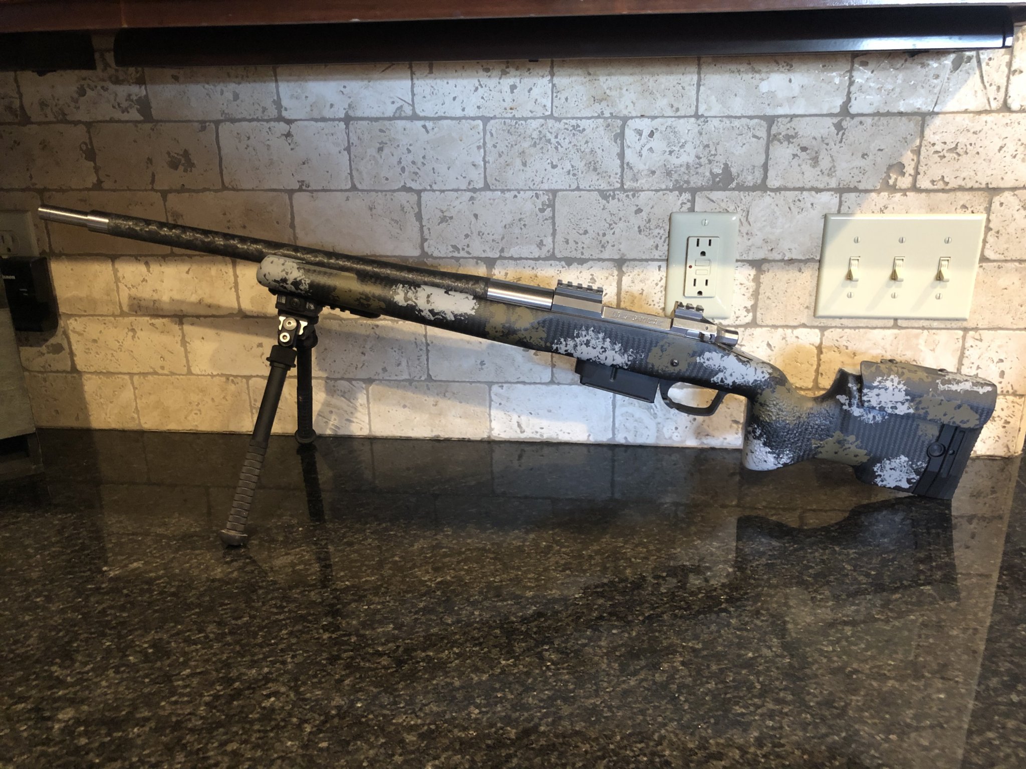

So the pic is just the parts staged for a picture before sending it all to the gunsmith, but it’ll be a Switchlug starting with an 18” 6mm Creedmoor and probably adding a 6.5 PRC barrel down the road.
