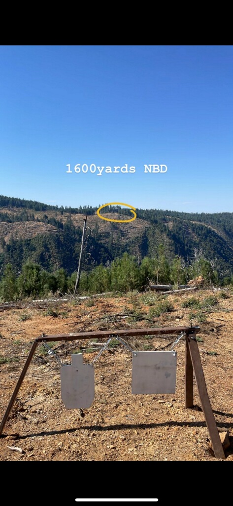

Using the sig 3k yesterday I wasn't able to get a range on a target I put out at 1670y. I had to use my onX app to try to get a halfway close range by dropping waypoints and measuring between them. Pretty disappointing the power of this rangefinder. Pretty good on trees and rocks to about 1000y. But that’s about it.

Try it with different surfaces.
I've noticed mine will bounce between a good reading and none at all if I happen to hit angled rocks. Looks like you're working with angles that may deflect rather than reflect.
Do you have them setup in a tripod?
I can get 1200+- out of my kilo 2200 by hand, then with a tripod adapter and being nice and stable it will hit all the way to 2000.

Ya I didn’t think about the reflection angle. Good call on that. Thanks.
