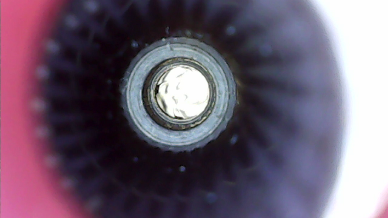

I have a Kimber 84M Light Tactical Police .308 and im wondering if anyone can tell me the purpose of the strange grooves in the chamber. It actually prints these grooves on the spent case after firing. You can feel them if you drag your finger nail across it. And they're even noticeable after resizing the brass. The rifle is a sub moa shooter all day, but these grooves in the chamber have me stumped. The only thing I could think is that they would aid extraction.

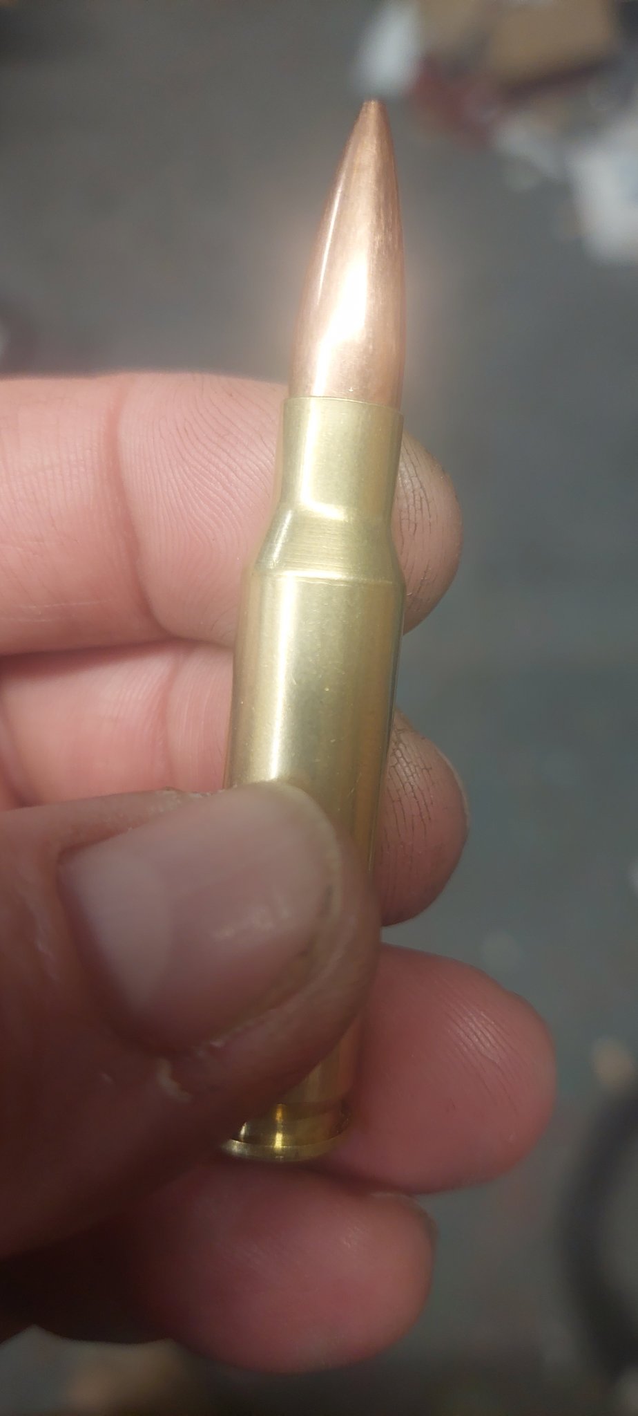

here's a picture of a reloaded case. You can definitely see the imprint of the chamber around the shoulder of the case but they run the full length. It's much easier to see before the brass has been resized and tumbled. But it looks very similar to the fluted Chambers found on an HK G3

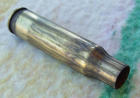

It does remind me of the brass that came out of my HK-91. The fluting in the H&K was somewhat more pronounced. It's been a long time since the H&K for me so someone else here probably has a good photo of what the H&K does to brass.

The fluting was placed in the chamber to ease extraction. At least you don't have to put up with the horrendous dents that the G3 can put in a spent case .

That is chatter from running lathe spindle rpm and feed rate too fast for the reamer. There is nothing you can do about it, it could be polished out but over polishing a chamber leads to more problems.
