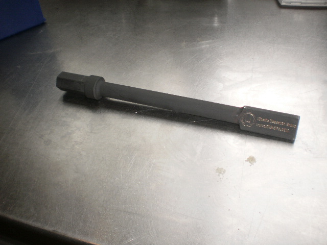

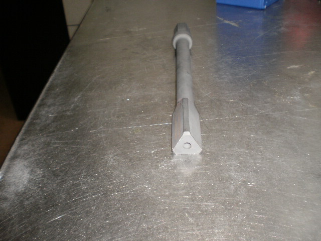

First photo show part of tool that goes in to action first. Second photo show the rear of tool over which you use a deep impact 19mm socket to lossen action from barrel.
