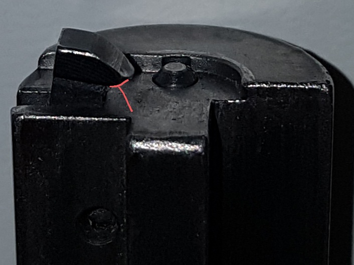

    I'd like to add that sanding the extractor corner soft from the magazine side (the side downwards that touches the case first) lets the cartridge to feed even smoother!
    It does not affect the performance of the extractor, as the hook holding the case is in the upper part of the extractor only.

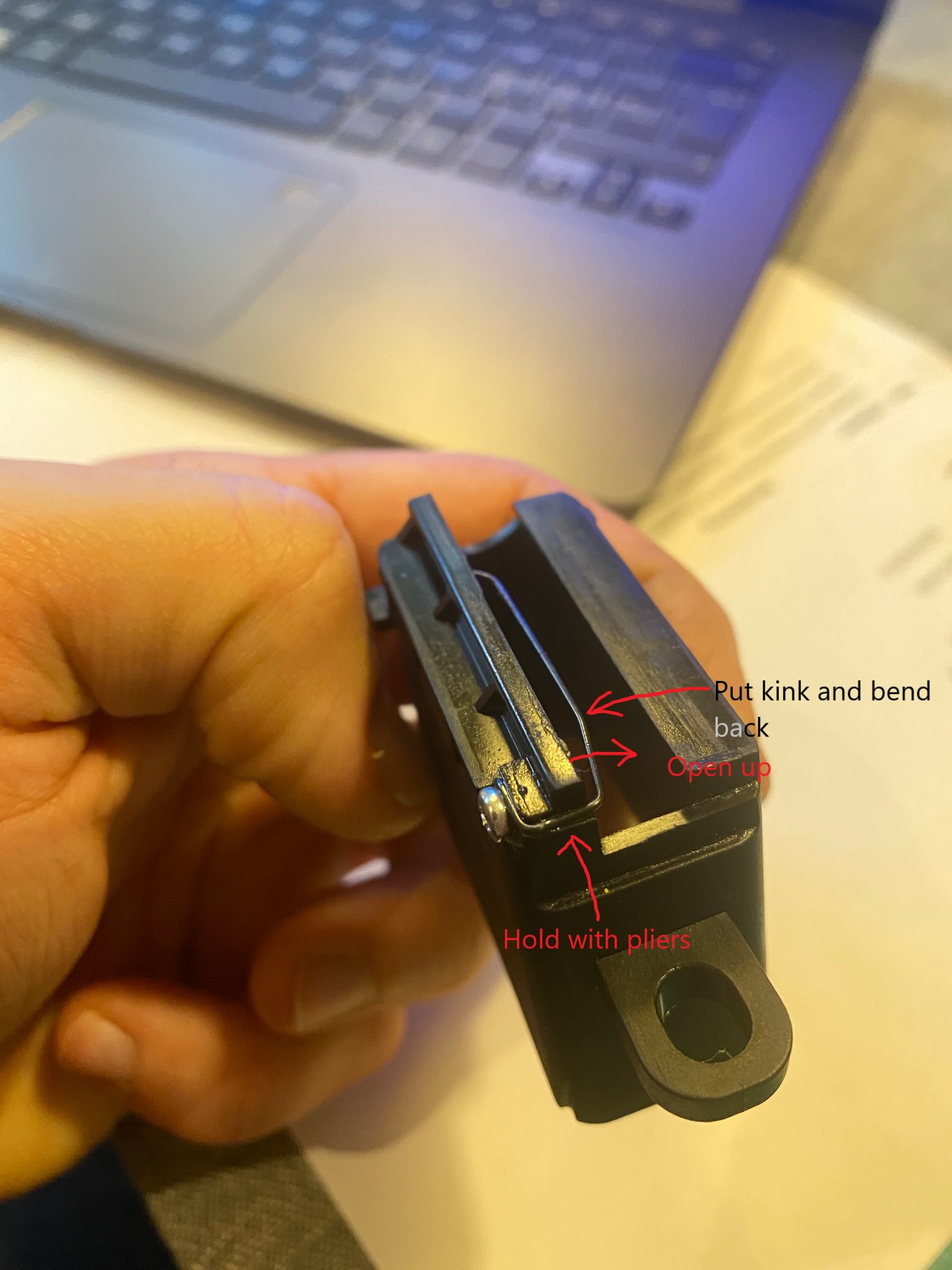

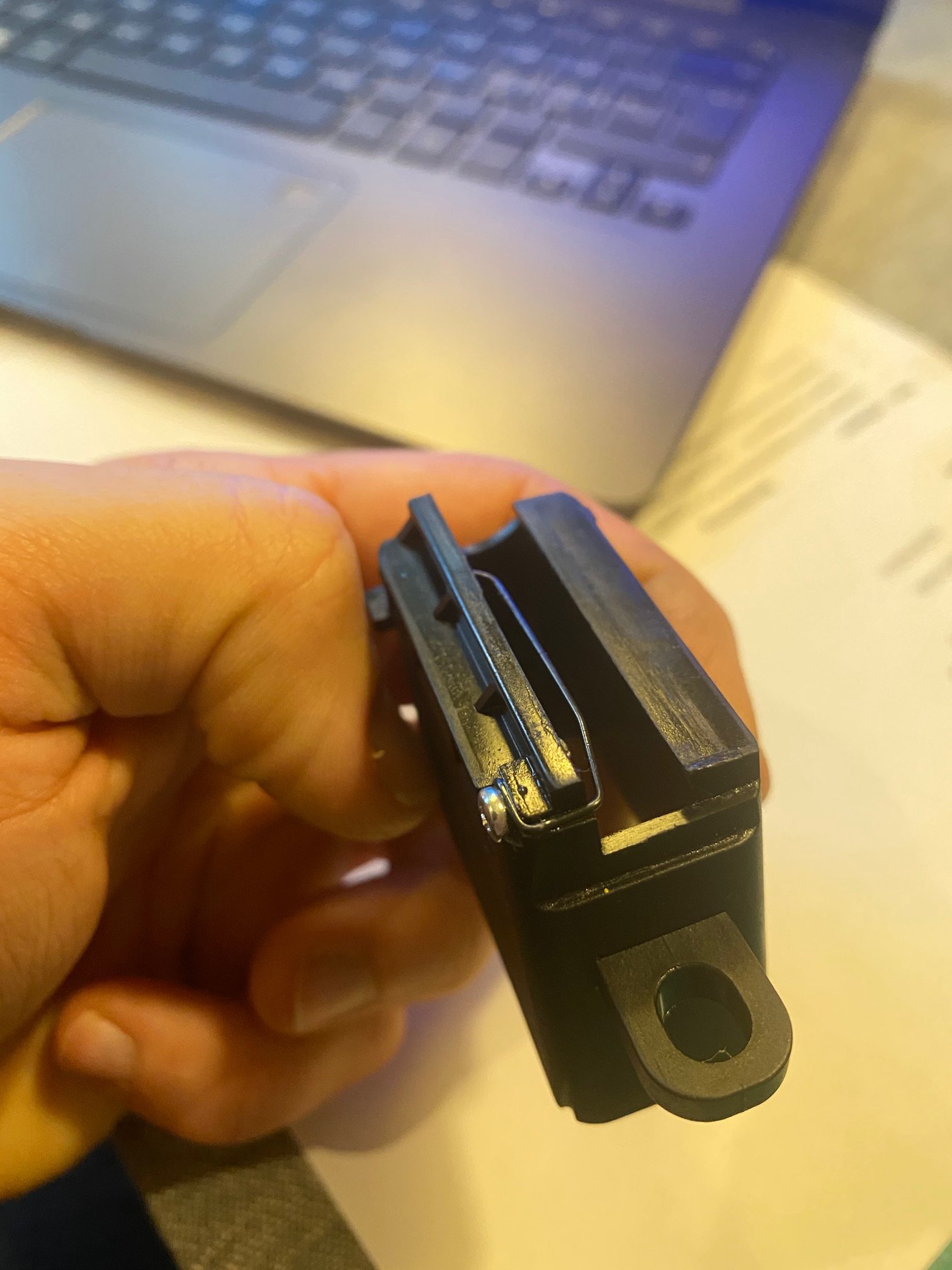

    Okay here are a couple of pics!
    The magazine well comes out with one allen bolt, then you can see how the ejector spring is fitted.
    Just taking the spring out, holding on with a pair of needle nose pliers and opening the spring up a bit, then put a kink in it to get it to turn back. Put it back, screw in the bolt and job done.

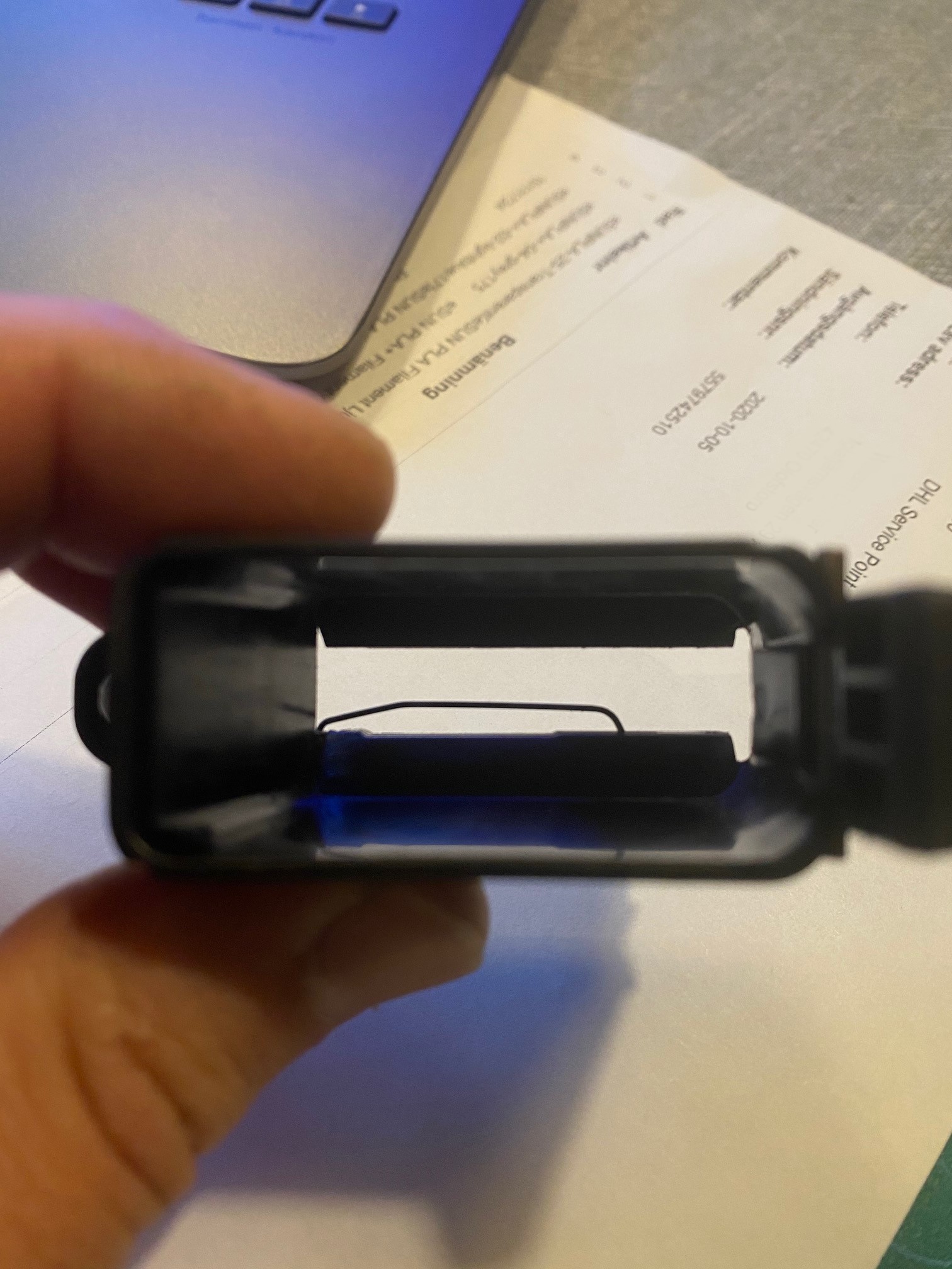

    Looking down the well this is what my spring looks like!
