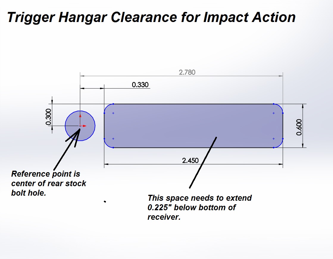

Anyone else drop an Impact into a KMW with IMB? Looks like I'm going to need to remove some material from the front and back of the trigger cutout to make room for the trigger hanger. I know guys have done this with some chassis, but wanted to see if anyone else had experience with this before I dremel away on my favorite stock.
Here is a diagram that could be used to insure your trigger hanger clears.
All new gen IMBs and DBMs will be cleared for the Impact actions. In the mean time, see below:
