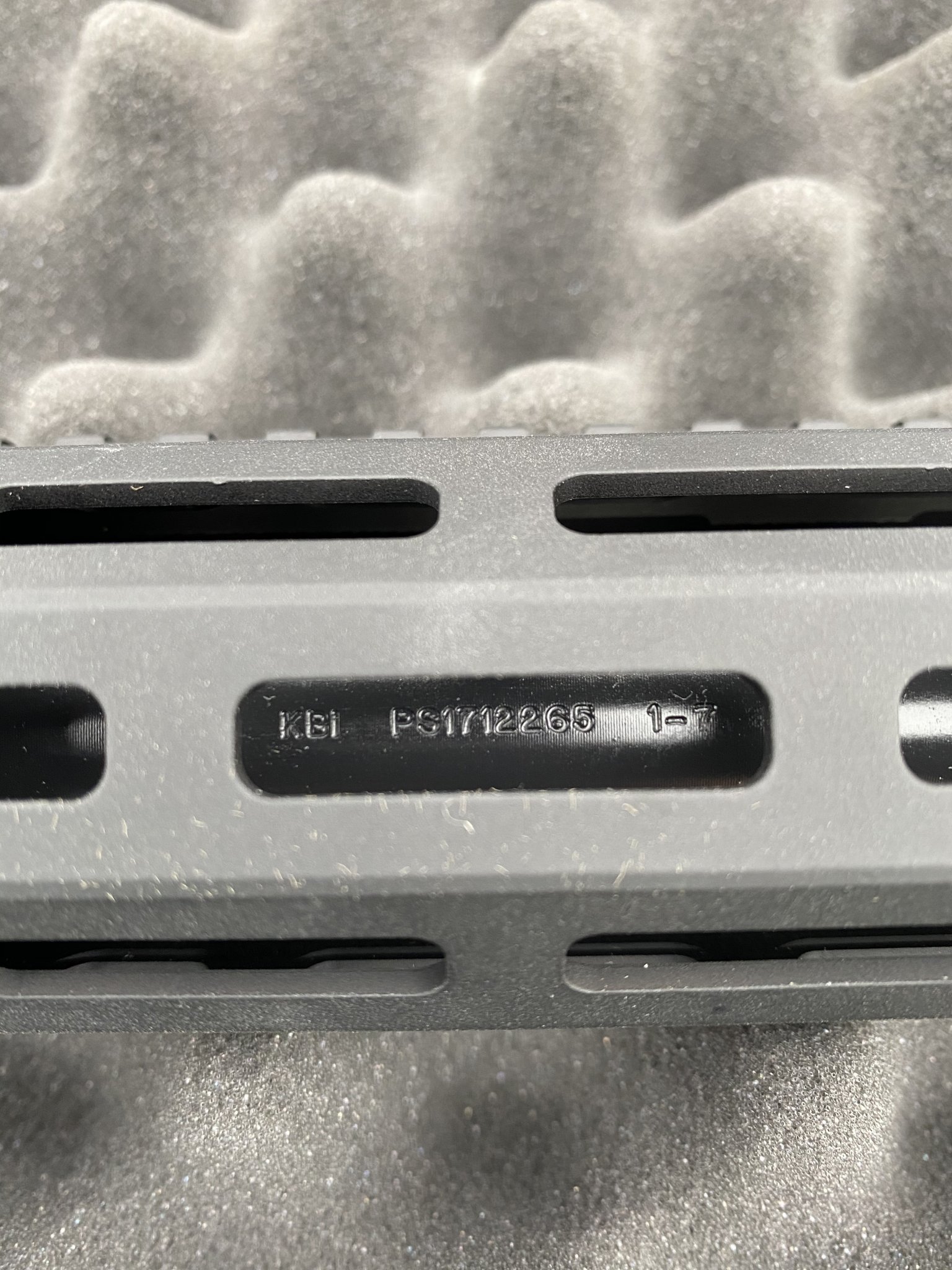

I own a mod 2 and the barrel is stamped Krieger
EDIT: it is stamped KBI
The Kreiger Barrels are stamped KBI if not mistaken, at least the ones I’ve seen on the Mod 2 LPR.
According to Jack they don’t advertise them as Krieger so they have the option of making barrels in house, but as of that post all of the barrels to date used Krieger blanks.

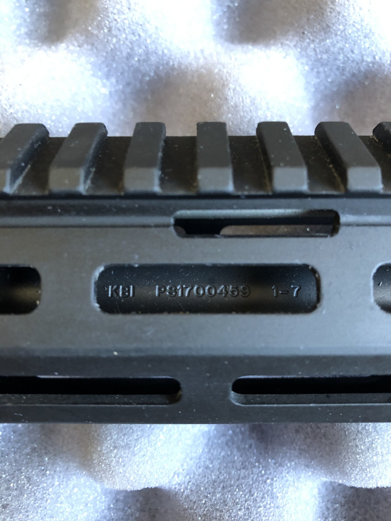

Not all Mod2 LPRs have Krieger barrels.
As noted, the Mod2s with a Krieger-sourced barrel are stamped “KBI”. The ones with in-house KAC cut-rifled barrels do not have this marking.
I’ve had both versions of the Mod2 LPR as well as a Mod1 LPR.
Reactions: Forgetful Coyote
Mod2 with a Krieger “KBI” barrel

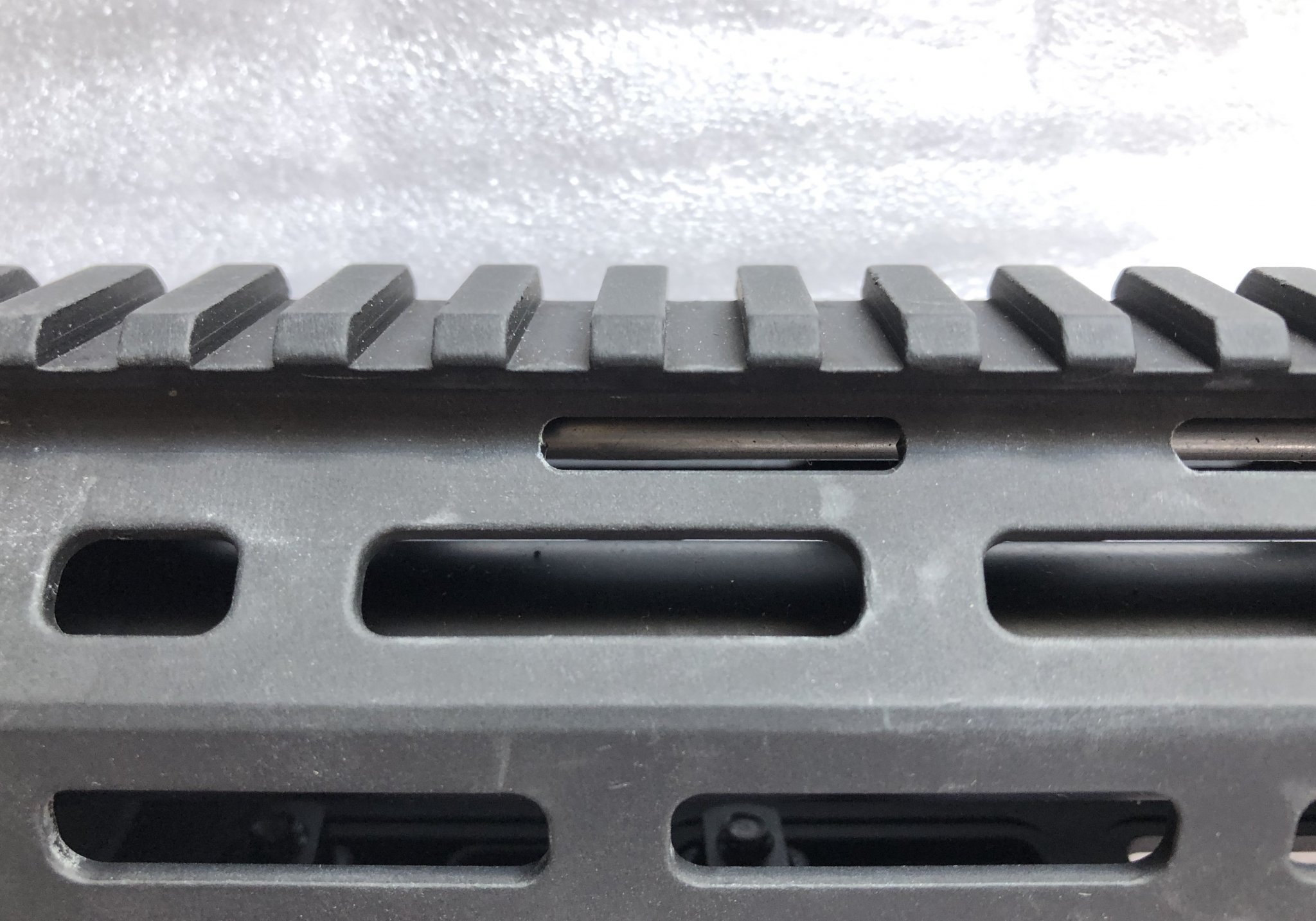

Same location on another Mod2 LPR with KAC-sourced barrel -

If the KBI engrave was not existent on the LPR it's because the profile was changed to the 2.2 after the fact and just so happened to remove some of the engraving. There are no KAC in house cut rifled LPR barrels in existence. Yet. This is 100% fact.

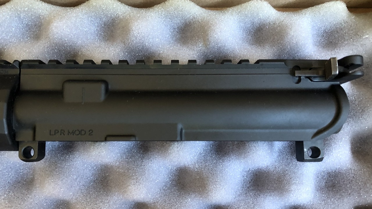

Interesting. Thanks for the feedback.
Is there any correlation to the profile change for the Mod2 and the way the upper receiver is marked?
I also noticed that my “KBI” barreled Mod2 had a stamped/engraved “LPR MOD2” text on the side of the receiver (similar time the Knight’s crest on the top) whereas my unmarked Mod2 had the more typically seen laser marked “LPR MOD2” text.
ETA: What is the difference between the original Mod2 LPR barrel profile and the 2.2?

The receiver I couldn't give you an honest answer without asking our people on that side of the time clock. But the Mod2 barrel, the original/2.2 difference is a weight reduction on the rear profile. Went from straight taper to g/b shoulder to a bit lighter in the back end. That was a pretty early revision on the Mod2 bbl.

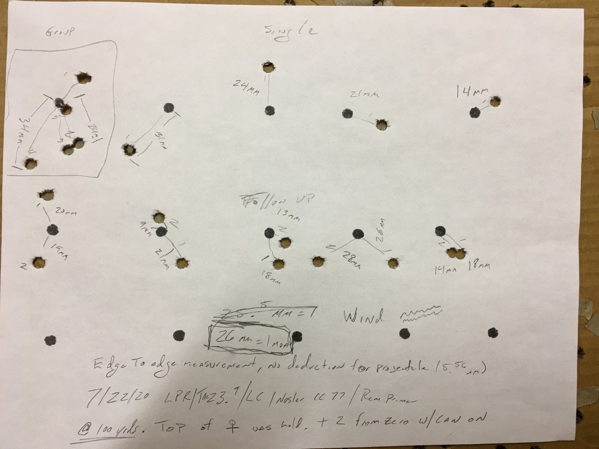

Meaningless data for you:
LPR Mod 1 (but I doubt the performance standard is much different if at all)
Group at top left I was playing with hand pressure on the grip.
Goal was to hit the center of each 1/4 MOA dot, so distance to the center of the dot is what I am measuring.
For the sticklers, 26.42 mm = 1 MOA

I used your 10 shots shown within the red rectangle pictured on your target below to form a 10-shot composite group using On Target TDS. Your 10-shot composite group has an extreme spread of 1.338" and a mean radius of 0.52"
For comparison, the graphic below shows the level of precision that I obtained with various hand-loads using the Nosler 77 grain CC (since you were shooting the 77 grain Nosler on your above target), when fired from my precision AR-15 builds.
