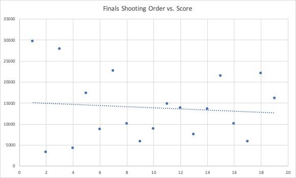

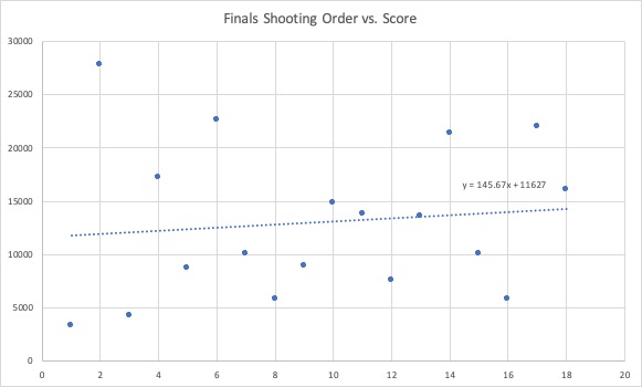

The thing that always surprises me is that at least in the finals where shooters can largely read the wind, the shooting order doesn't have a huge effect on outcome. Corrected vs shooting order it is enough to move you from 4th to 3rd but it is still very tight. Applying that kind of math in a match is something I'd have reservations on though. Using math that I can't get most people to understand has not worked out well in the past.

To me, that shows a direct correlation to starting time to placing
Maybe best that you don't do statistics for a living then. This data is pretty close to random and the elimination of a single data point changes the trend line the other way. Any time you see a trend line where almost none of the data points are near the line, the trend line is bullshit.
-Alex
-Alex
It may be possible to bring other factors into the analysis, such as the decisions each shooter was acting on, like drop and wind, assuming they would give you honest data (if they documented it +/- remembered it accurately). Analysis of uncertainty is difficult when you have solid controls on a limited number of variables. When I look at data like the above, I see lots of noise, and I'd expect that, given what is known and what may be unknown.

When I look at shooting order vs score, the result is almost always random. Some matches with dramatic shifts in weather show differences but it is often most surprising in how little of a difference it makes. It is in our nature to try to tease truth out of facts but the results are intrinsically subjective.

I am starting to lean towards what Alex is saying ,at first I was more inclined to see a advantage early in the day but I had a really early shooting place and really good winds I thought , but never the less were switchy as hell. I basically missed smaller but still missed , I saw the same type of missing patterns in the mid day , nothing had changed so in this particular case it seems that early morning verses mid day are not always a advantage just from my observations at the KO1M . I suspect terrain has a influence on the statistics because we had targets down in a hole with huge foot hills surrounding valley seemingly blocking the wind down on the floor of the valley but swirling never the less .you would see dust move right but you had to dial 2-3 MOA right to hit . Weird stuff down on the floor of the valley but it stayed the same all day for the most part with occasional lulls but even then the hits did not seem to increase when I was watching. The misses were still small mid day for the most part.

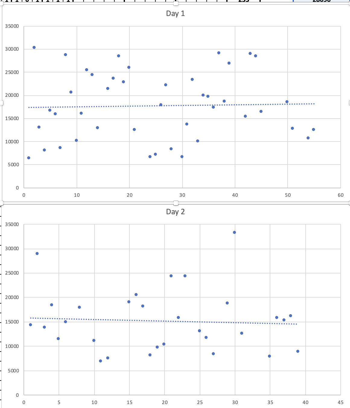

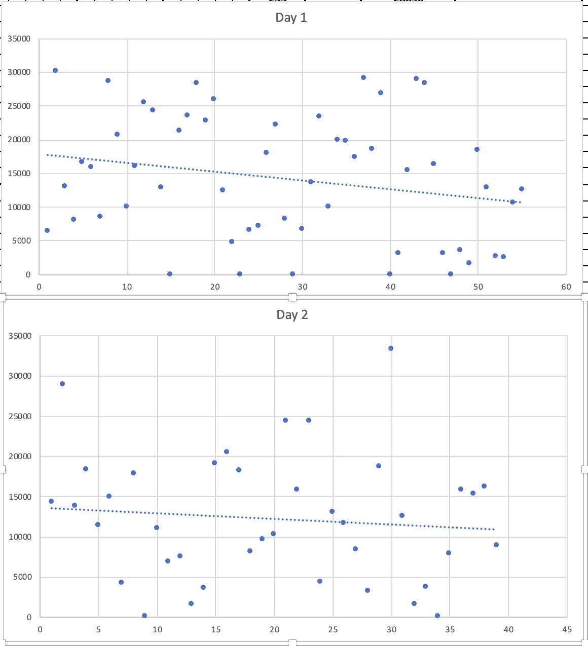

So here are the prelim charts done the same way. Again at a glance there is mostly just random data. Ask a bunch of people to add a trend line on their own and you'd get different answers from them all. Asking a machine to do it and you get one that has negative slope both days.
What is rather deceptive about this is that the trends are dominated by people that really ate it. They weren't missing small as Tim puts it. They only connected a few times. If we assume that these people all had something fundamentally wrong going on (shooting a 308, no spotter, weren't using a ballistics solver...) and drop scores bellow 5000 then we get this:

The trend lines become flat again. There is an average difference of about 2500 from day to day but Since I had the highest rank member of each team shoot Saturday, it is potentially explainable. The best scores (which are the only ones that actually matter) also happen through the day. If I was going to put a reason on that, it would be because the best shooters can deal with the conditions as they change. If that logic is true then bad conditions probably make them stand out further from the pack.
Don't get me wrong, there are matches in which the wind picks up in a big way halfway through and some people get pretty screwed. There absolutely can be disadvantages based upon shooting order. It isn't usually the case though. I run this chart across most large matches that I run and even when I expect to see a trend based upon what I've seen the wind doing across the day, it hardly every shines through.
Just visiting with Dave some, he said most were using just spin drift on Saturday even in the afternoon and he was the second shooter on Sunday and was using 9 minutes of wind to impact. So yes every day is a new day it always sucks to wake up in the morning and winds are already blowing good but I will take full value versus light winds switching left - right at your 12 or 6.
