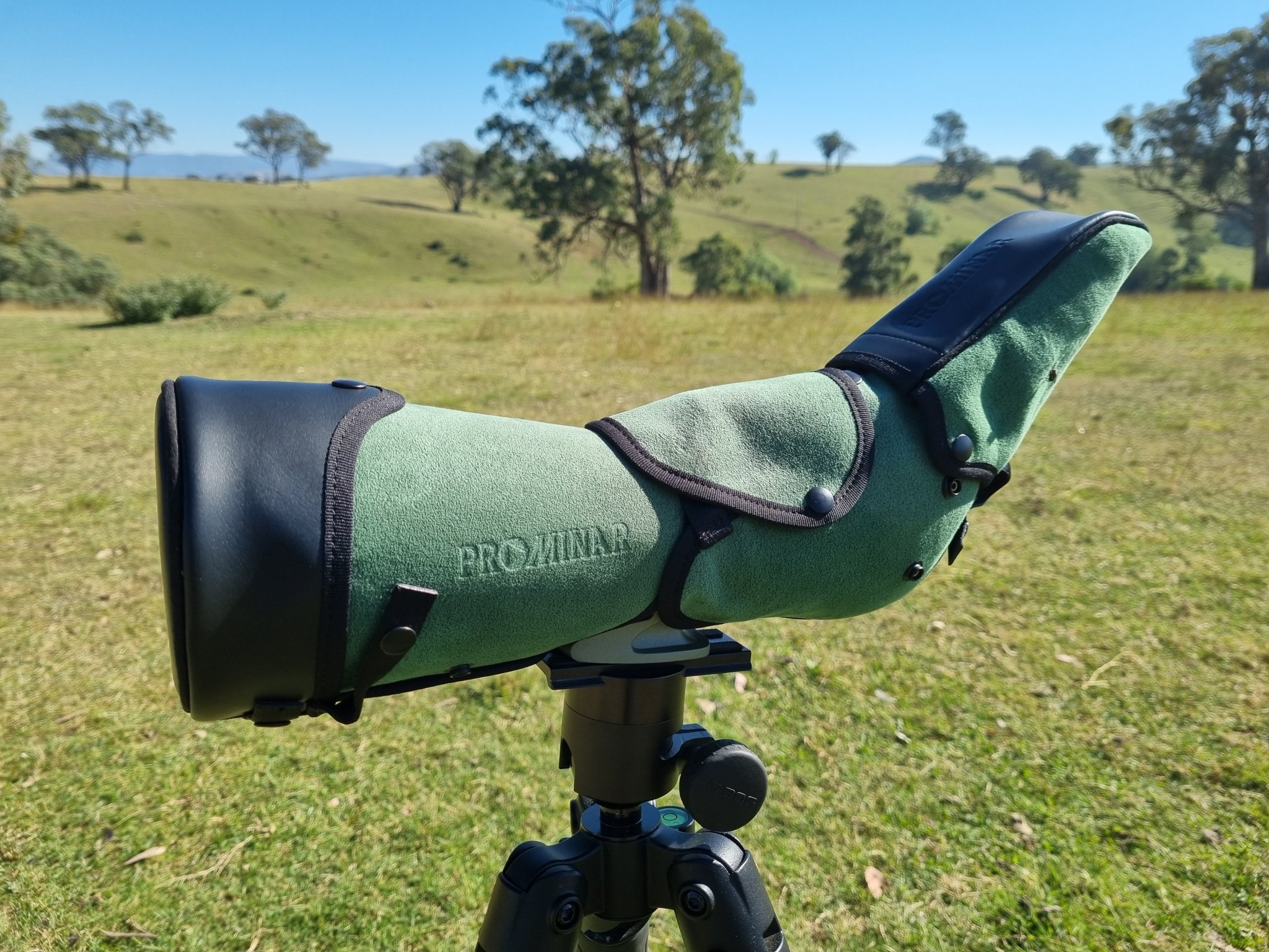

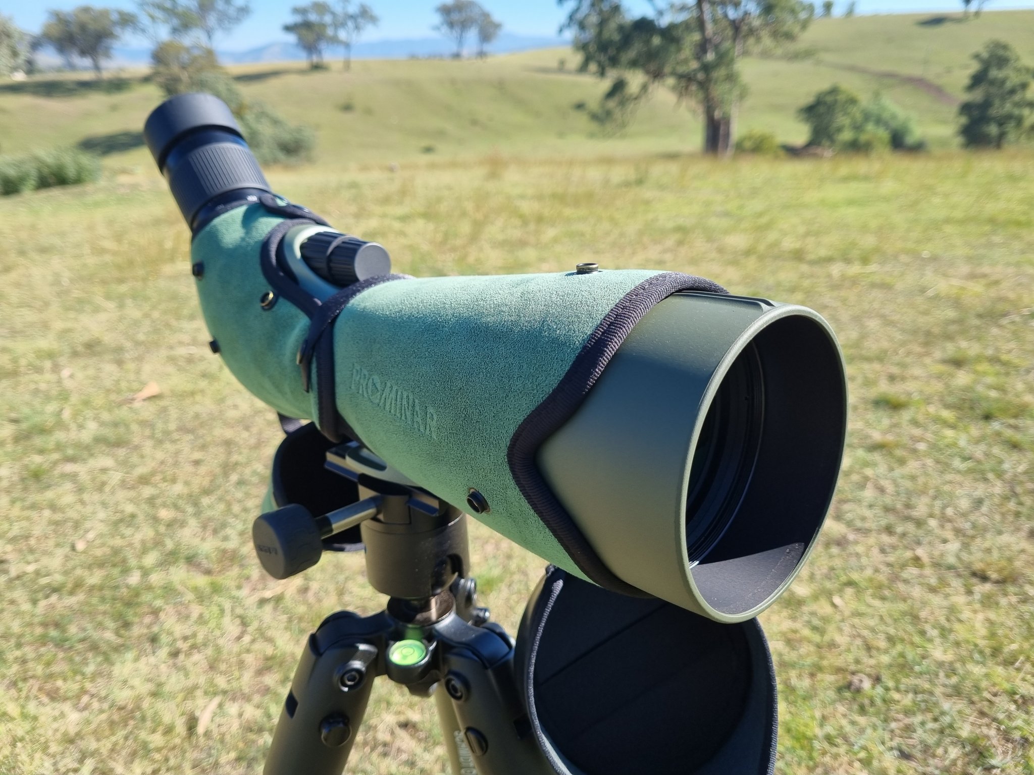

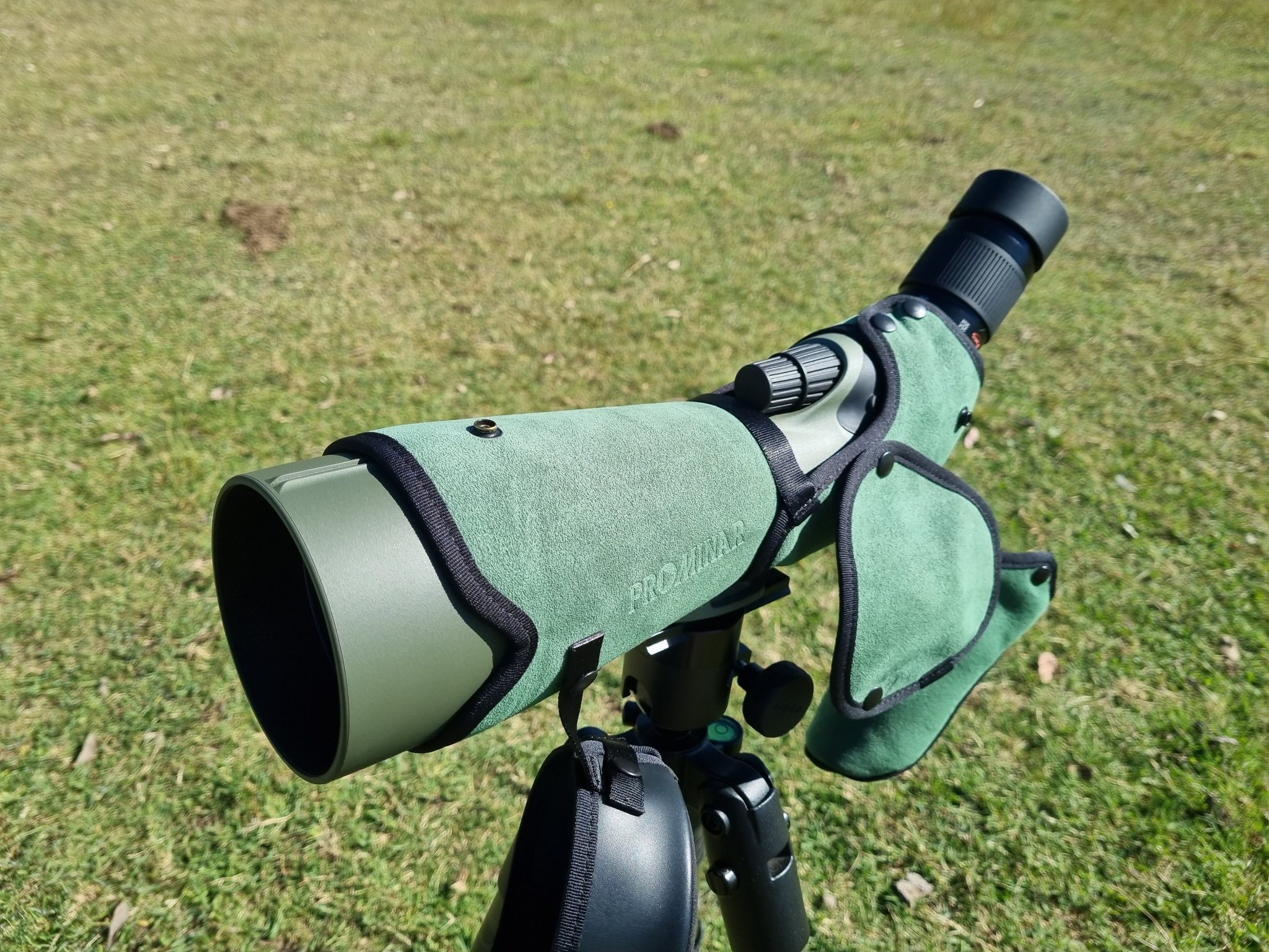

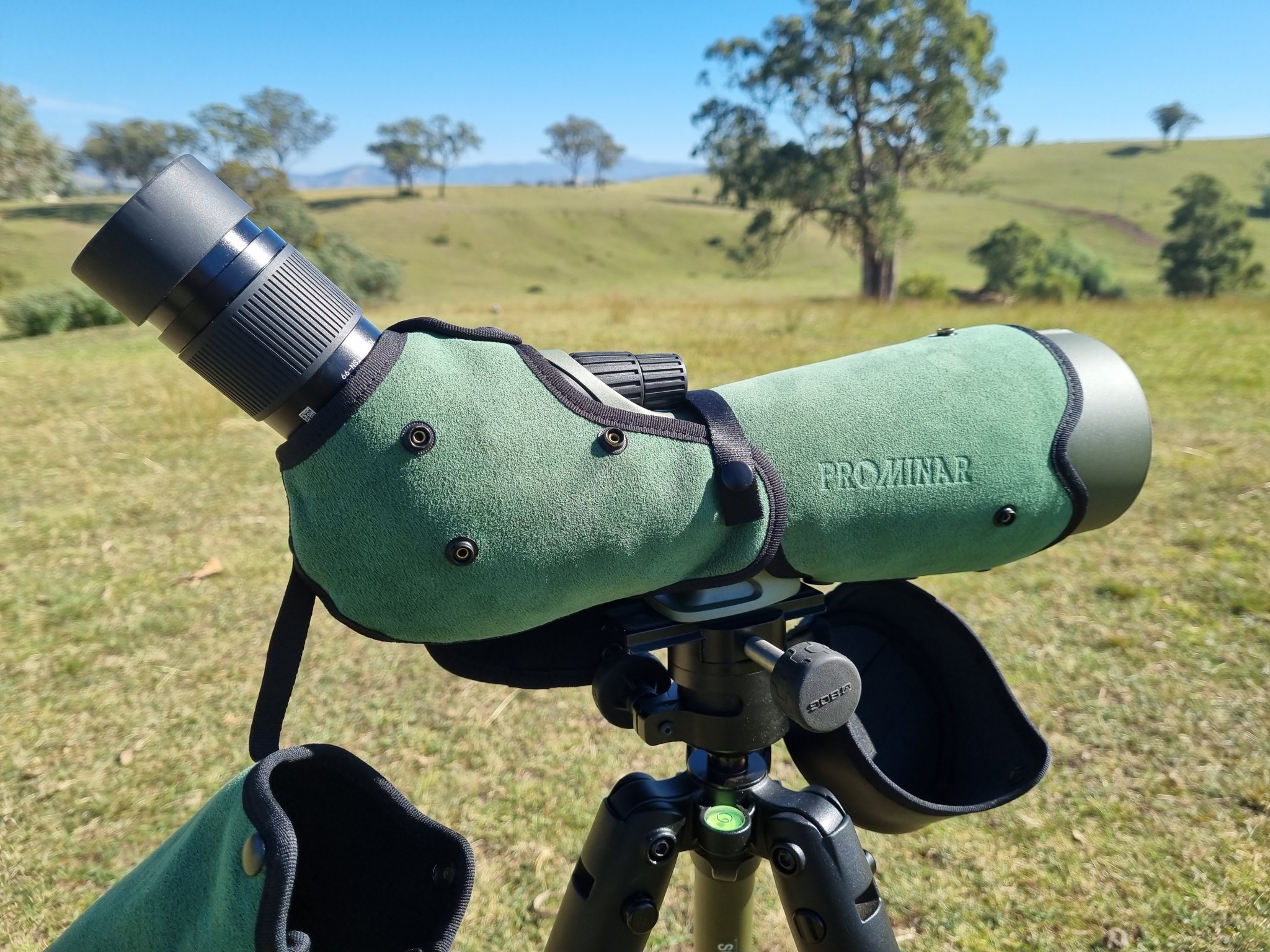

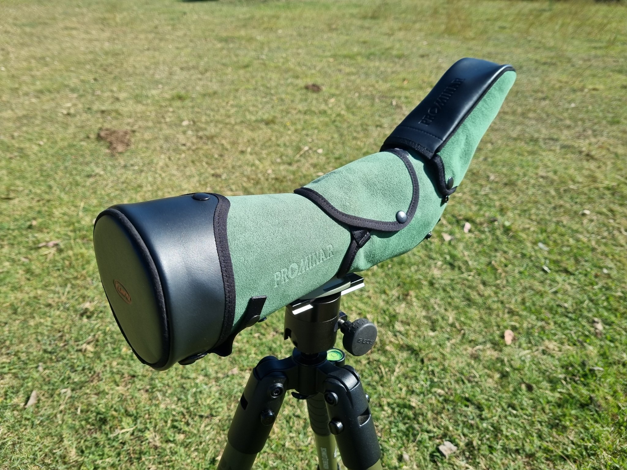

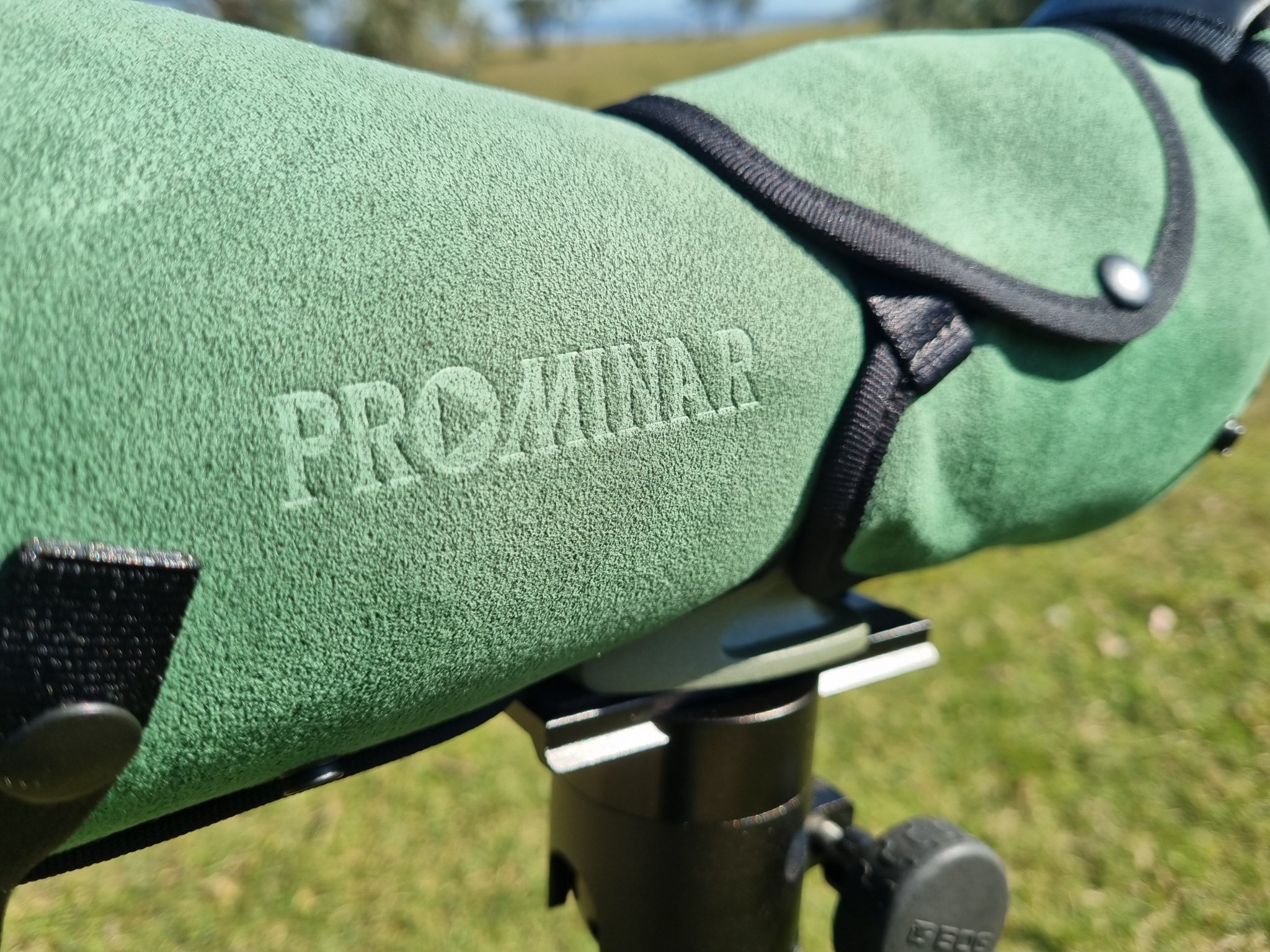

    TSN88A with Kowa protective cover..

    My Kowa 883 wears the fitted neoprene cover over the magnesium body.
