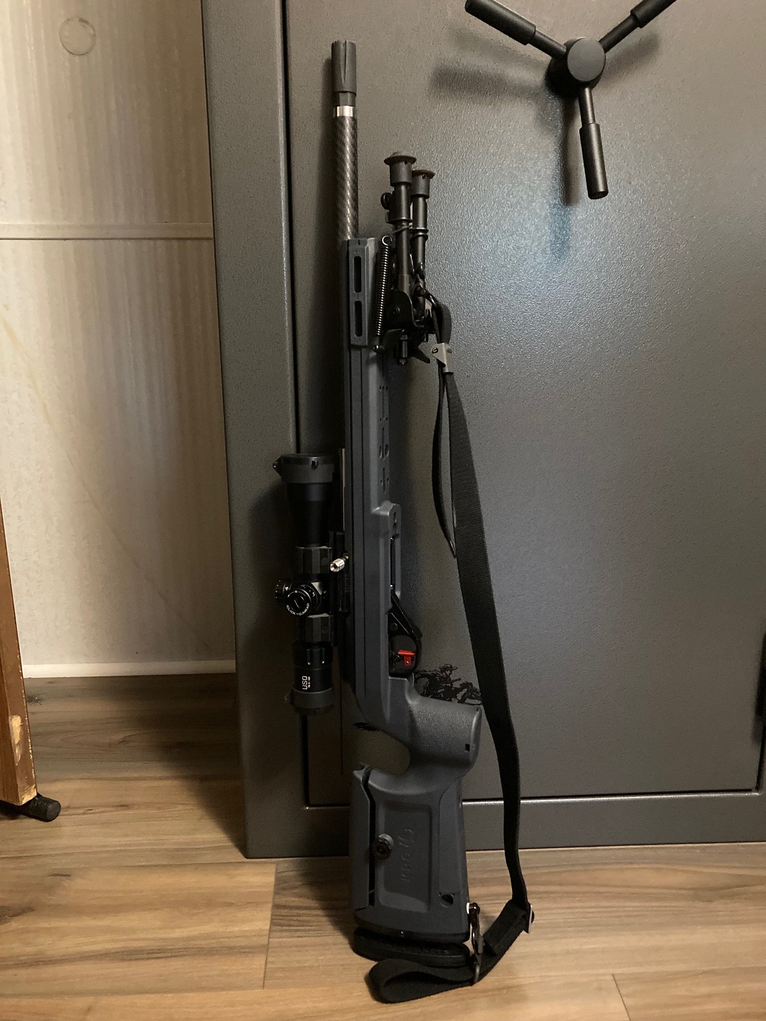

My KRG Bravo 10/22 chassis recently arrived. Rifle is an OEM Ruger receiver, KSA .920" barrel and a Timney CE trigger.
Putting the chassis together, I had to swap around the A and B spacers, but it was otherwise painless.
My question is: At the manufacturer's recommended action screw torque of 20 in/lbs, the barrel has a lot of side-to-side play. Enough that with just a little thumb pressure, it will contact the aluminum.
Is this normal? All barrels will flex a bit, but I have other chassis that don't have anywhere near as much slop. The only difference is that they all specify more like 45-65 in/lbs on the action screws. I may be fretting over nothing, but wanted to see if anyone else has noticed this.

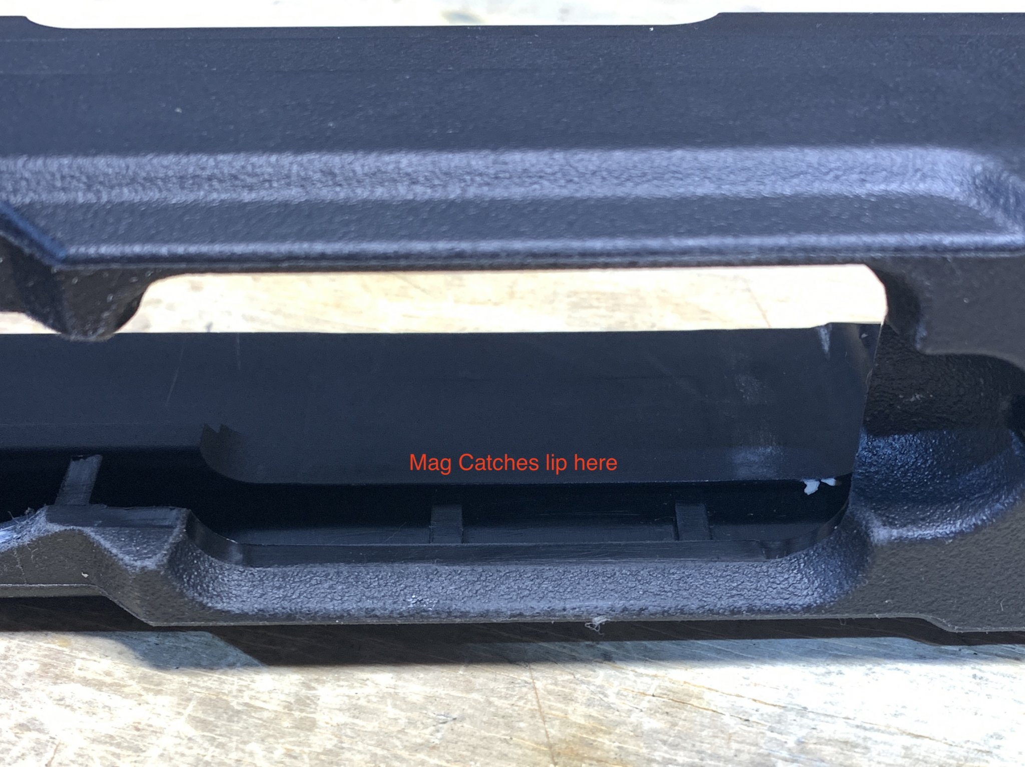

The other issue I had was I noticed that I was having issues getting mags to insert now and then, which seemed odd cause I've never had that issue before. At first I suspected I was putting them in tipped forward/backwards cause Ruger's can be a bit touch on that, but when I started looking at the chassis magwell I immediately saw the issue. So there's a 3/8" thick gap between the plastic overstock and the metal chassis where the mag inserts, and if you have the mag tipped side to side even a bit, the flat top edge of the Ruger mag will catch on the lip of the metal chassis. I ended up epoxying in a couple pieces of 0.09" kydex to take up the space and I haven't had a mag not insert cleanly since. Here again it seems like having a big gap with a sharp ledge for a mag to catch on is a big design miss.

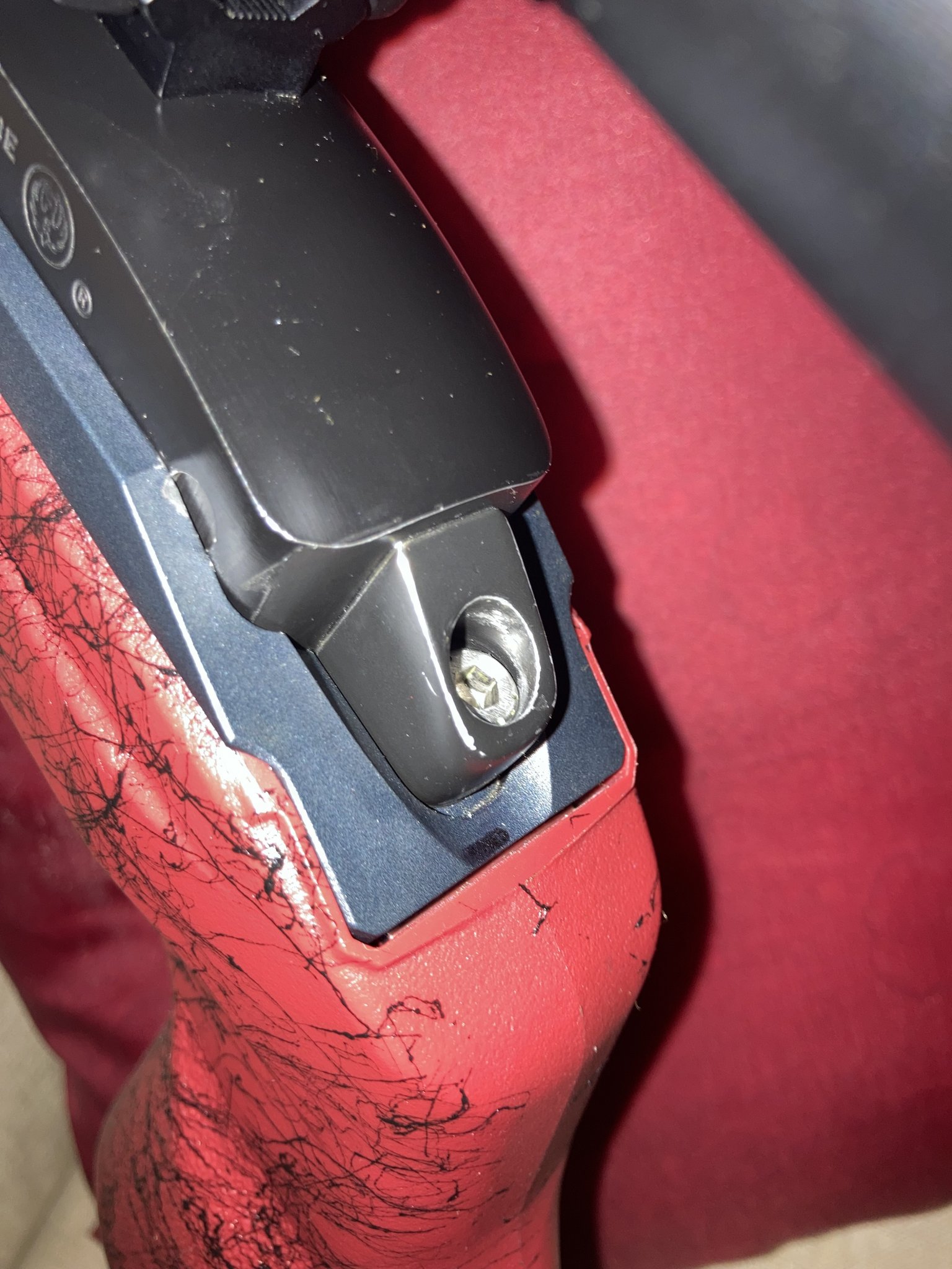

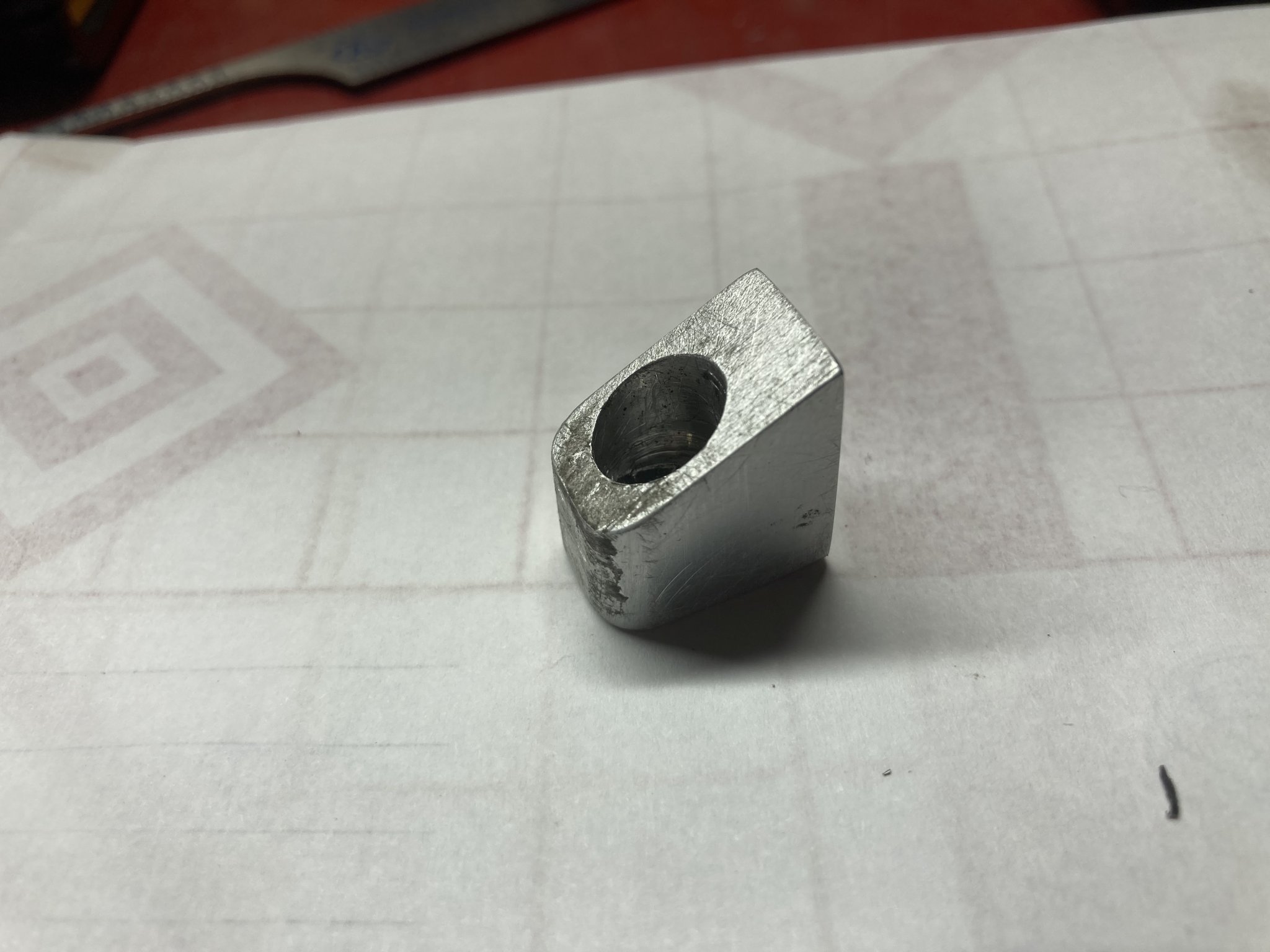

I made my own rear hold down for the stock Ruger receiver. Had a chunk of aluminum laying around. Drilled a hole in the back of the receiver, drilled and tapped the aluminum block, drilled and counterbored the block for the screw into the stock. All done with hand tools
I’ll gladly post some pics when I get time to disassemble. It’s just a hole countersunk to accommodate a small machine screw that threads into the aluminum block.
